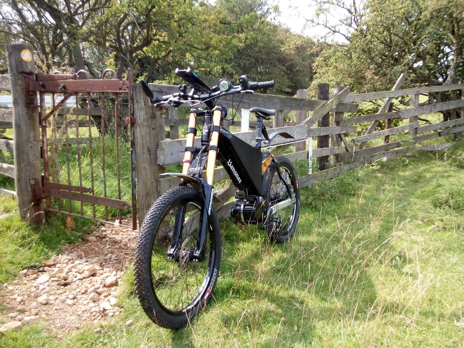

I have just priced a 60v 3000w mid drive kit with batteries and inc delivery it would come to £1250 ish using lipos. with 16ah . I picked up an old banshee scream ( real heavy duty frame ) and smash through the countryside Np. I am on building a light wight specialized at the moment using BB mount Cyclone motor it does not come lower than the chain ring , not like the bafang + I have never hit a rock with my motor yet and have had 6 Years of trying .

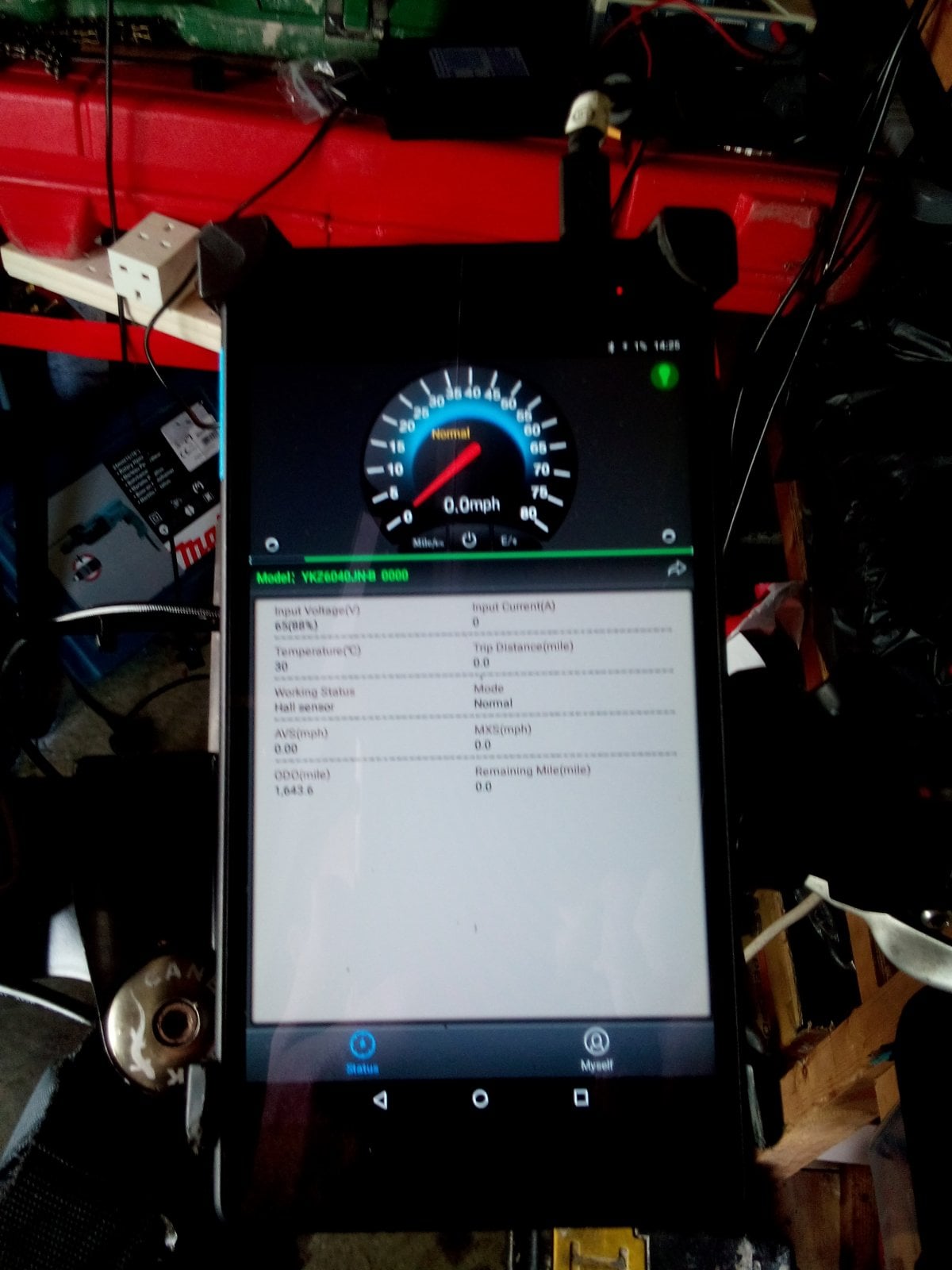

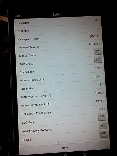

using my Bluetooth controller I restrict the motor to 250w and limit it to 15 mph in public.

I have knocked up a battery box for a specialized you could get 20ah at 34v in it. I stuck on youtube it didn't realy detract from the

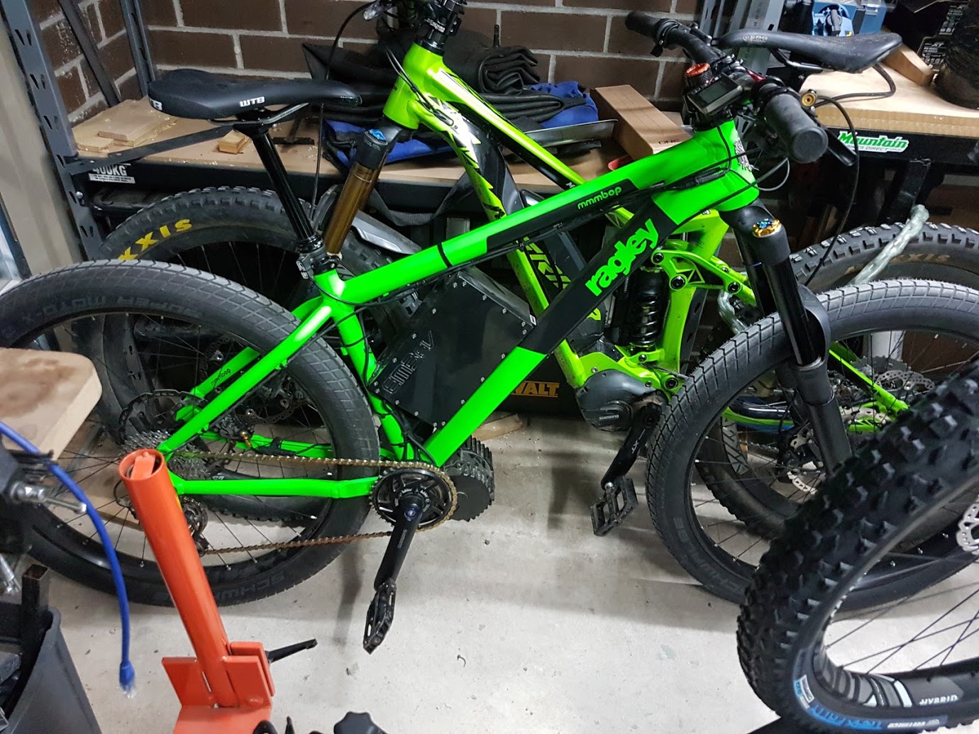

I've got a Bafang BBSHD on a Ragley Mmmbop. The fit is great (much better than most frames I've tried) because of the rear stay. The chainline is a little out though but if you're gentle when changing up it's fine.
It's a while from your post, but is your bbshd 68-73mm model?
What do you think, will the 42T chainring fit Ragley frame.
I am looking for a hardtail frame for bbshd. I allready have motor and chainring. Ragley seems interesting.
