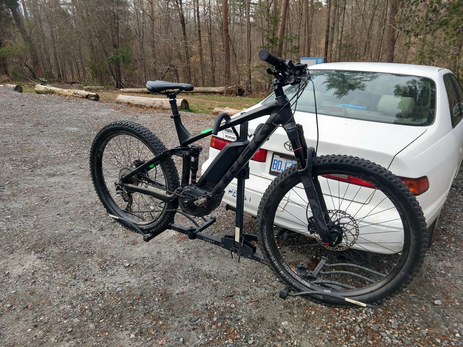

As long at the rack supports the weight of the bikes and accommodates the width of the tires it should be fine. One made for a 2" receiver will probably be more stable, but I wager you'll still see the bikes moving around when you're on the highway and wonder if it's going to fall off, but it won't. I have a cheap rack in a 1 1/4" receiver on a Toyota Camry and worry all the time, but I stepped on the rack and it had no problem supporting my 240 lbs, so 45-100 lbs of bikes should be no problem.

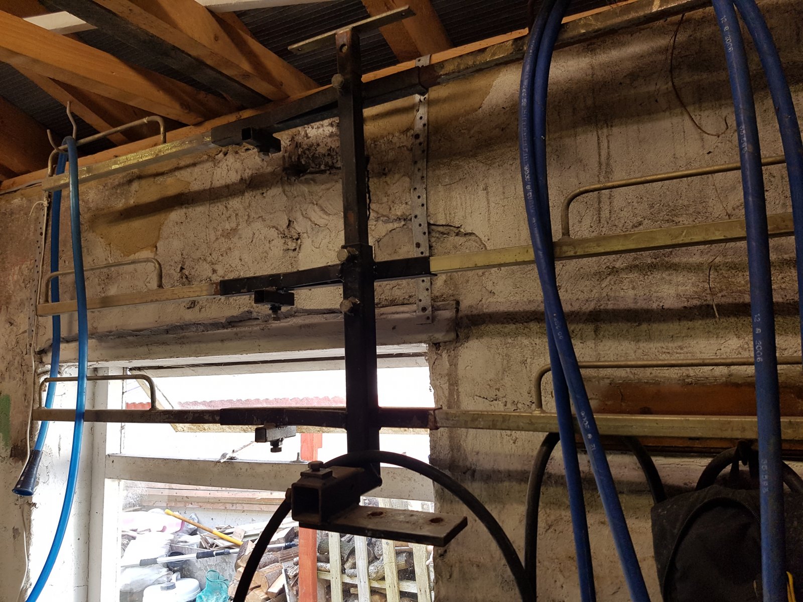

I've had this hanging up in my garage for quite a while now.
Used to carry 3x bike's around the borders back in the day.
It's totally adjustable for wheelbase, can be a 2 or 3 bike rack.
Fixes to standard 2 bolt hitch and uses vertical bar with inverted loop to pull bike down.
