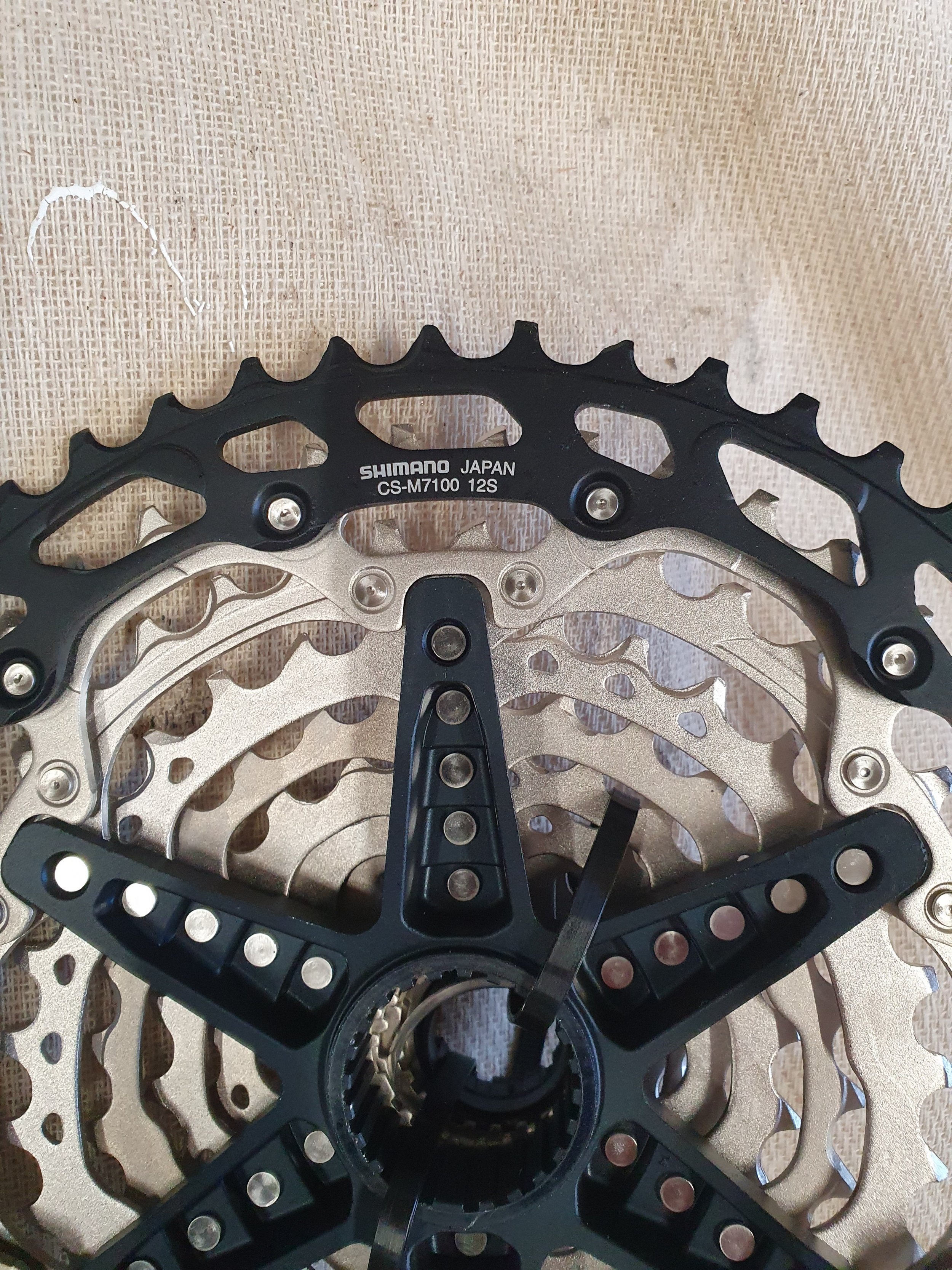

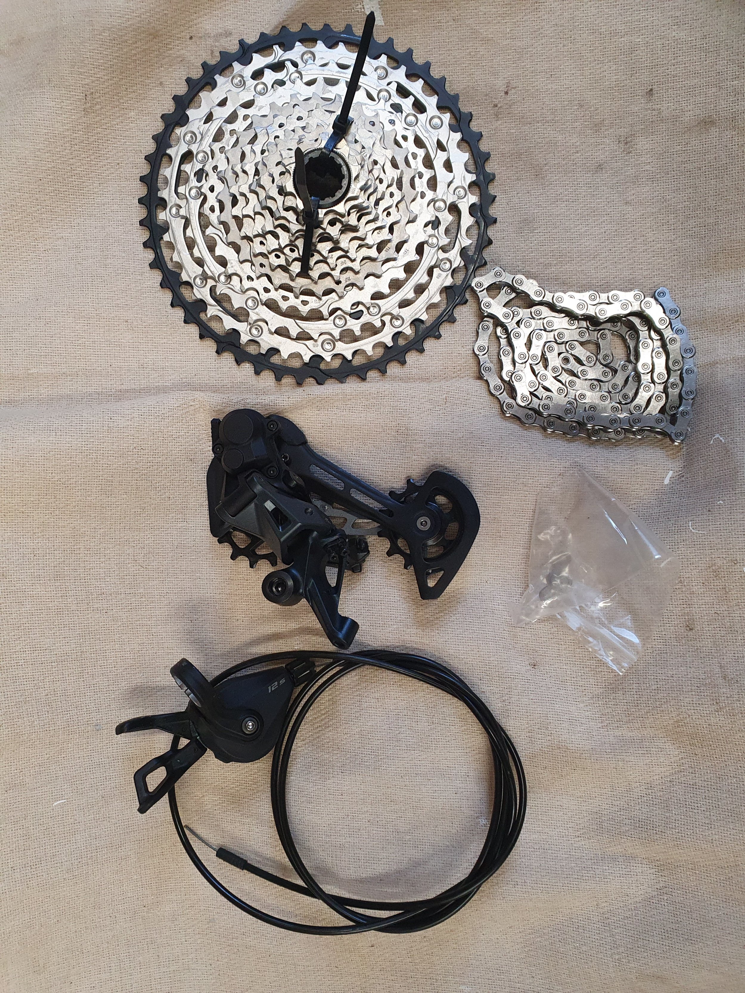

Got a brand new one taken off bike never used, along with other drivetrain bits if its any use to you
Appeal to a rider on here to let you have their worn cassette. The 10t probably will not be worn. I may not be typical, but I rarely use my 10t.
Edit: Better still just post the 10t, not the whole, cassette!
Massive thanks to Blinkie. Parts arived all present and correct. 🤩 I messed him about a bit without realising (sorry) the details needed but he battled on. Job done
