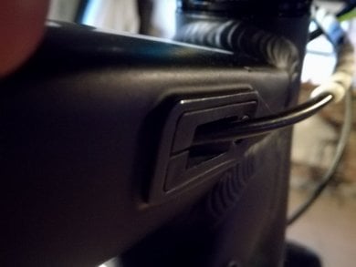

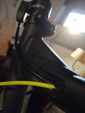

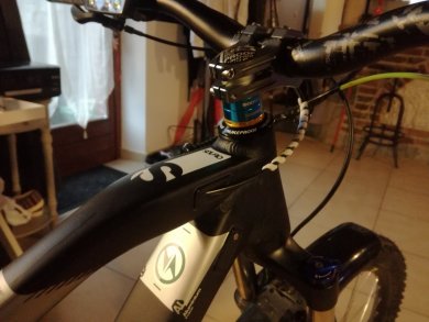

I went for the external one and routed it in the top tube (I had to buy a new 2xholes cable grommet). I wasn't a fan of needing to drop the motor if something went wrong with the dropper/cable (it's pretty easy to do but I don't like to deal with the cables nest when closing everything).
Here's how I routed the external one:
1.5 years with it, crashed hard and still working, no servicing except one cable replacement.

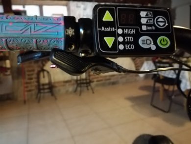

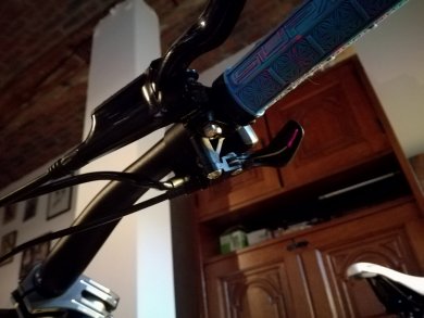

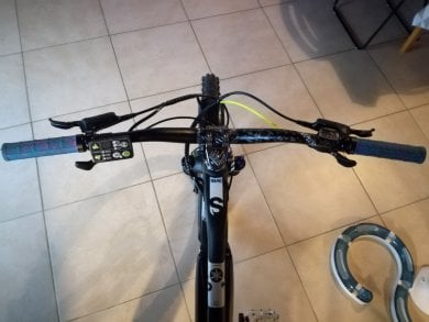

Could you post a picture of how you've routed the cable at the front and how you've positioned the dropper lever please :)
