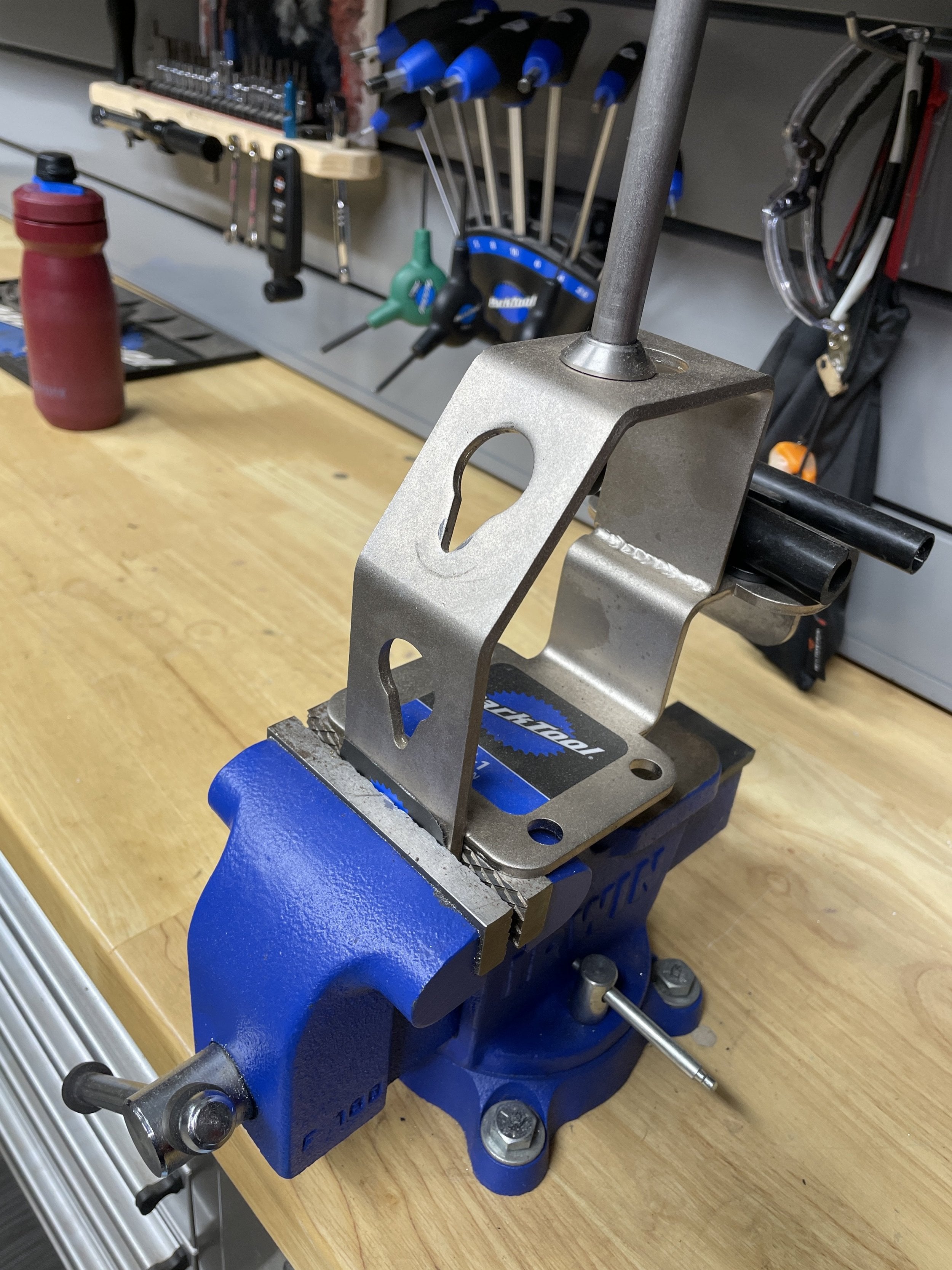

The Park Tool Wheel Holder caught my eye. But for that price ($200), no friggen way. But one day I was surfing the Trek tool site and saw it listed for $32.
I click BUY!
It lives in my vice and I use it more than I thought.
