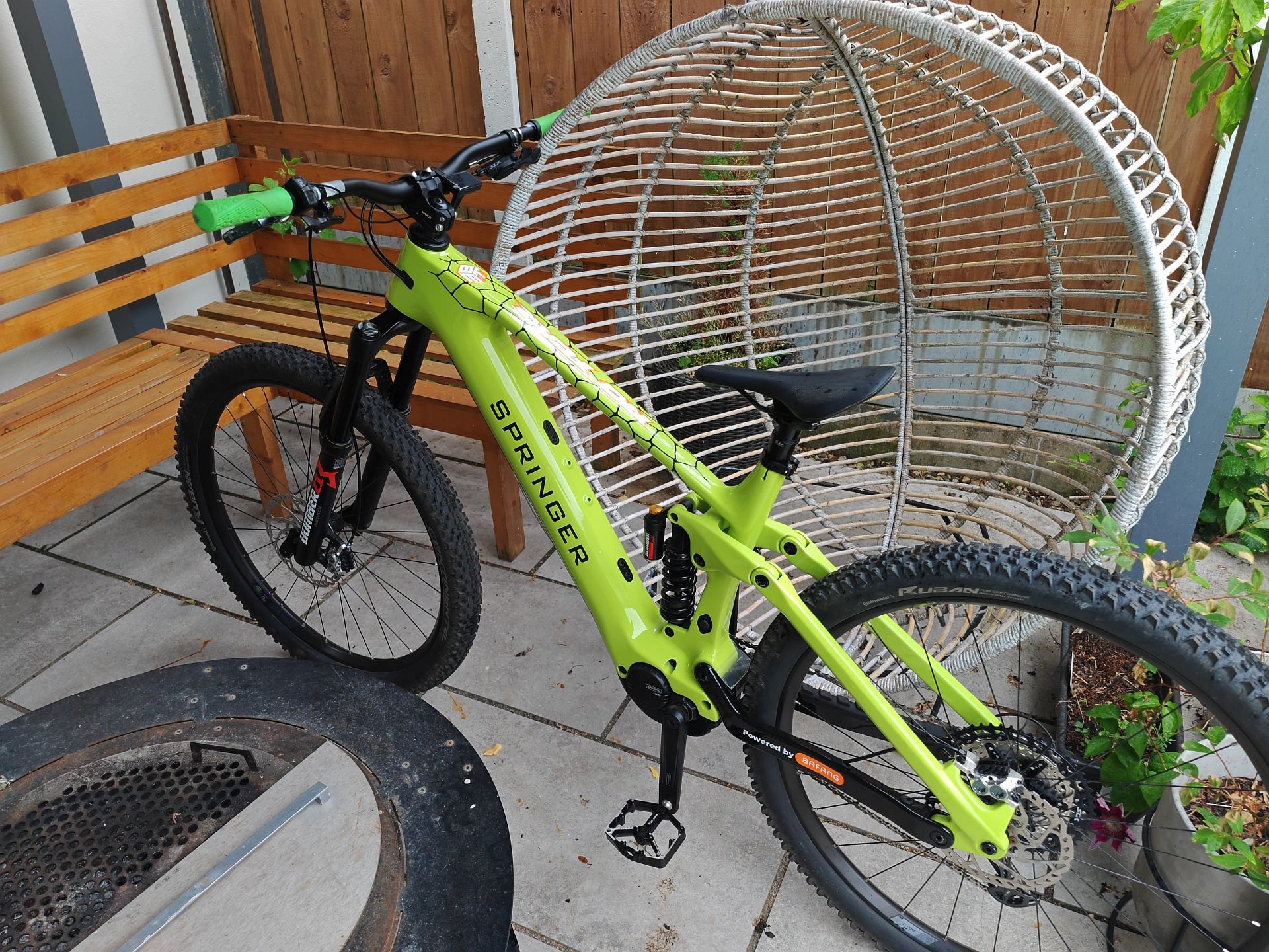

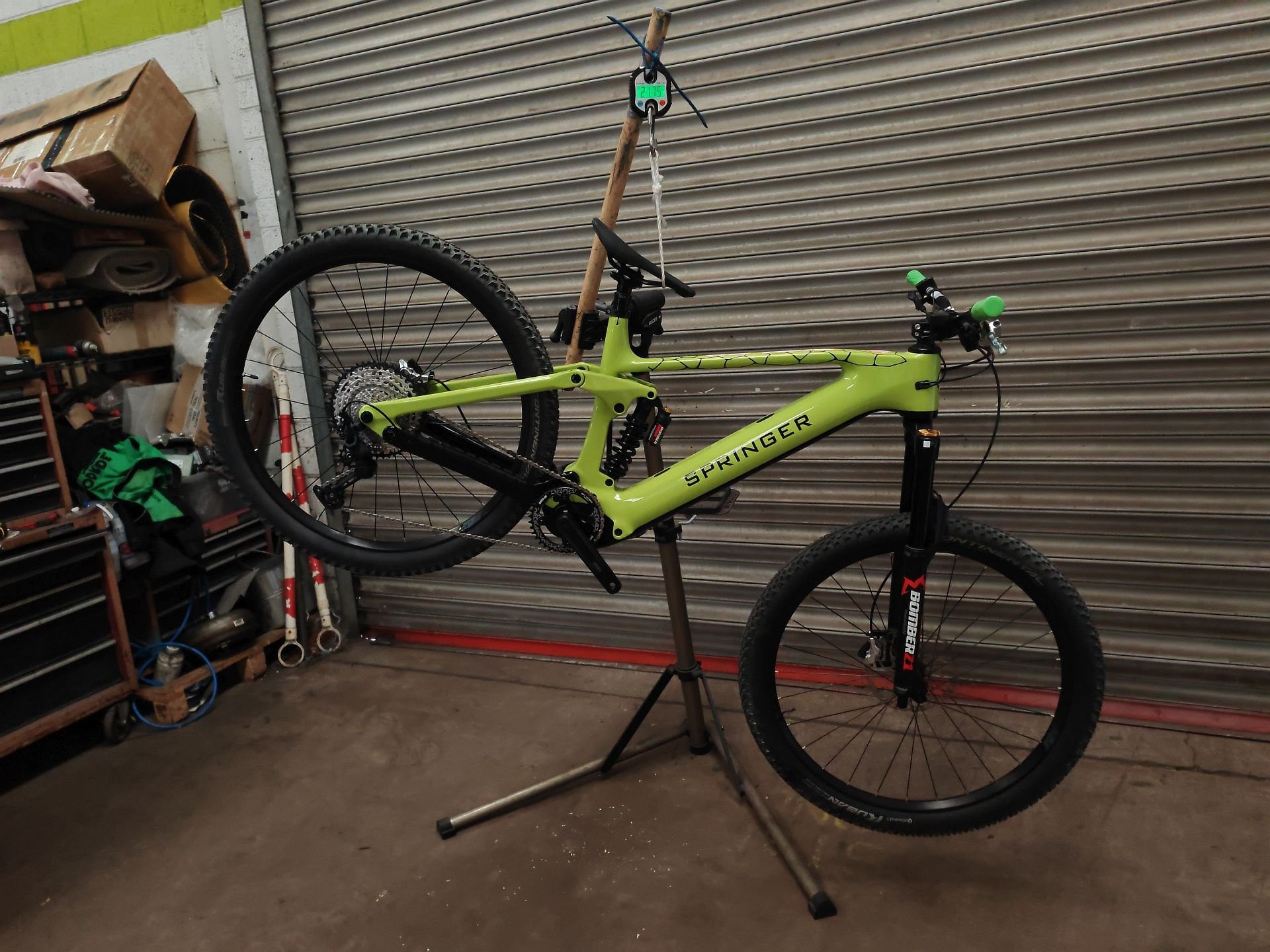

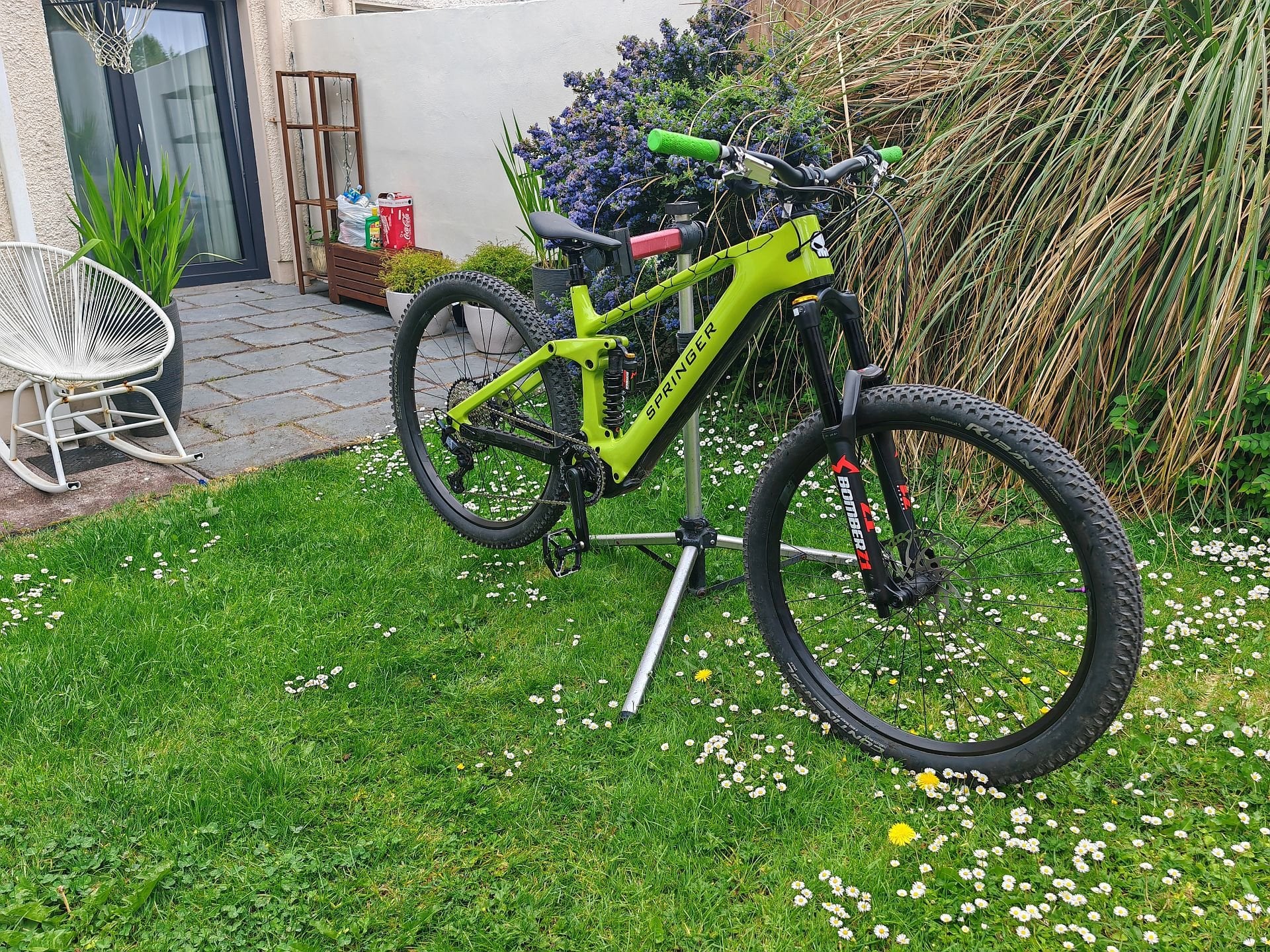

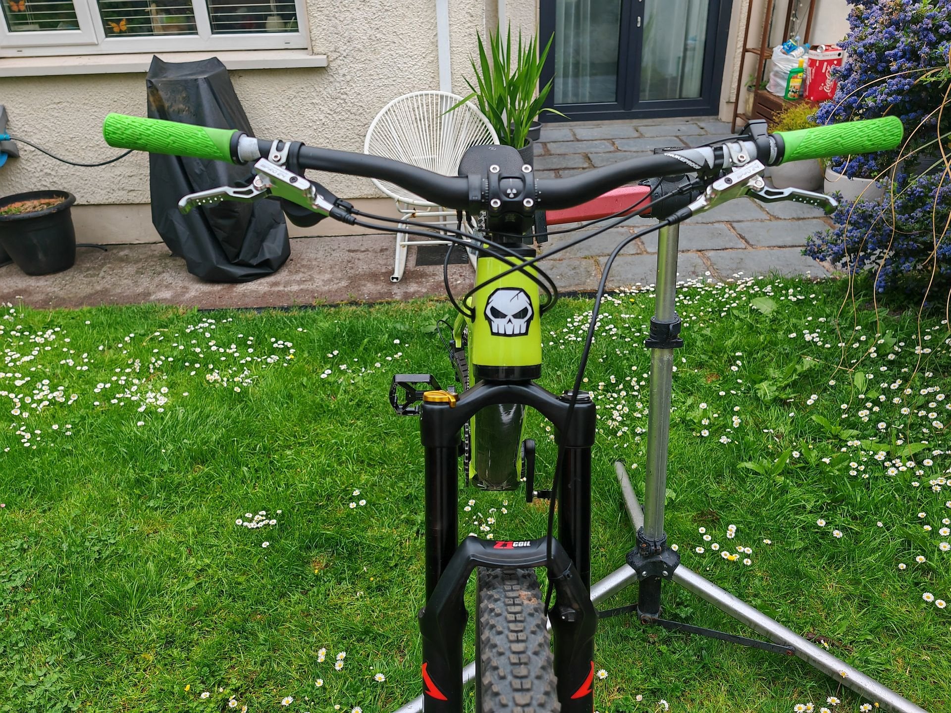

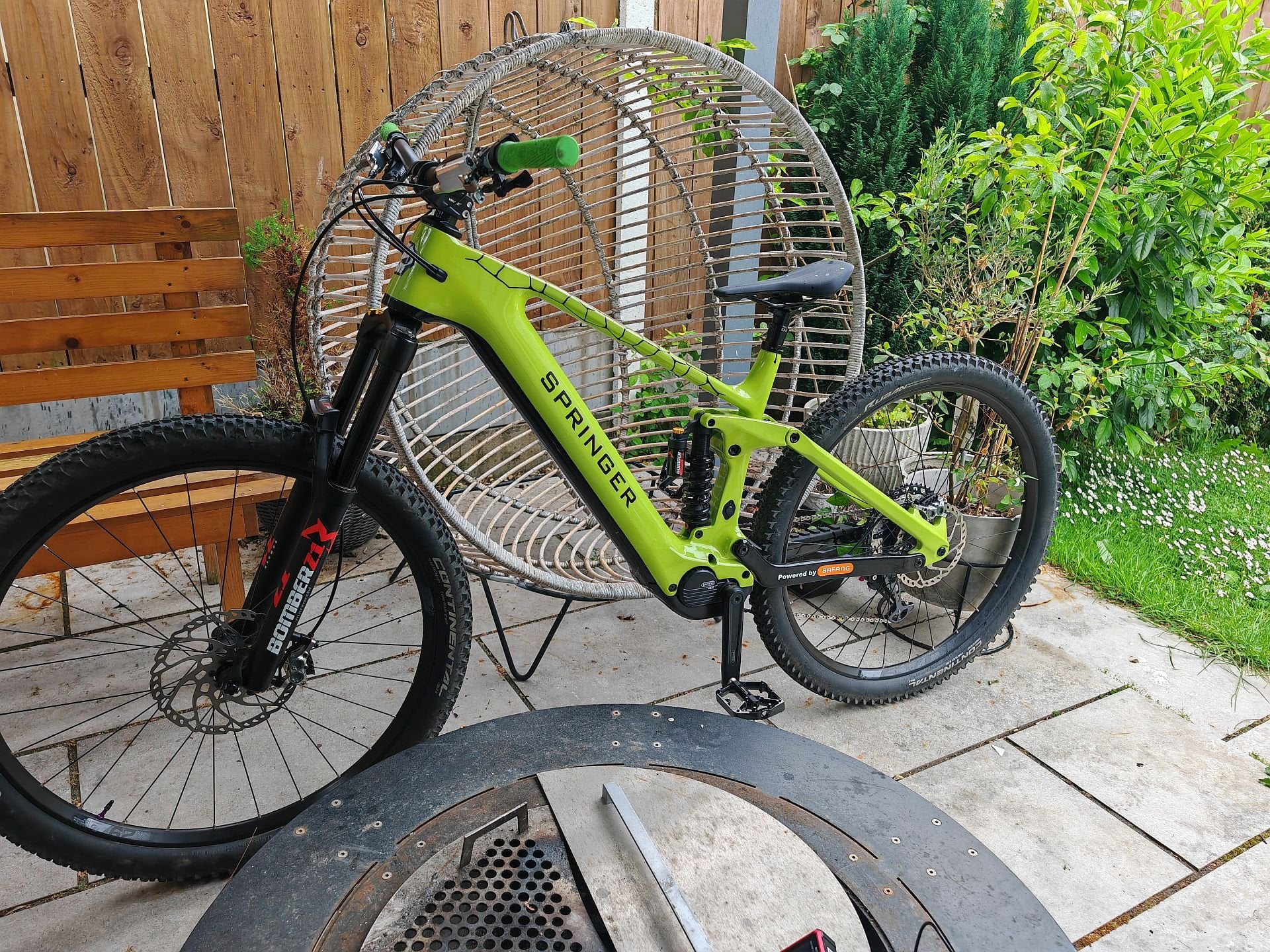

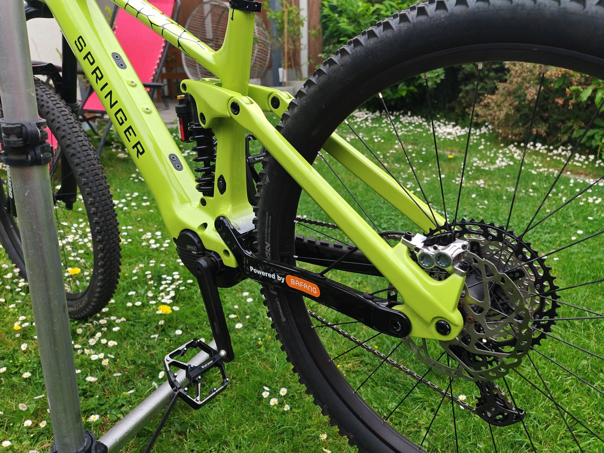

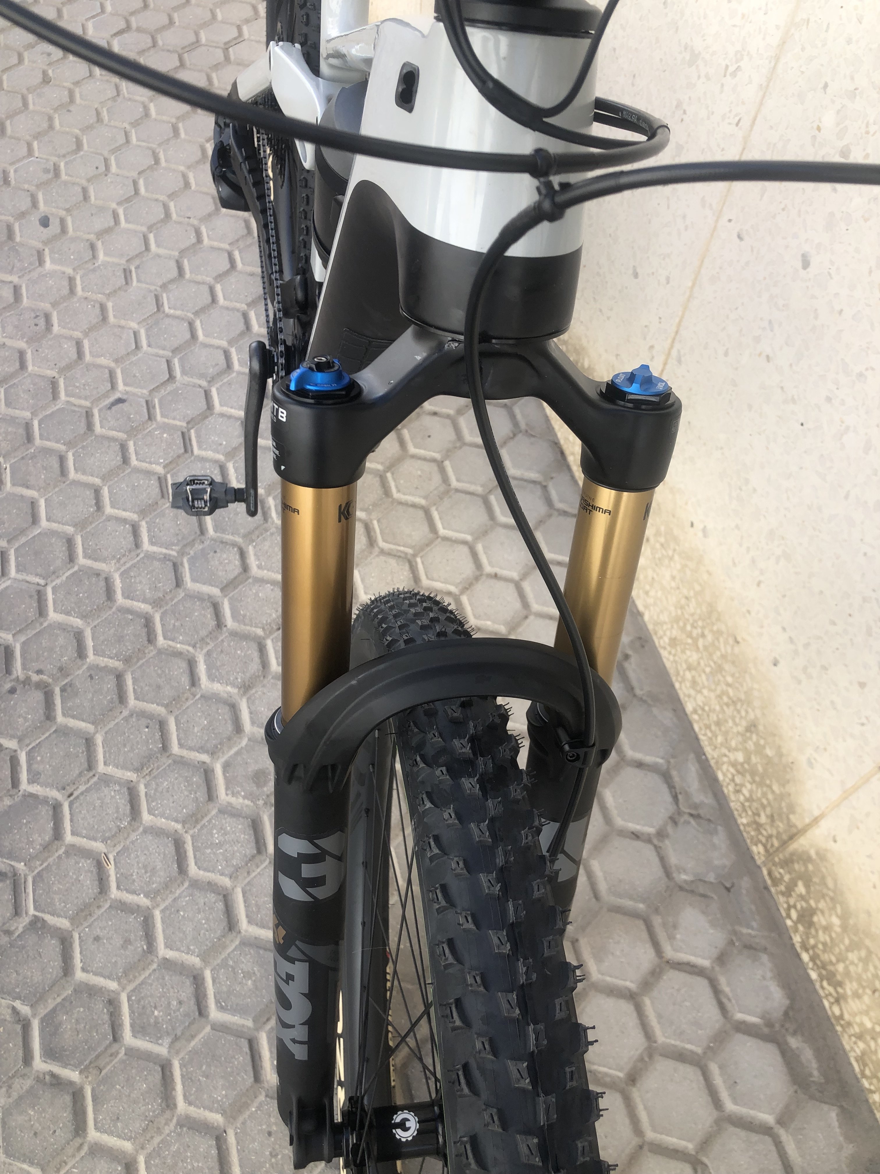

Found a bit of a time and finished up my CEF50 frame. Long story short:
-FORK: 170MM BOMBER Z1 COIL
-SHOCK: BOMBER CR + COIL SPRING
-BATTERY: 12S4P @ SAMSUNG 53G 2170, JBD BMS
-WHEELS: SYNCHROS
-BRAKES: IIIPRO4
-DRIVETRAIN: SLX + 38T CHAINRING
-REST: AS YOU CAN SEE
-WEIGHT: 21.75KG

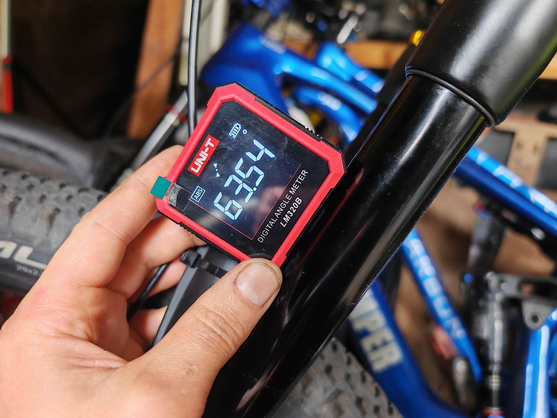

-HEAD ANGLE: 63.5DEG
Overall happy with the build. After I have dismantled the frame for painting, found that some aluminum spacer washers were damaged due to parts were hammered in during assembly before. Had to take off a bit of the original paint to make a bit more clearance to make life a bit easier.
DIY battery is located in the frame as low as possible to keep the center of gravity of the bike in right spot (about 15mm of the motor).
Battery ''marketing'' capacity 5.3*4*43=911Wh --> I think plenty for a long ride.
I have blanked the hole on top tube as I am not planning to use it. Surprised that rear triangle is nice and stiff enough.
A few pics, bellow:

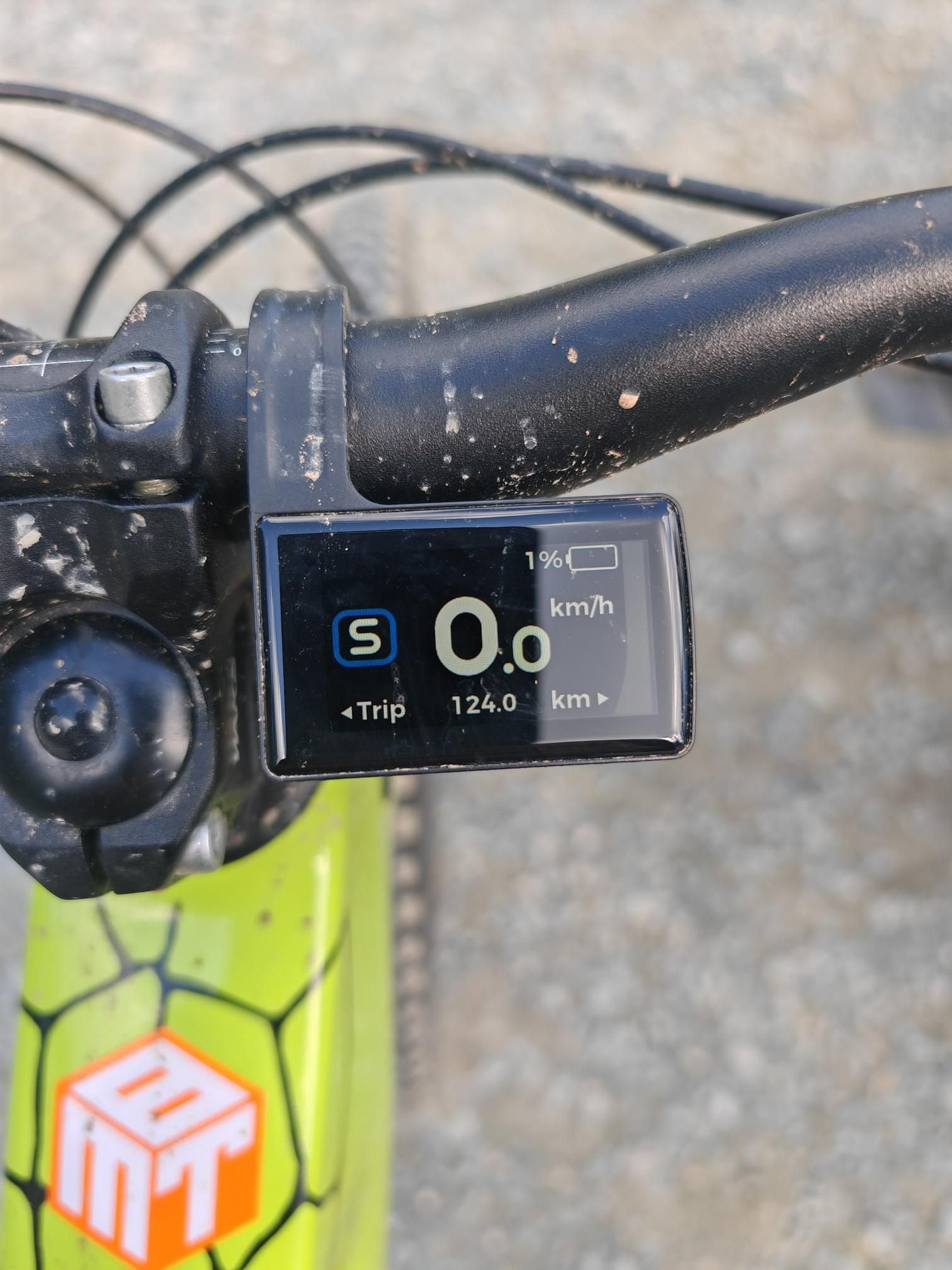

A bit of a riding done. So far used only one battery charge since new.
Battery: 12S4P = 48 pcs of Samsung 53G1 cells.
During first charge I have done:
-total distance on the bike 124km
-total elevation on strava 2488m
-total distance on strava 110km
-battery drained to 3.0V per cell
-about: 30% Eco
50% Tour
20% Sport and Sport+
-FW: CRX30PC4313E102004.5_230721 (the newest one for active riders)
I am positively surprised by the Samsung 53G1 cells, they not any worse than M58 from LG I have in other bike.
CEF50 - rear coil shock --> in my opinion standard linear coil spring is OK for this frame. Suspension is rather on the active side but not wallowy at all.
Headset got a bit loose - had to retighten it a bit.
Only complain is to rather soft aluminum bolts with small/shallow 4mm allen key. The key hole is a bit too easy to strip, especially if You try to tighten the bolt via the shallower end.
Happy with the build.
Regards
Peter
