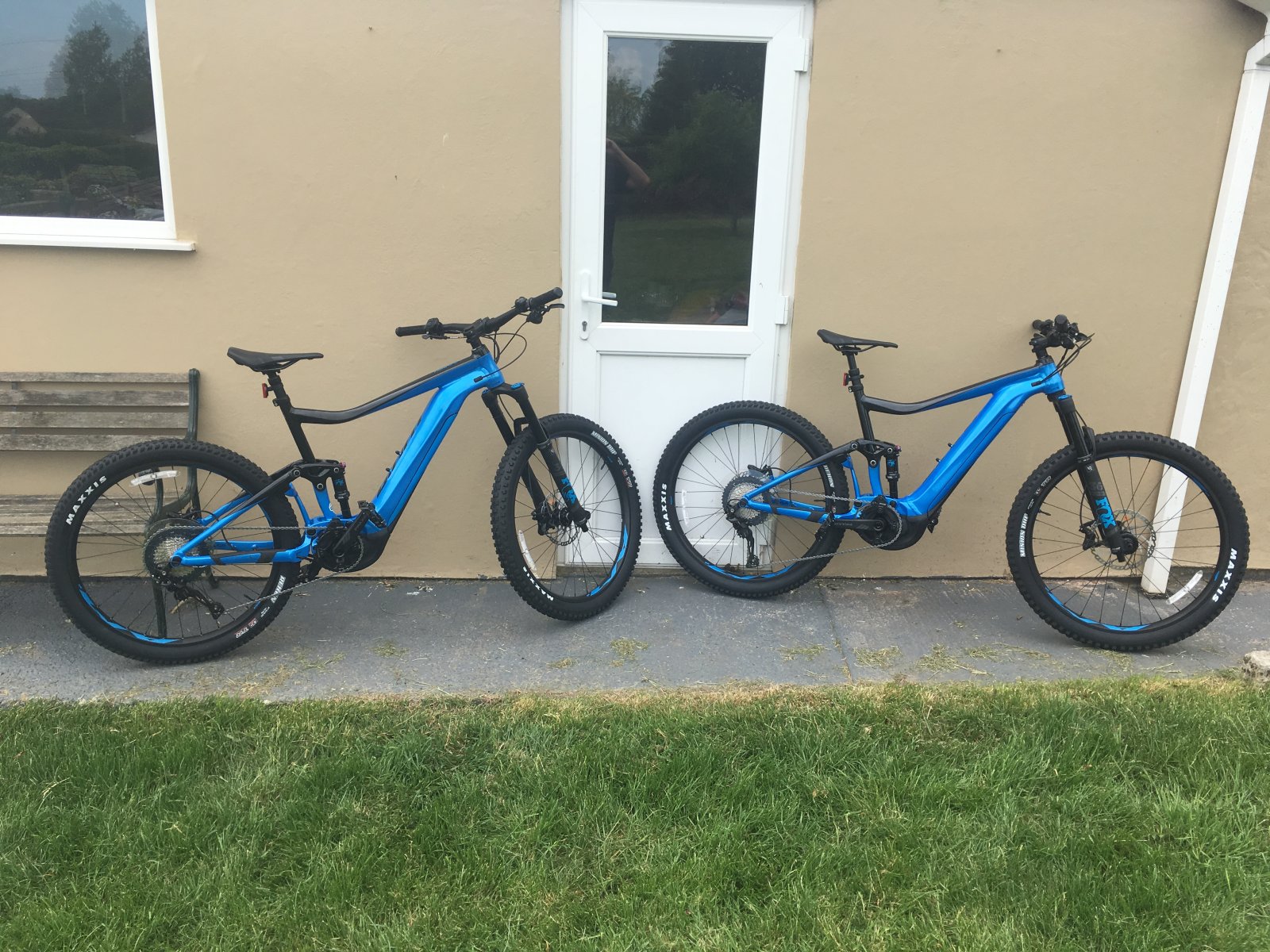

Guys, thank you for all your advice and comments, I ended up buying the E+2, one for me (XL) and one for the Mrs (L). I believe they both have the new ride control 'waterproof' connection, but not sure about the newer hub, is there any way of telling...?
What most of us experienced with the old hub, is a clicking noise when you get on the power. Almost a metallic click. If you hear that you have the old freehub. That is when it still works. If it fails the bike will do funny things and become basically unrideable. I had mine replaced immediately when my friend's hub failed. Giant had no issues as it is a known issue.
Not really unridable
If you have zip ties with you you could vip the cassette to the wheel to get home
