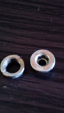

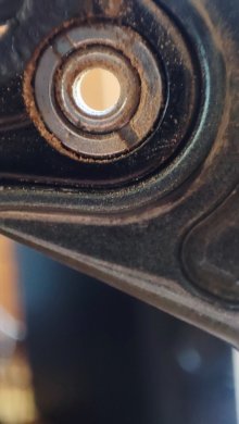

Although I've posted on another similar topic about a creaking noise on Stance, mine has started to develop the exact same noise. I can reproduce it by putting pressure on the right chainstay. I tightened the derailleur hanger screw which made it stop when pushing on the chainstay but on the road it still made the same sound.
This screw has 2 metallic parts, I think you need to put a small flat screwdriver on the indents from one side then screw it from the other otherwise they both turn together and are always loose. I put grease in between the two which seems to have fixed it. Also removing the wheel and applying pressure on the chainstay seems to not produce that creaking sound.

Went for a ride today after applying grease on the derailleur hanger screw and tightening, the clicking is gone but it probably needs checking every now and then.
