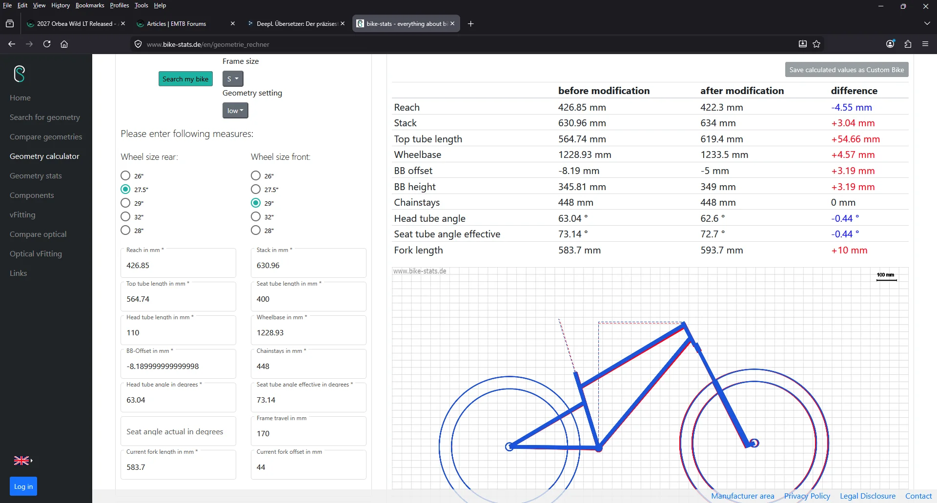

You can try it on this site:
I am interested in how it may affect the handling on the Wild?
All right, I’ve calculated your exact frame size in the image above. That means the reach will be only about 4.5 mm shorter, and the stack will be about 3 mm higher. I don’t think this will have any significant effect on the bike’s handling. After all, the Wild is also approved for the 180 fork. Since the bike is still so new, it won’t be easy to find a thorough review just yet. If there’s a dealer near you, try taking it for a test ride. If you feel comfortable on the bike with the 170, the 180 will definitely work for you too. Otherwise, I hope someone who’s had this experience or done this conversion can provide some good advice here.
