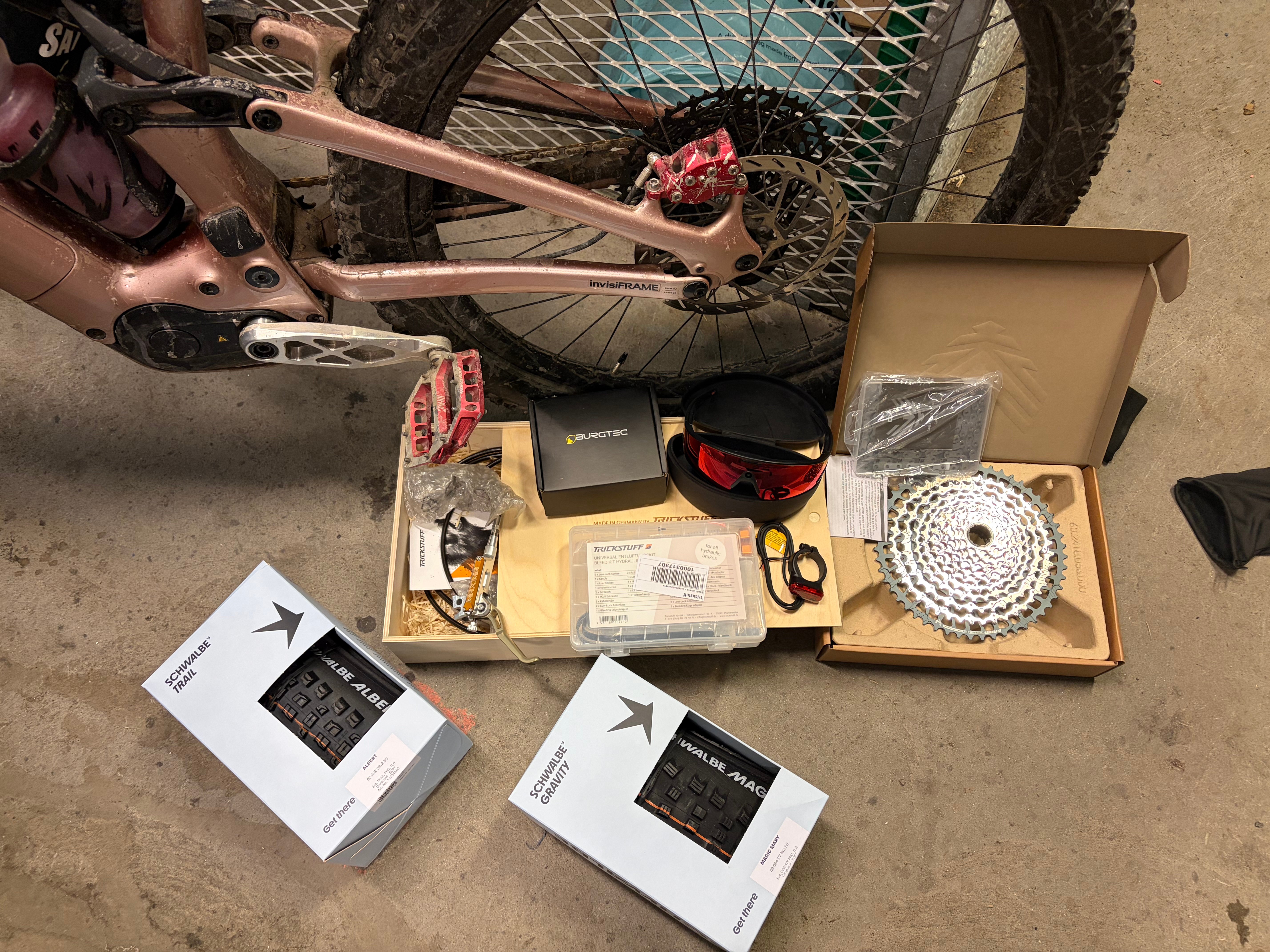

In the mean time I'm pimping/preparing to handle the power update of the Levo 4.
Nice I put Chris king hubs with the schwalbe Radials front and back also have the Ohlins 38m3 front fork and coil rear shock
