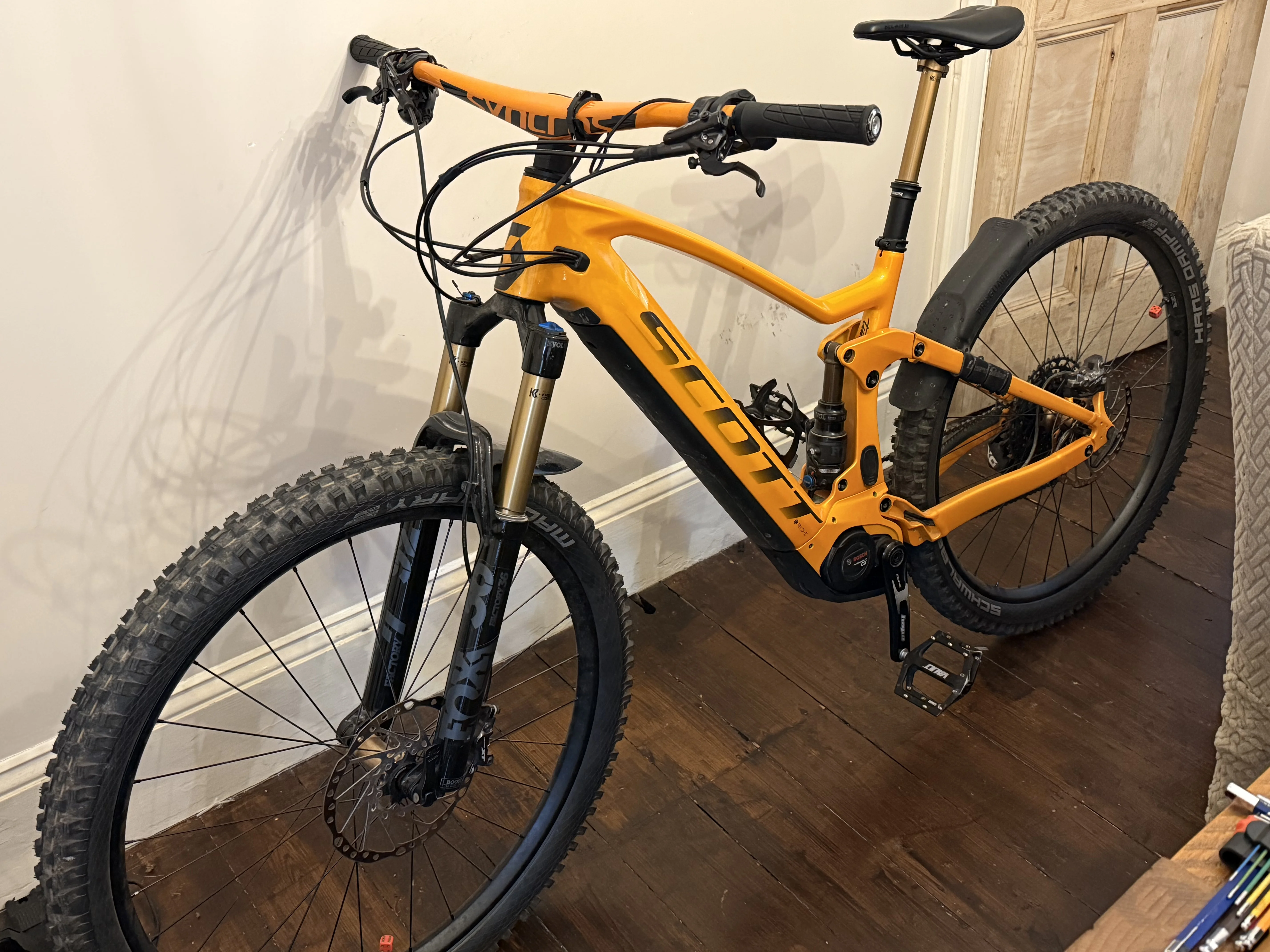

Gen 4 Bosch motor creaking under load

Good thread this one, though. Under-torqued bracket bolts, a TS25 bit, some blue Loctite, and a 1.5-mile pootle to the pier. Not bad for a Sunday afternoon's diagnostic work. Real test is still the Downs under full load - but the signs are promising.

Morning gents so took the bike for a proper ride early this morning to avoid the heat 🥵 just under 20miles up and over the downs And it’s good news the creaking has not returned 🥳 brakes are starting to struggle so Nxt job is brake service one job after another 😂 again just want to thank @Greg Watts and @Stihldog for your advice saved me from going down a potentially expensive rabbit hole 🤙🏻

@A.Collins1981 - that's the result right there. 20 miles up and over the Downs with the motor under proper load and not a creak to be heard - that's the real-world proof the frame mount fix did its job.
Glad we got there without sending you down the "it must be the motor, strip it out, ship it off" rabbit hole. A tube of Loctite and some patience tends to be less expensive than a warranty claim you didn't need.
On the brakes - fairly standard eMTB lifecycle, that. The extra weight and the tendency to find steeper descents once the bike's running properly do accelerate pad wear. If it's just feel and modulation starting to go rather than full contamination, a bleed is usually enough. If they're already spongy and dragging, pads and a bleed together while you're in there.
