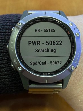

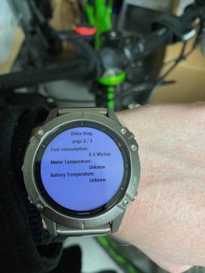

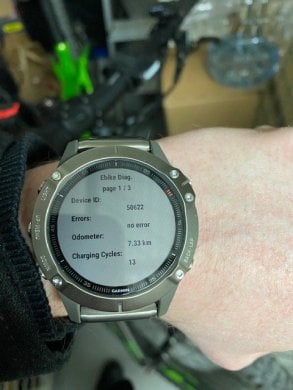

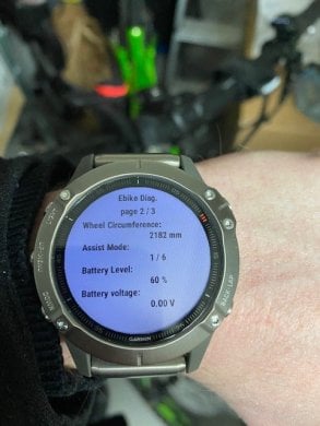

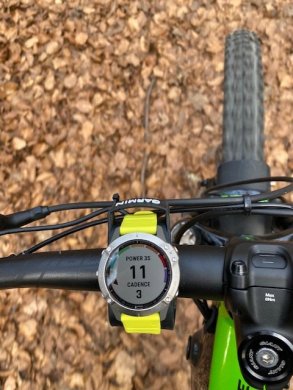

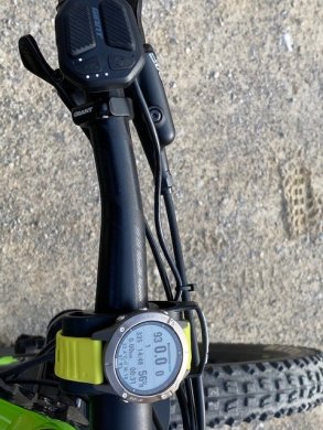

Hi, @JanCapek, thank you for your effort for developing ebike app! I can confirm that connection between Garmin Fenix 6 Sapphire and Giant Ride Control One ANT+ works perfectly. I have replaced original RCO unit on my Trance E+3 2019 with RCO 2020 ANT+ version. The cost of new RCO unit was 100€ at Giant LBS, but it was worth it..(y) There are few minor bugs (battery cylcle count is incorrect and ODO meter in diagnostics shows number in format ?.??km instead of ???km), but overall functionality is satisfying.
