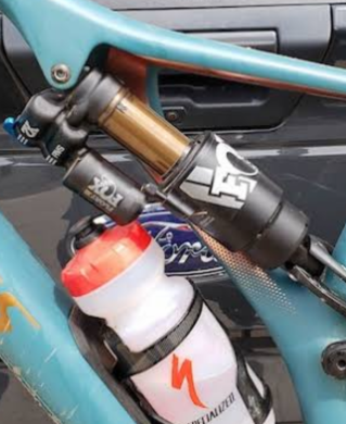

Hello all,
I'm having a hell of a time fitting my new Fox X2 210x55 shock onto my '20 Turbo Levo. The shock eyelets are slightly thicker on one end compared to the other, forcing me to mount it in one direction, with the external reservoir mounted towards the front of the bike. Unfortunately, this causes an issue because the rear of the bike can't fully compress otherwise the air valve hits the frame about 3/4 of the way into the stroke. If I try to flip the shock 180*, the eyelets are too thick with the flipchip to slide into the wishbone mount.
I know someone's fitted an X2 onto their Turbo Levo. Unfortunately I can't find any helpful pics or information because this forum doesn't allow you to search 2 letter words.
Can anyone help assist on what I need to do?
FIXED.
I ended up putting the shock on a vice, took the wishbone off the bike, put a punch into it and pried it open just enough to slide the the shock with flipchip inserts in and tightened it all up.
I’m not sure why, but when I rotated the canister, I couldn't spin it enough to allow the eyelet to line up. I like how it sits on your bike better than mine.
I ended up orienting it as below. With the flipchip set to LOW, the shock nor tire hits anywhere on the bike with the 55mm stroke. Im excited to give it a try with the new shock. Last part of the build is the 2020 Fox 36 grip2 160. Unfortunately it’s backordered until Feb24.
Side note, I’ve put 230psi into the canister in order to get 23-25%sag (13mm), and I only weigh 140lb. That doesn’t seem right. Any thoughts?
You need to fit like in your 2nd pic (air can at the bottom) and just rotate the air can 180 degrees so the air valve sits on the outside of the frame
Cant see why you had any trouble with the eyelets, my 210 x55 X2 shock went straight on with no problems on my 2020 expert

There are only 2 positions for the valve that are 180 degrees apart. You have to rotate the entire canister. there's a thread tha shows the wrong position and the right one
