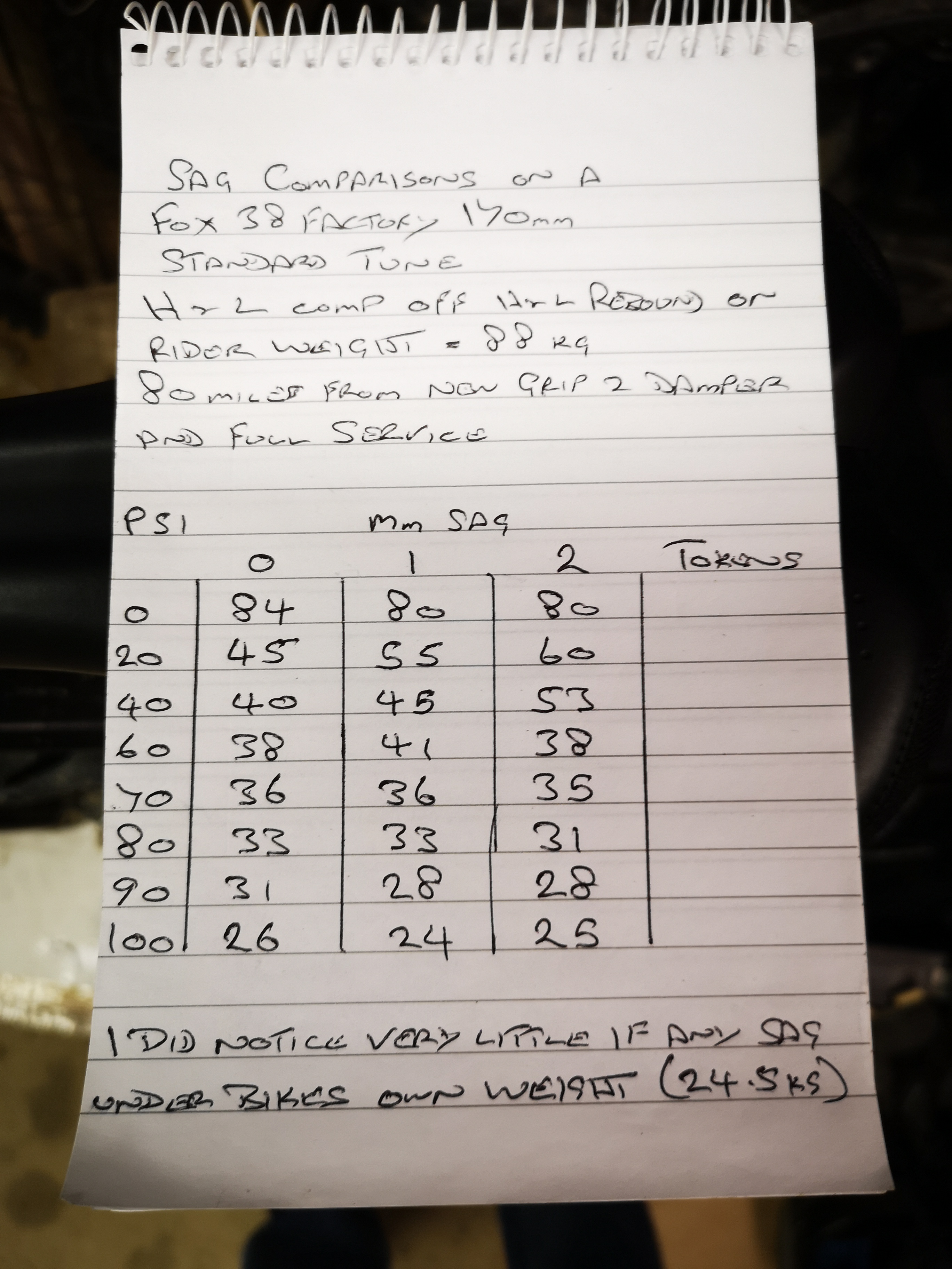

Being retired and bored shitless I decided to have another play with my forks. Now everytime I check my sag it's at a different psi to get 34mm!
So I have spent an hour or so at different pressure's and tokens to give me some idea of where I need to be with my forks.
The photo might be of some use to you guys?
Makes sense. Spring rates with different #'s of tokens don't vary that much for the first 25-30% of travel, which is of course where sag typically is. And I notice (I think?) that your ideal pressures for hitting your sag target are considerably lower than Fox's specs. And Fox's specs are rather silly, because they don't tell you which sag target (15% of 20%) they used, and of course bike geometry and weight balance come into play. I say use what works for you! The one thing I have noticed with most Grip 2 Fox forks though is that they tend to perform better on trails (vs in a bike park) with almost no compression damping (HSC or LSC)
