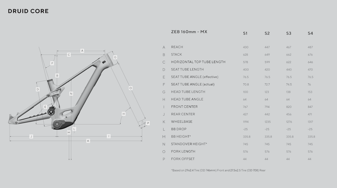

I can probably in general describe what I saw. The L (required for a decent dropper insertion) had the Reach of a size Medium bike and the stack of a size XL. It had the chainstays, well nearly longer than anything I've seen. Like makes those stupid machined Al bikes that are glued together (POLE) look short, and this (I presume) was before the rear end extended under compression. If they were giving me the CS dimension at its max compressed, well then it would be in the range of normal/ long and something I'd be very interested in.
I suspect they are going for this new, even newer style geo where the rider sits up really straight, and to get front end traction they had to extend the rear end out.
The Bosch is competitive with the DJI motor. The Bosch is quieter and in July gets the new screen and a power bump. The DJI total (battery and motor) is 1# lighter and is better integrated. In short, I like the DJI but I'm going to pick my next bike based on the frame qualities it possesses, as long it has the Bosch or the DJI. At this time, I'm leaning towards the Regulator.
The reach on a S3 will be 467, I find a lot of larges are in the 470-480mm range, so it's not really that far off. I would say most medium ebikes now a days are in that 450-455mm reach. The S2 will be 447mm.
The rear center on the S3 eDruid is 456mm, a S3 Druid is 452mm. So I'd say it's not really that far out there with geo numbers.
Maybe it's not as far off as I recall although I feel a large should have a 485-490mm reach. Is that 467mm on the E-Core model as sometimes the long travel model ends up shorter?
CS is 456mm at full extension? Will it grow around 20mm at full compression like other Forbiddens?
Like I said, I'm still very interested, and acknowledge that I have a history of liking/ buying bikes on the long side and I'm trying to experiment with shorter bikes moving forward.
You can’t just isolate reach as a measurement without considering stack also. A bike with 485/490mm of reach with a low stack height (something Trek have been reknowned for) has a smaller span (hypotenuse) than a bike with a shorter reach & more stack & that’s before you start to add spacer & riser bars.

I hear/ read this over and over but just don't follow.
They have this thing called 'handlebar rise'. In fact, OneUp just released their new bar offering a 50mm rise version. I've always ran the least number of under stem spacers possible.
So as I result, I keep the same reach while choosing my stack. Ignoring the stem height, with the E-Core S3 I can choose an effective stack of 662 (0mm rise bar), 672 stack (10mm rise bar), 687mm stack (25mm rise bar), 697mm stack (35mm rise bar), or 712mm stack (50mm rise bars). Just in OneUp products.
All have the exact same 467 Reach on the S3. I choose stack based on an appropriate lean angle to my torso, and secondly sometimes I raise or lower my bar rise based on front wheel traction.
Please explain how my reasoning is incorrect. I really want to understand but just don't.
You cannot ‘chose’ your stack, it’s a fixed measurement between two points on the frame, what you are referring to your bar height I’m assuming?
If we talk about ‘effective stack/effective reach‘ above the points of measurement on the frame, trigonometry means every 10mm of height above the point of measuring (centre of head tube usually) you gain about 9mm of ‘effective stack’ but you lose about 4.5mm of ‘effective reach’ (because of the HTA, the bars aren’t going up vertically).
Look at the span/spread/hypotenuse (whatever you want to call it) of frame for a more relevant reference of size.

If you tilt your bars back at the same angle as your HTA, yes, you lose reach.
I don't. Since when I stand and have lots of impacts I'm over the bars I have the bars straight. So 100% of my bar rise increases 'effective' stack while making no difference in 'effective' Reach.
I understand Trig just fine, that's not the issue here.
My current bike has a 497mm Reach and a 552mm Stack with a 20mm riser bar and I like how it sits.
If I buy the S3 E-Druid I'd have a 467 Reach (30mm shorter) and a 562mm Stack. I'd mount a 10mm riser bar and the 'effective' stack would be identical to my current ride. No two ways about it.
I guess the question is could I stick with the 20mm riser bars on the e-druid and maybe add 13mm to my stem length and end up feeling comfortable again? I'd be sitting up straighter, which may or may not be a good thing.

Your headangle isn’t 90 degrees. I don’t understand your logic about increasing bar height? If you raise your stem 40mm for example you’re still going to lose reach no matter how much you roll your bars forward.
Plus on top of that if you really roll them forward your hand positioning will be off.
Stems go back at an angle. Bars tilted at the angle of the HTA go back. Bars set up level, don't go back a single mm.
