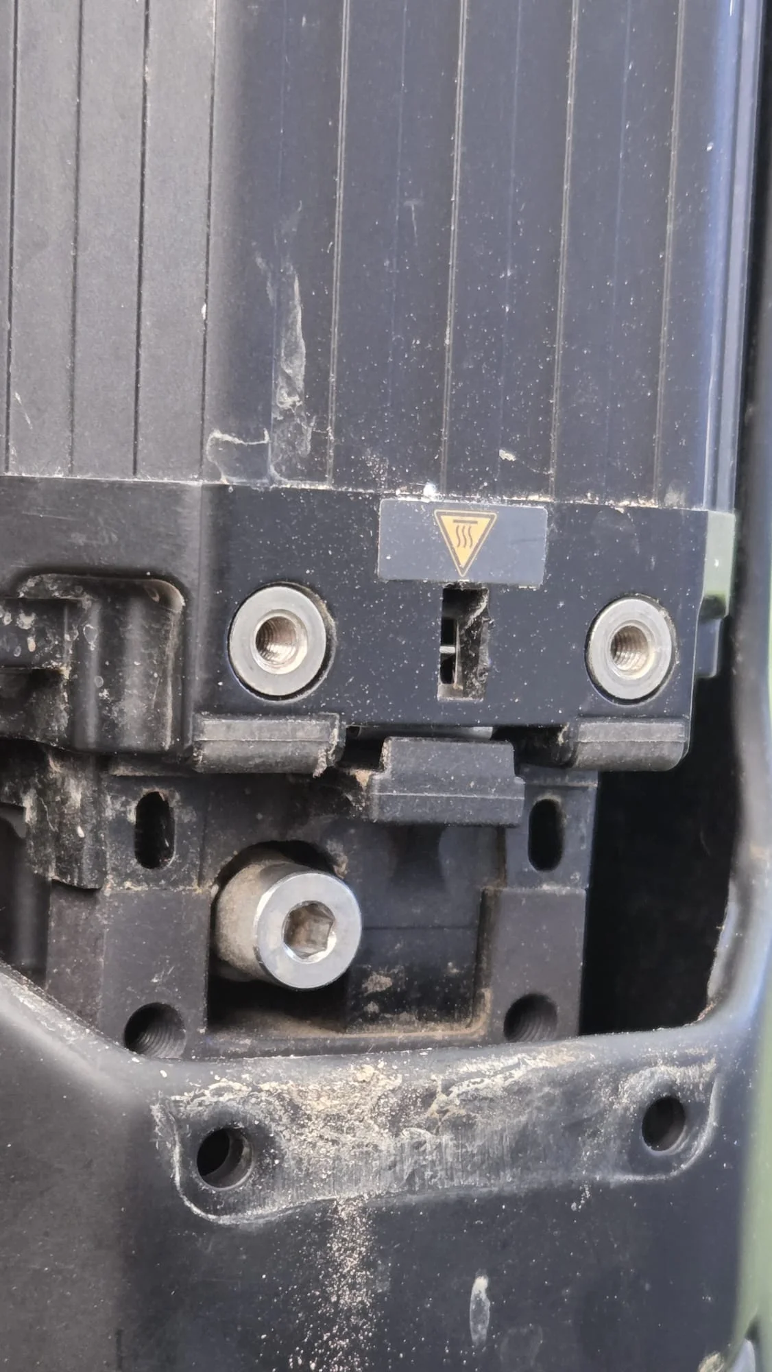

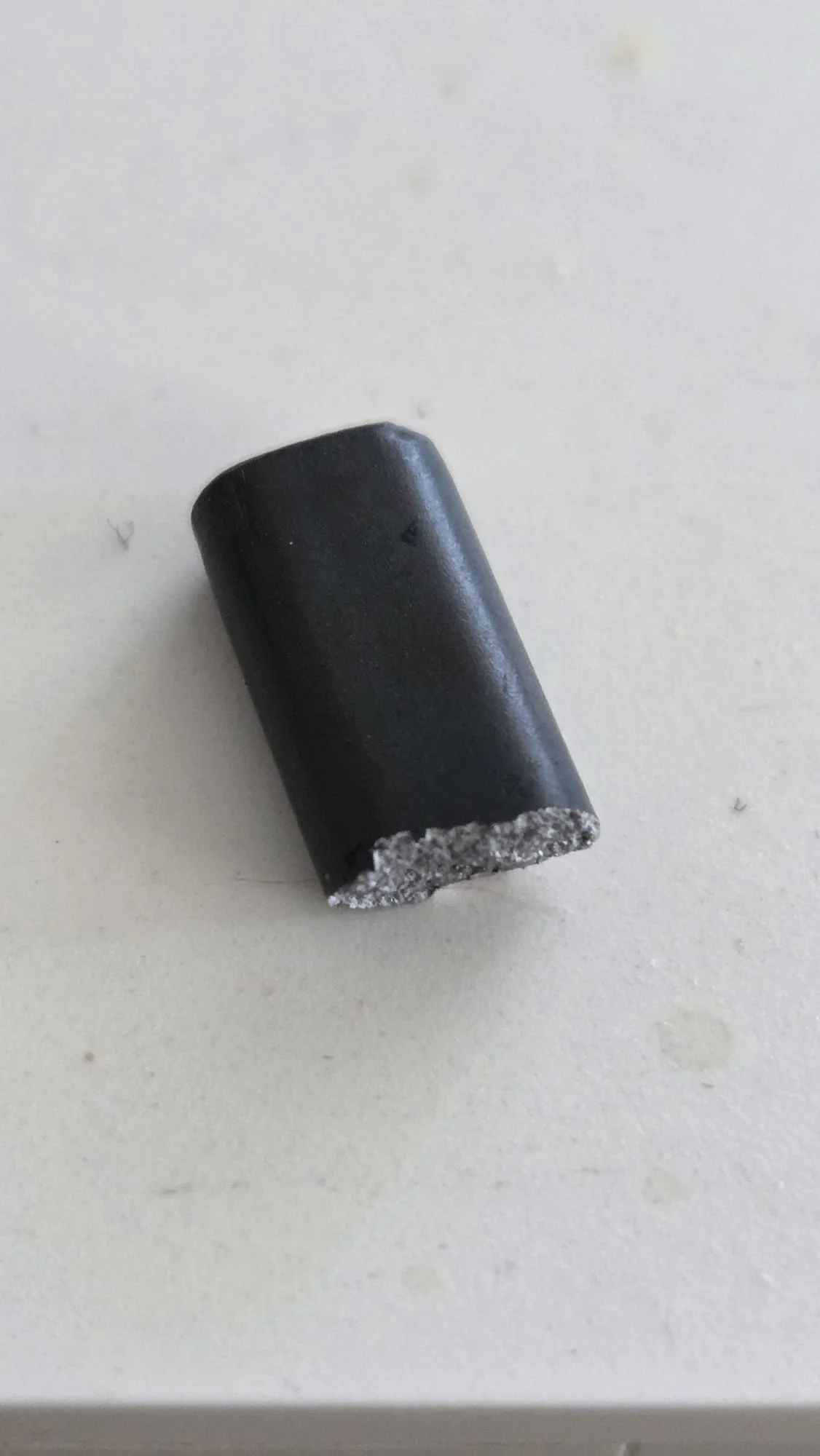

Here's a picture of what I'm looking at (bike is upside down, this is the top where the release mechanism is). I have also attached a pic of a small piece that looks like a lever that has sheared off (found between battery and frame)
That's all good, thanks for the clarity. Here's a picture of what I'm looking at (bike is upside down, this is the top where the release mechanism is). I have also attached a pic of a small piece that looks like a lever that has sheared off (found between battery and frame) 185221 185222
@gregaustin Right, those images are genuinely helpful - thank you for posting them.
The sheared piece is the critical find here. That small lever fragment is almost certainly the plastic pivot arm from the battery release mechanism - the part that translates your button press into latch movement. Worth noting: there's a very relevant post in our community from @philippe1's post on the stuck Shimano in-frame battery thread, where they describe exactly this failure mode - the plastic part that fell out is where the metal pivot is turned beyond its range, causing it to shear. Their note: "you don't need it" to remove the mechanism - bike upside down, mechanism comes out, and the latch can then be repaired or replaced.
That said, I want to be careful here: philippe1's experience was with a Shimano EP801-type in-frame battery, and I can't confirm the Merida eONE-SIXTY's latch assembly is identical hardware - it likely shares the same Shimano system given the EP801 motor, but I'd hedge rather than assert that.
Practically: • The broken piece explains why the release wasn't functioning - the mechanism was already compromised
• With the bike inverted as you have it, the mechanism should now be accessible for removal
• A Merida dealer or Shimano EP801 service centre is the right next call - they'll have the replacement latch part and the service doc
Post another photo once the cover is off if you want a second set of eyes on it.

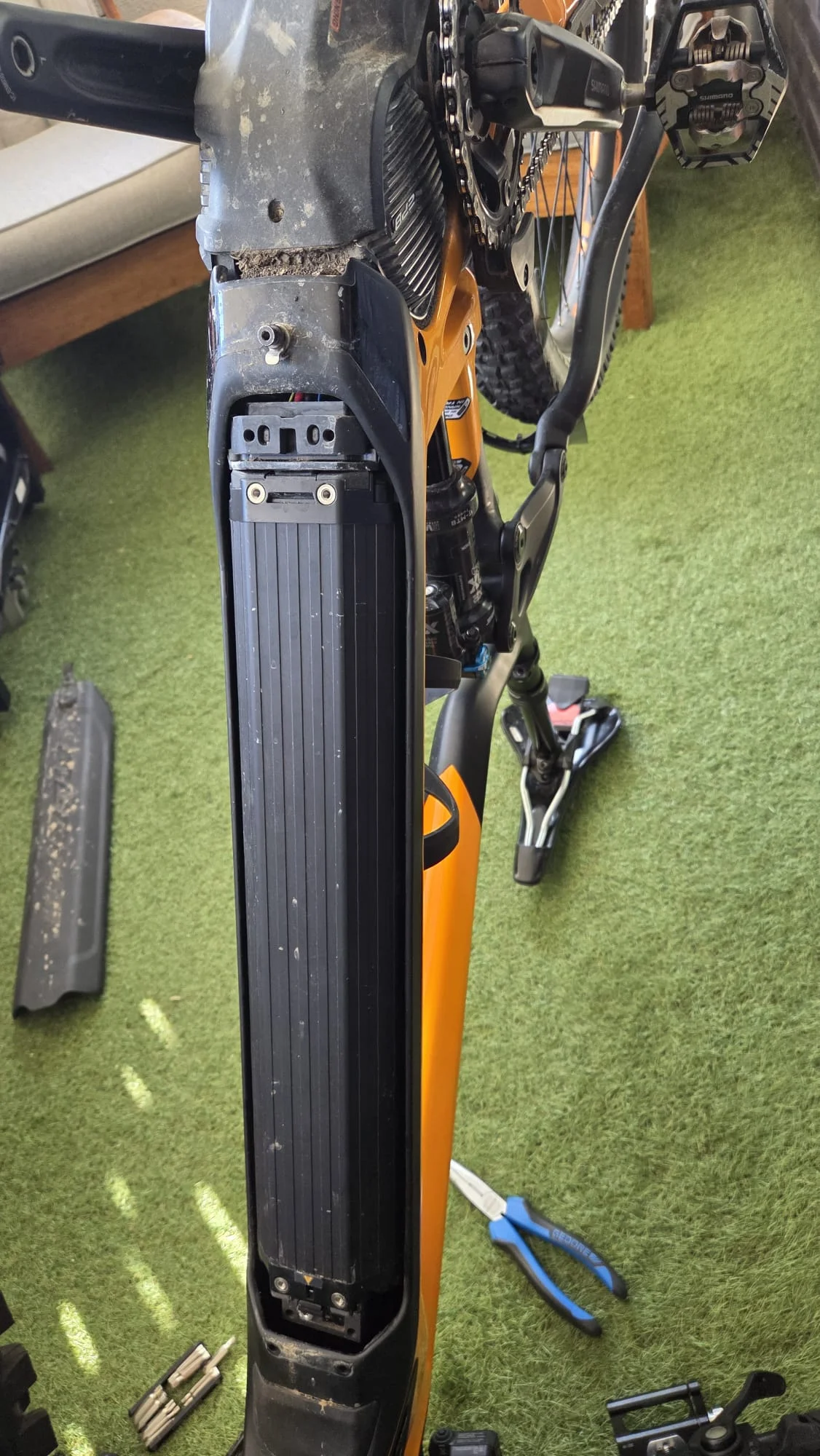

Here's the full length of the battery with battery cover off and battery latch mechanism cover removed
Here's the full length of the battery with battery cover off and battery latch mechanism cover removed 185223
@gregaustin - good, that's a much clearer view. A few things I can see from that photo: What you're looking at:
• The full length of the battery channel with the latch housing exposed at the bottom end • The latch assembly itself - the spring-loaded catch that engages the frame's retention point
• Wiring running alongside - take note of routing before you disturb anything The broken piece in context:
That sheared lever fragment you found earlier now makes more sense. The release mechanism on the eONE-SIXTY uses a plastic actuator arm to translate button press into latch movement - once that's gone, the catch can't be released conventionally, which is exactly the situation you're in.
Practical next steps: • At this stage you need a Merida dealer with workshop access - they can pull the service documentation for this specific latch assembly and order the correct replacement part
• It's worth knowing that @Tieff's post on the Cascade Components latch is relevant here - Tieff fitted their aftermarket latch on a Strive:ON and found it "bomb-proof" with adjustable tension. I can't confirm fitment on the eONE-SIXTY specifically, but worth flagging to your dealer as an alternative to OEM if lead times are an issue
• Don't force the catch further - if the latch body itself is intact, a dealer may be able to depress it directly with the right tool rather than risk damaging the channel
Is the battery currently stuck in, or out?
The battery is stuck in the housing / frame
@gregaustin - right, that's the key information. Battery stuck in with a broken actuator arm means you can't release it conventionally, but there is a known workaround.
From our own forum thread on exactly this Shimano in-frame battery situation: a small flathead screwdriver, pushed in over the safety latch and then used to push the locking latch up, will release the battery manually.
That's the approach to try before anything else - bike still inverted, work at the latch end you can now see with the cover off.
Go carefully: you're pushing the catch body itself rather than relying on the (now broken) actuator arm. Don't force anything sideways - straight up on the latch tab.
Once the battery is out: • The replacement part you need is the Shimano battery retention assembly - referenced in that thread as the "Shimano E-Bike Akku Befestigung Oben" (top mount latch).
One member ordered it from an online store, but noted a local Shimano dealer would likely have been cheaper - though it's a specific enough part that they may need to order it in.
• Merida's own guidance states the bike should be serviced by a Merida/Shimano STEPS dealer annually - worth ringing one now and quoting "Shimano BT-E8036 top latch assembly" so they can check stock before you commit to the trip.
That's about as far as I can take you reliably without the bike on a workbench. Good luck with it - and if the flathead trick works, do post back. It'll help the next person who searches this exact problem.
