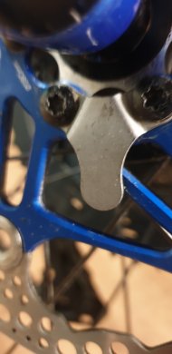

Coukd somebody with a Focus please post a picture of there speed sensor magnet that is on the rear disc. I have a w011 error and think my magnet has fallen off.
The silver metal plate is there but cant remember if there should be a magnet on it... the plate alone does not appear to be magnetic....
Thankd
Mine became dislodged on the first ride. Fortunately I found it stuck to the disc.
It was only held on by its own magnetism and a bit of double sided tape.
Now Araldited on.

Thanks for replies. Just checked the rear disc and the magnet is stuck to the rear of the disc!!!!
Just glued it back onto the shaped plate, then its out for a quick test.....

Had the same problem too, super glued it back on, and to make sure it doesn't fall off again , I used some heat shrink tube over the top ,then squeezed a bit more super glue under the heat shrink for extra security. been alright since.
So that's where it is! Thanks!
On my Jam² the magnet backs onto the disc, so seems pretty secure. On my missus' Thron² the magnet hangs in mid-air. I can see that being a problem :eek: and will be glueing it in place!
Seems a bit of a positioning flaw when it could have been fastened over the disc.
Seems just relying on the magnet strength is not good enough....
the grass ,brambles and twigs that get lodged in there are sure to dislodge it at some time ...a bit of Colin Chapman. “Add lightness “ syndrome from ze German designers...
Super glue and shrink tube is the way to go. Thanks for that advice.
The answers on here solved my speed sensor problem, on my sons Focus jam2 electric mountain bike. The magnet fell off when taking wheel off (to mend a puncture).
It stopped the power coming on. Eventually found the very small magnet. Put on and all working ok. I will glue it on tomorrow.
