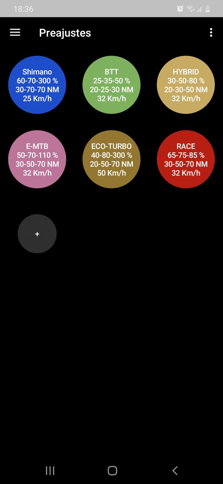

alfaura
May 15, 2020
Spain
These are my presets on ST Unlocker (aka my Nirvana)
% ECO-Trail-Boost
NM ECO-Trail-Boost
Max speed
