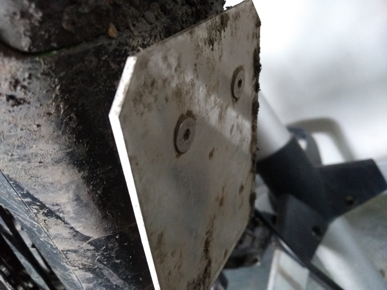

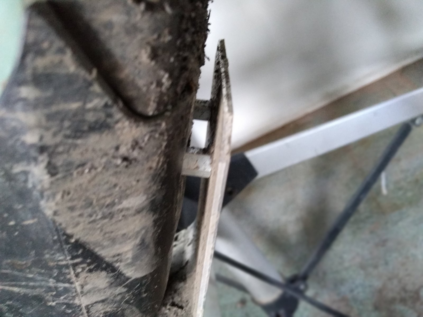

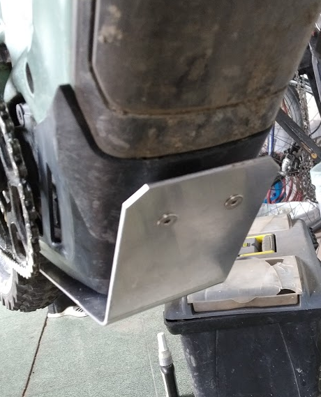

i thought the standup were sold out, so i made one myself. still need to be painted

Jona, how exactly did you install your guard on top of the original? Did you use the original guard's bolts on the front or some longer ones? How about the back of the guard?
I used hex spacers in the existing screws at the front, no screws at the back, just some loop and hook tape
