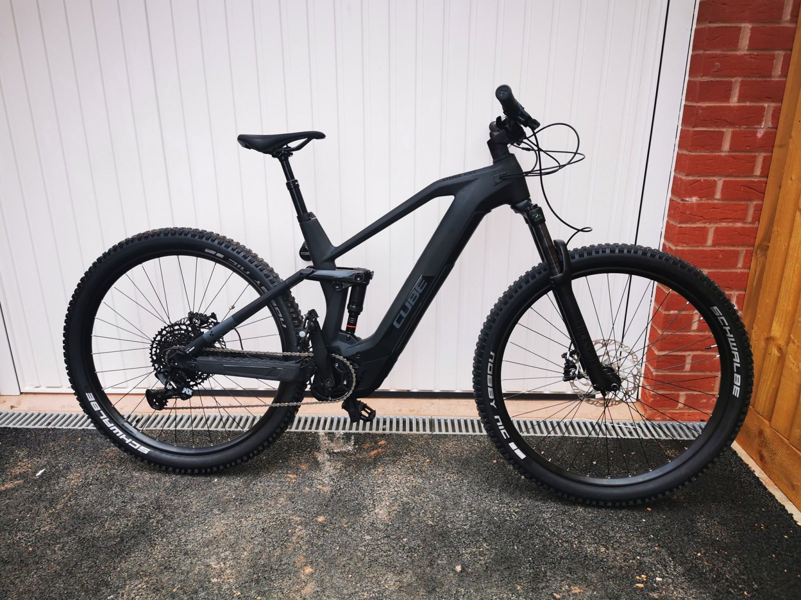

Finally made a decision!
It has arrived!
First Impressions... Power Delivery is so Smooth upto the Cut Off
Slight Wobble in the Front Wheel... Think maybe took a knock when Shipping (Tredz covering the cost of a LBS Fix)
Sizing Feels great (Size 20 and im 5'11)
Can anyone shed some light on how I know whether the Bike is Charging when Connected to the Bike?
First Ride out on the Trails today via the LBS to get the Wheel Wobble Sorted
A quick check over of the Bike resulted in finding on top of the Out of True Front wheel it Bent Mech Hanger, the threads are also buggered. The Front of the Chain Guard is missing. Oh and it definitely doesn't seem to charge unless I connect directly to the battery!
I've informed Tredz to let's see what they come up with.
The Bike though... wow when it's working it's phenomenal. I rode trails today that usually I'd avoid! Rode, Further, Faster and for Longer than I have any right too!
Looking forward to getting these teething troubles out of the way and piling the miles on the Bike!
