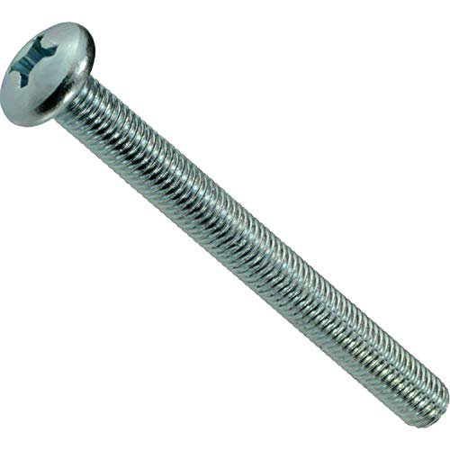

I do not recall the exact size of the screw I used. I went down to Home Depot with a piece of brake hose and started testing the metric machine screws they had in the gray bins for fit. The length of the fine thread machine screw I bought was one inch. Make sure the screw threads tightly into both brake hoses and then test pull the two hoses to make sure they don't separate.
You're situation is a little tricky. Shimano BH-59 brake hose has an internal diameter of 2.3mm. Shimano BH-90 brake hose has an internal diameter of 2.1mm. I would buy a screw that threads tightly to the 2.3mm BH90 brake hose. This means you'll have to force the screw a bit to get it to thread into the smaller diameter BH59 brake hose. I would heat some water in a pan and dip the brake hose into the hot water and temporarily soften the hose up to make the process of threading easier.
You want to use a machine screw similar to the one pictured. The screw's head style doesn't matter, i.e. slotted, phillips, hex cap, etc. since you'll be cutting the head off. Just make sure the screw has all thread and both hoses thread snuggly together. Both the BH59 and BH90 hose have the same outer diameter.

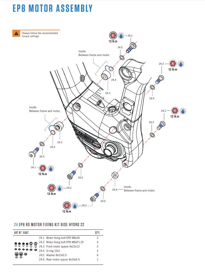

Here is a previous post I made on procedures for dropping the motor on a Rise Carbon. I've modified it as best as possible for the Rise Hydro. I have not dropped the motor yet on a Rise Hydro. I believe everything is the same. I've attached the torque spec diagram sheet for the Rise Aluminum.
NOTE: On the Rise Carbon, to lower the motor, you must gain access and remove all six of the hex head bolts. Unfortunately, one of the bolts on the drive side cannot be fully removed with the chainring on. This is because it hits the chainring when it is backed out and cannot be fully unthreaded which will prevent the removal of the motor. The chainring must be removed to remove the bolt. It's possible to remove the bolt without removing the chainring. You'll have to get creative with tooling and you must force the bolt a bit past the chainring. I've tried this method and ended up damaging the finish on the bolt. Play it safe and remove the chainring. I have not removed a Rise Hydro motor and do not know if the motor mounting bolt issue also occurs with the Rise Hydro frame. It may not be an issue. If somebody knows, please let me know so I can modify the motor removal procedures for the Rise Hydro.

5) Jiggle the motor loose and "Slowly" lower the motor down a few inches and onto a stool placed several inches below the motor. Make sure the motor doesn't fall off the stool. There are three aluminum spacers used with the six bolts to mount the motor to the frame. One or more of the spacers may fall out when you remove the motor from the frame. Two of the spacers will have a small machined shoulder. These two spacers mount inside the frame at the front of the motor. The third spacer is flat on both sides and mounts at the back of the motor, non-drive side.
Note: The diagram and torque specs seen pictured below are for the Rise Hydro. The motor mount spacers in the Hydro diagram look similar in configuration to what is used on the Rise carbon. I believe they are the same however, I've not yet removed a Rise Hydro motor and cannot confirm they are the same as the Rise Carbon. Therefore, pay attention to motor mount spacer differences and where they are used on the Rise Hydro. Please let me know if they are different so I can reflect this in the motor removal procedures.

8) Reached up into the frame and make sure the front two motor spacers are pushed all the way into their respective sockets at the front frame motor mounts. Lift the motor up into place. You will have to wiggle the motor a little bit to line up the first few bolts. The rear non-drive side aluminum spacer can be fussy to get into place. I've found it much easier to hold it against the motor and slide both the motor and spacer into position at the same time. Apply a small dab of blue thread locker onto each of the six bolts and install. Do not tighten the bolts until all of the bolts have been threaded into place. Torque the bolts to specification as listed in the "Blue Paper" Rise Hydro owner's manual. See diagram below.
