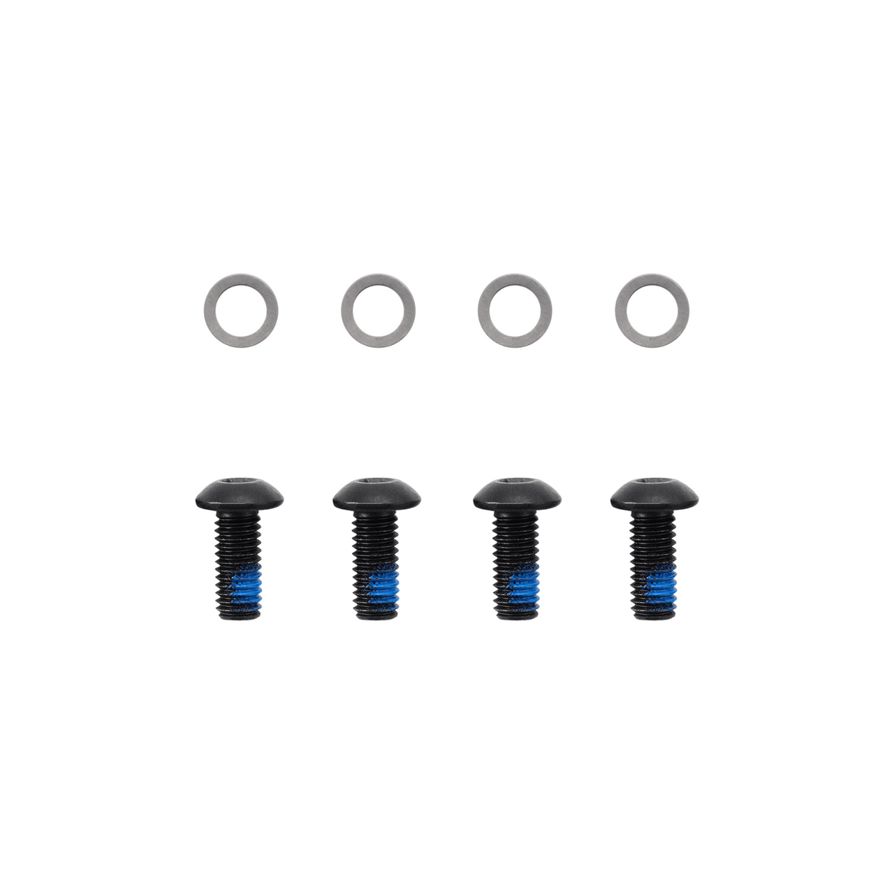

I've noticed online this bolt kit fits the FP700wh battery and also a FP330wh battery. No information anywhere for a 330wh battery but it would be great if there is 330wh battery coming that could be used as a range extender!
330 would be perfect for what I want. Was there an announced 700wh extender? Why is the assumption that "FPXXX" is an extender?
Nice finding.
Seems wired as compatibility they list M1, M2 and M2s but only Amflow PX and PX PRO that only use M2s.
It is impossible to do a 330wh battery with the same cells as the FP700 as they are 10 cells in serial to make 36v. You cannot add or reduce cells and keep it at 36v that is needed for the motor.
They could use the common 21700 cells and fit them on the same tube format, it will be quite a bit of wasted space and not really usable as extender as it will be probably be too long, around 40cm x 5.9 x 5.6cm diameter.
Nice finding.
