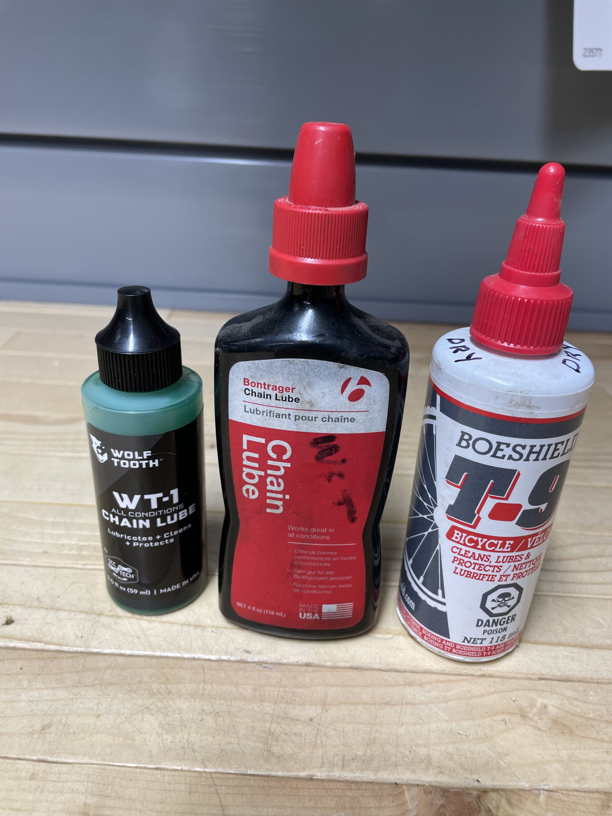

I use 3 types of chain lube. One of them is probably just olive oil …I wouldn’t know. XT cassette and 8100 Shimano chain.
But the most important thing I found was proper cadence. I’m mostly in eMTB mode and climb almost any trail. These motors can add a lot of stress to our transmission and motor components. I believe that I have extended the life of these components by using the correct cadence.
I haven’t tried the hot wax or chain-alternating method.
