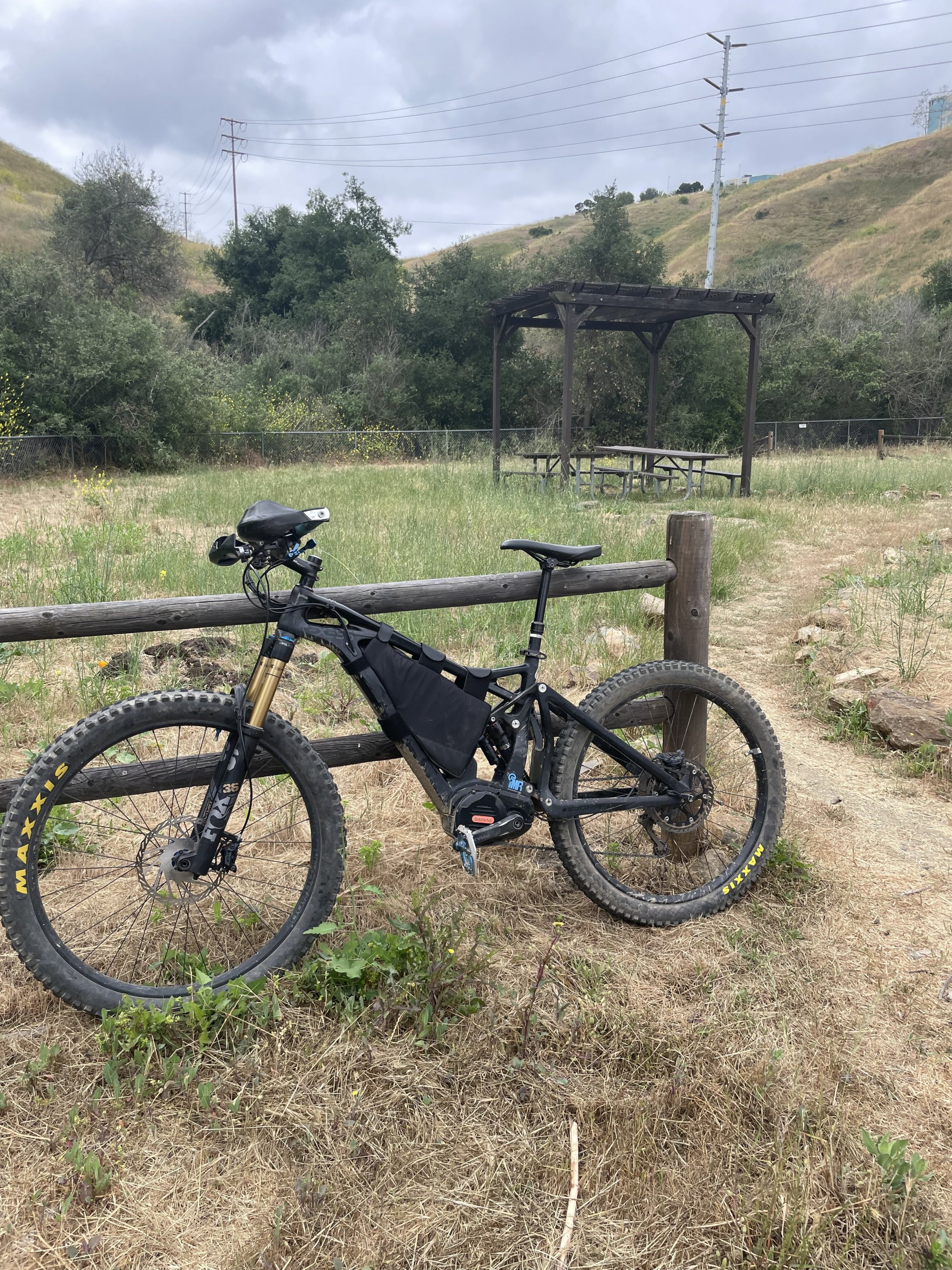

Back in late 2021 I stumbled across a new bike shop out in the Boston area and they had a few of the EXESS HP-E180 model bikes.
Carbon frame like yours but had a Bafang G510 1000w motor as well as an aftermarket Archon X1 controller.
So I did the same as you and ordered the frame and motor upgrade and built it up myself.
Been riding it for 2 1/2 yrs now.

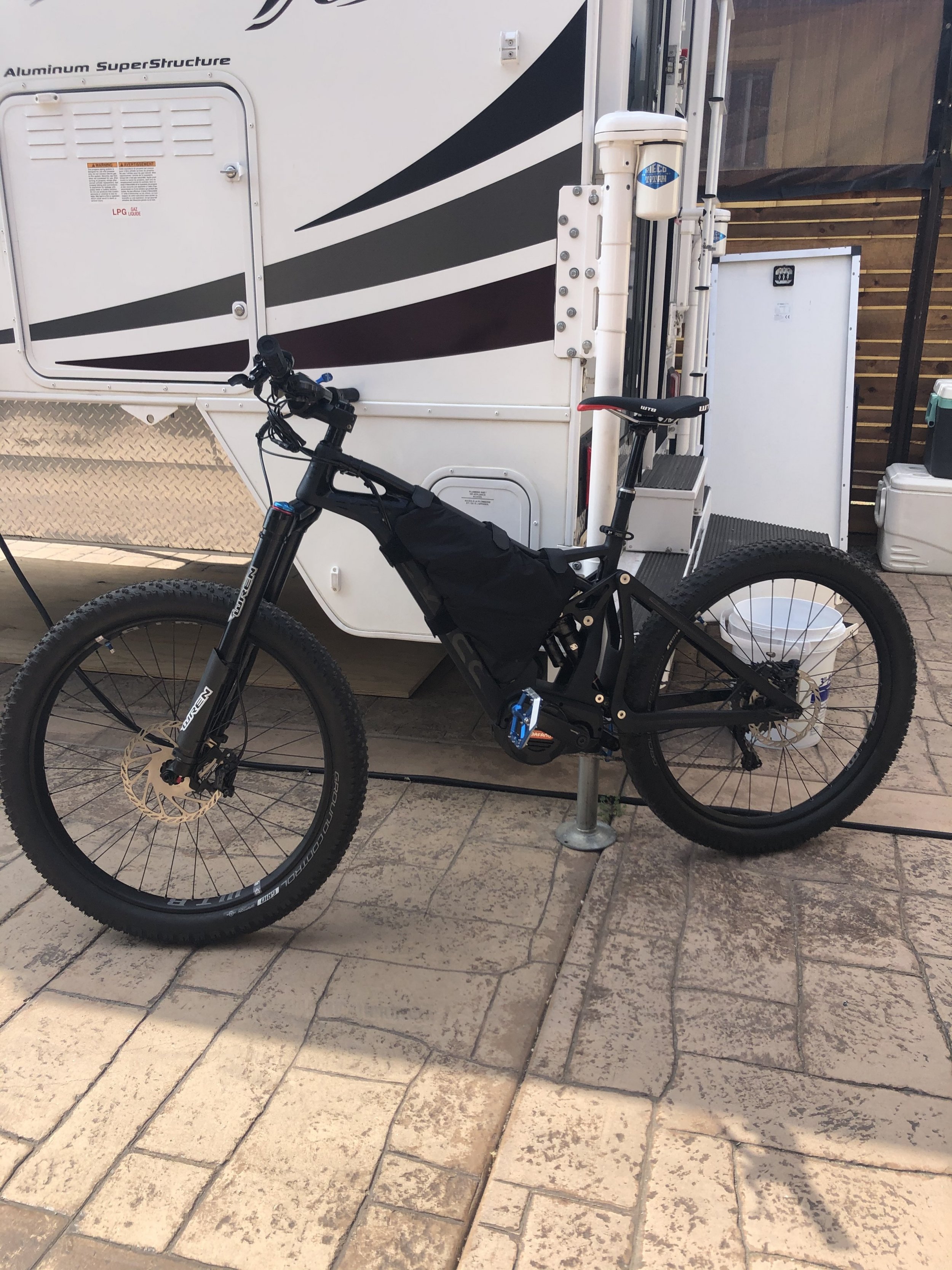

Threw a Fox factory 36 on the front and a rockshox super deluxe ultimate (230x65) on the rear and built up my own battery’s myself as there was ample room inside the main triangle to fit a huge battery.
Started off with a 34.5ahr battery that was heavy as shi_.
Next I made a 24ahr battery which was good for 90% of my riding.
Lastly I made a 30ahr battery using 21700 cells and it works perfect except for the weight.
Comes in at the scale at 65lbs.
I know S-tech out of Germany doesn’t carry this brand anymore a company out of China does, I think they are called fortunecycles if I’m not mistaken.
So how do I know about S-tech you asked?
Well let me tell ya. I have blown apart (2) of the lower pivot links ,( looks like your gen bike only has the upper link), and have had to place a few orders to them as they actually still have some parts to the older models in stock, super nice guys and gals there. Philipp and Annette.
Always had issues of miscellaneous pivot bolts coming loose even after everything is torqued to specs, with RED lock title on the threads.
Finally had to mark every bolt head with a vertical line and then check them before every ride.
Dont get me wrong I have loved this bike but it did have its weaker points.
