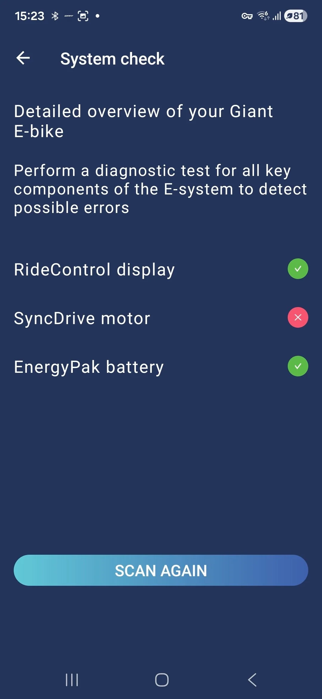

Hi everyone,
I have a Giant Reign E+ 3 (2023 model, 800Wh battery). After connecting a computer, the motor unfortunately burned out.
I ordered and installed a new motor, but the issue is that the system still shows an error after installation.
Could you please advise:
  • Does the new motor need to be paired or programmed with the bike?
  • Is it possible to do this without a dealer? (There is no official dealer in my country.)
I’d really appreciate any help 🙏

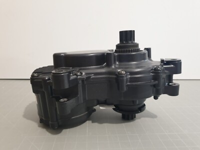

I bought a new motor on eBay (the link is attached in my first message).
When I install this new motor, the bike immediately shows a motor error — the screenshot is also attached in the first post. The motor does not work at all and the error appears right away.
My friend has the exact same bike model. I removed the motor from his bike and installed it on mine, and everything works perfectly with his motor.
So it seems that the issue is specifically with the new motor that I bought.

aah ok, now I understand...I was thinking there was an issue and you decided to buy a new motor as solution. In that case is very clear that the new motor has a problem. Was that motor brand new or it has some use?
No, is not needed to pair or to activate when you install a new motor. It will work directly after installing.
Try to claim that motor to the seller.
I bought a brand new motor (not used or refurbished).
Am I correct in understanding that a new motor does NOT need to be flashed, paired, or activated with dealer equipment before installing it on the bike?
I’m trying to figure out what’s wrong because the motor simply doesn’t work at all. However, if I install a motor from another bike, everything works perfectly.
So it really seems like the issue is with this new motor, but I don’t understand if there’s some required setup step I might be missing.
Correct, new motor doesn't need any activation to work and turn on.
Maybe that motor was damaged, or it get damaged during installation? Just to confirm, can you test that new motor in your friends bike?
