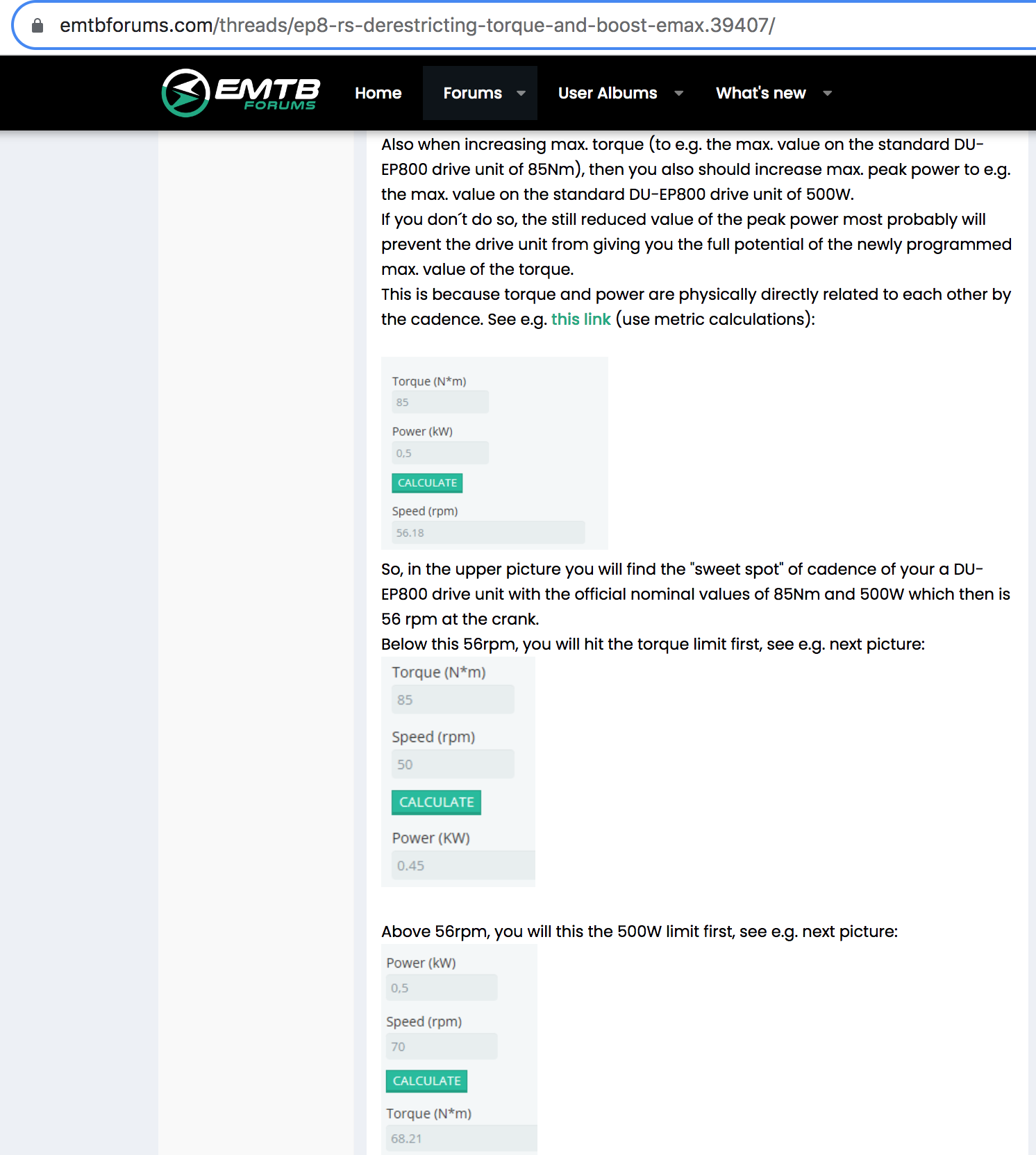

Take care: The display speed adjustment value (in the range of +/- 5%) will not change the real max. motor support speed at all! This value will only adjust the speed on the Shimano bike display, noting less, nothing more.
Also when increasing max. torque (to e.g. the max. value on the standard DU-EP800 drive unit of 85Nm), then you also should increase max. peak power to e.g. the max. value on the standard DU-EP800 drive unit of 500W.
If you don´t do so, the still reduced value of the peak power most probably will prevent the drive unit from giving you the full potential of the newly programmed max. value of the torque.
This is because torque and power are physically directly related to each other by the cadence. See e.g. this link (use metric calculations):
So, in the upper picture you will find the "sweet spot" of cadence of your a DU-EP800 drive unit with the official nominal values of 85Nm and 500W which then is 56 rpm at the crank.
Below this 56rpm, you will hit the torque limit first, see e.g. next picture:
Above 56rpm, you will this the 500W limit first, see e.g. next picture:
So, depending on your cadence on the crank (pedals), either the max. peak power value or the max. torque value is limiting your drive unit.
So, you have to increase both values (torque and max. peak power) of your reduced RS drive unit to the nominal values of the (absolutely identical) DU-EP800 values (85Nm/500W) to get a real benefit.

The speed correction value of +/-5% has nothing to do with the cadence you are riding.
Again, the speed correction value only corrects the indication of the speed value on your Shimano bike display and it does not matter in which gear you are riding or which cadence you are using. Also this value does not change the max. motor support speed of the drive unit or your bike at all and also does not change the behaviour of the drive unit at the programmed max. speed limit.
Second:
If you increase your max. torque on your Orbea to 85Nm however, you are still limiting the max. peak power to 350W, then you will get the full 85Nm which your drive unit in this case is able to deliver only when your cadence is lower than 40rpm at the crank (which is quite low):
If you are riding with a cadence of more than 40rpm (which normally is quite often the case), then you always will hit the 350W limit first which then will prevent the drive unit to give you some more torque (because you already have hit one ot the 2 possible limits of the drive unit, in this case max. peak power of 350W)...
Sure, it also can make sense to get full torque only if you are going really slow with extreme low cadence (e.g. in a sophisticated trial or uphill), but normally such low cadence is not the case on a "normal cummute ride" where you easily use a cadence of 60rpm or more.
So, maybe it is a good idea to keep that simple physics in mind - for me these basics create a very strong confidence towards my bikes.

Hello,
I am a new owner of Orbea Rise 2023, 520W, EP6 RS
Your post about the torque/watt/rpm relationship interests me a lot to best configure my assistance levels. I understand that the max torque can only be reached if the watts are sufficient, and that beyond a certain RPM, the motor will not give more energy according to the Torque/Watts setting ?

Yes, that´s mostly correct. See my previous posts in this thread with all the included information and links. Everything you need to know about this topic is already covered in there. Just take your time and digest. I cannot explain any better than I already did... :)
Also please try not to mix physical names with their units because this easily can lead to misunderstandings.
There is power which is measured in the phyiscal unit W (Watts).
There is energy which is measured in the phyiscal unit Wh (Watts * hours).
There is torque which is measured in the phyiscal unit Nm (Newton * meters).
There is cadence which is measured in the phyiscal unit rpm (rounds per minute).
