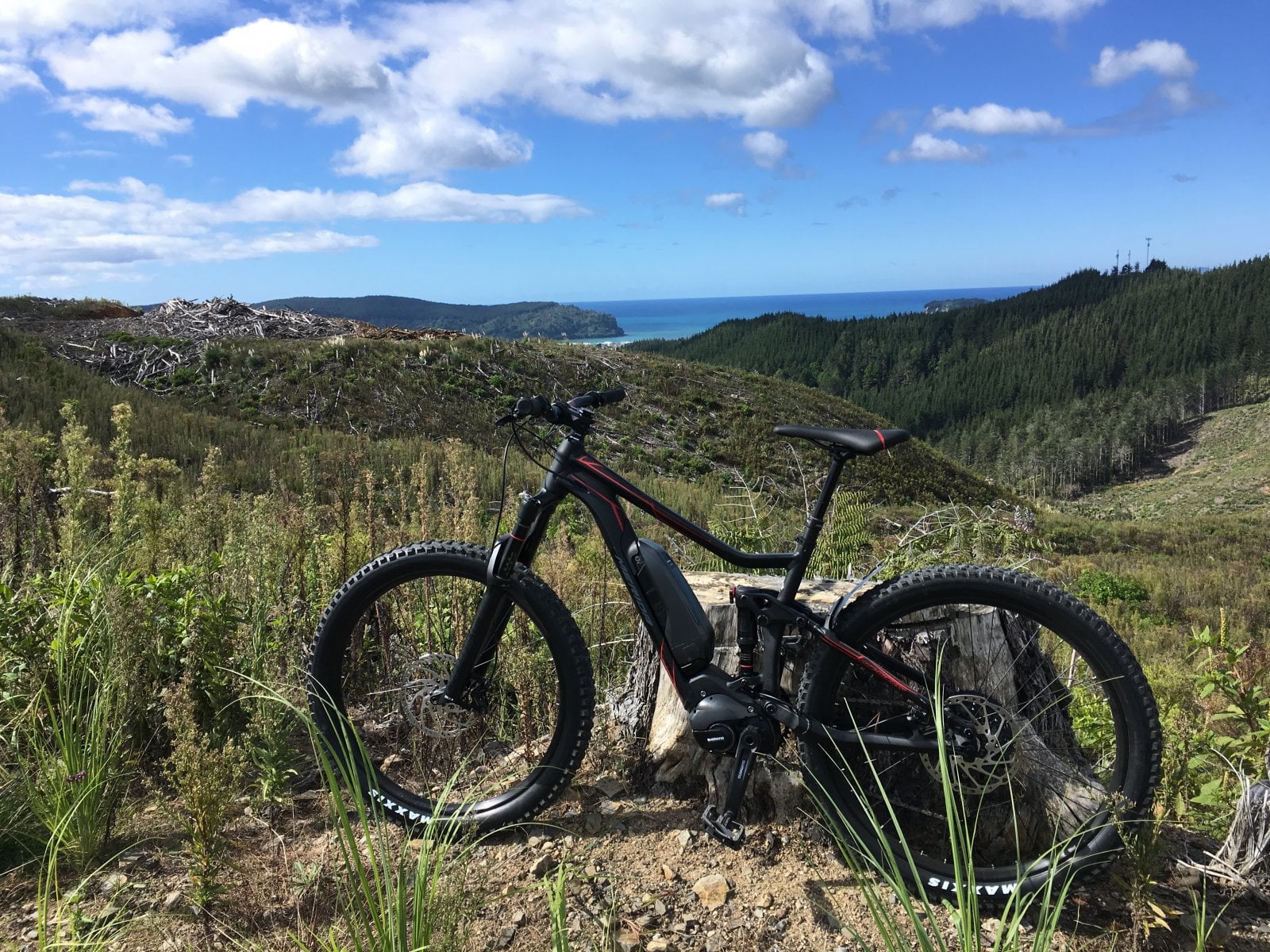

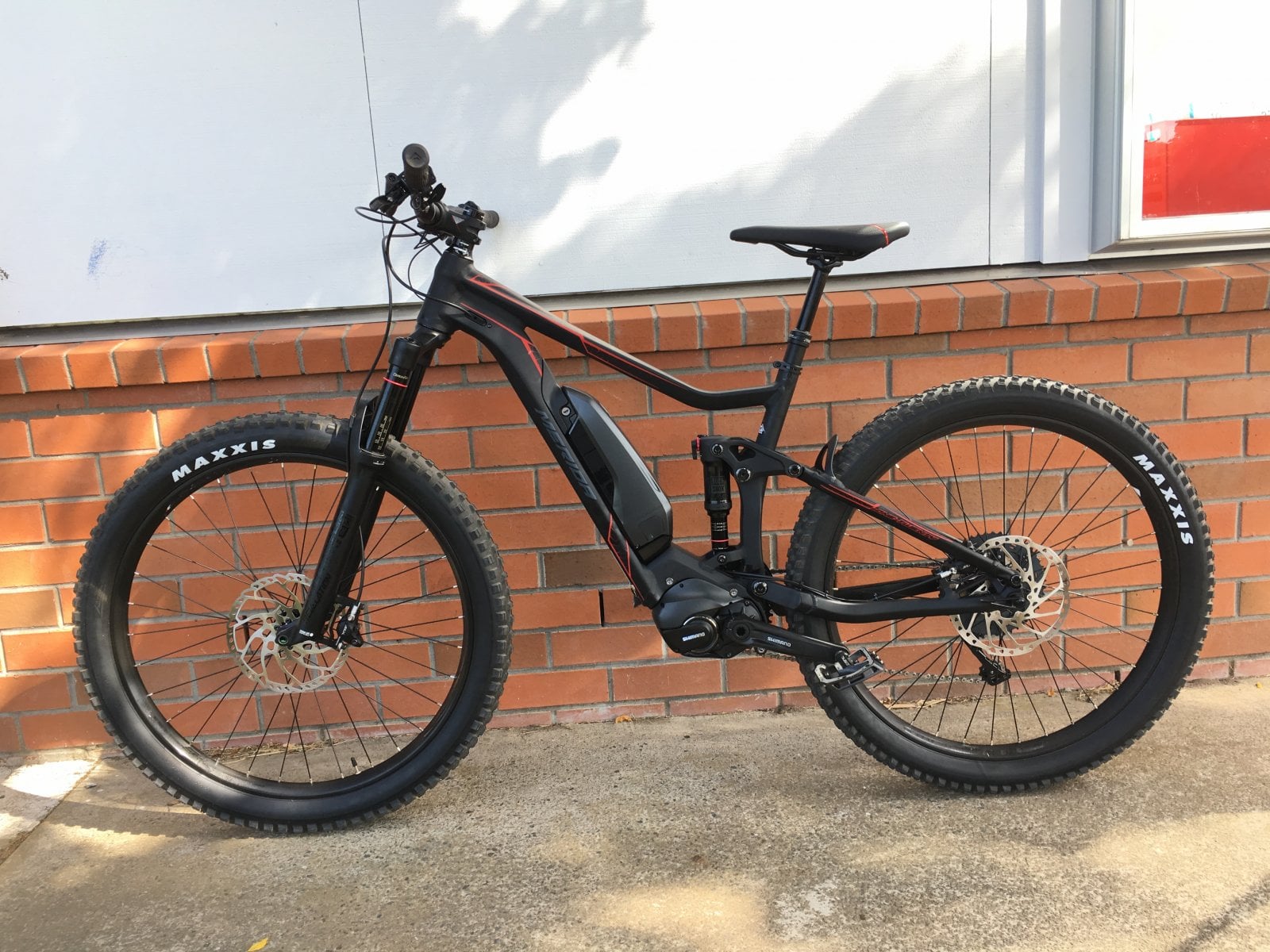

Finally got my new bike home on Friday, however events in Christchurch far out-weighed getting some pics up on the internet.
I had originally ordered a 600 model with the new E7000 shifters and motor, but there was a bit of a delay so I was offered a 2018 800 model which I happily accepted.
I'm glad I did as it was an easy upgrade to a longer fork by adding an air shaft to the revelation and although it has an e8000 motor I got some e7000 shifters installed on both sides with a di2 rear mech.
Went for a short ride with my oldest boy today and was pretty happy with it to say the least!
Cheers.
Did you remove the red stickers from the rims? Ive always wanted to see what that looked like as I keep thinking about doing it myself. Nice ride!
yeah that was the first thing to go! also a couple of stickers on the battery.
it's a little bit more stealth now.
got out for my first decent ride this week - up in the hills of the Coromandel above Whangamata.
can't believe how much fun going up singletrack is! first impressions of the bike are pretty good, didn't notice any need for more rear travel but certainly need to change saddle and grips.
all in all pretty happy with it so far!

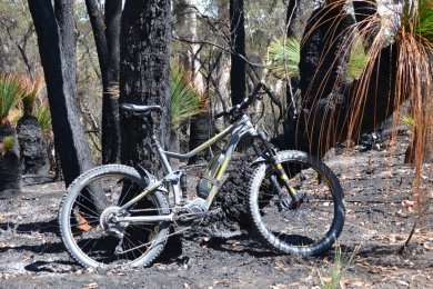

I love my e120 800. It has a 130mm Yari with solo air. I have bought a 140mm debonair air spring .Waiting delivery...has 3000Kms of hard work and going strong. My wife has the same but with Revelation fork. A couple of EMBN shows ago, ep116, my bike got a "SuperNice" ... says it all reallyMerida E120 800.jpg
