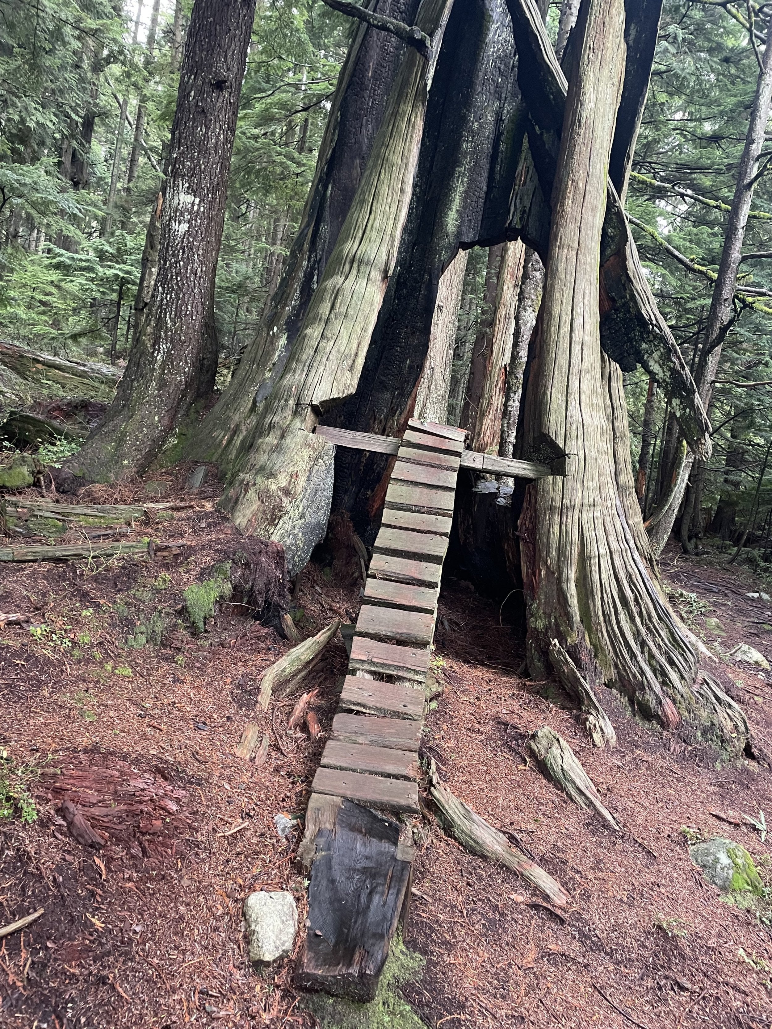

After a few rides in our area I settled on 770mm bar width. There was one particular feature that caused me to choose that size.
For my height I’m probably a knuckle- dragger also. Besides the width, the carbon flex feel and grip size was important on both bikes. Getting the correct geometry was a trial and error experiment until I finally settled on numbers that I won’t forget (I wrote them down 😳).
Now it’s one less thing I worry about but it took a few rides.
