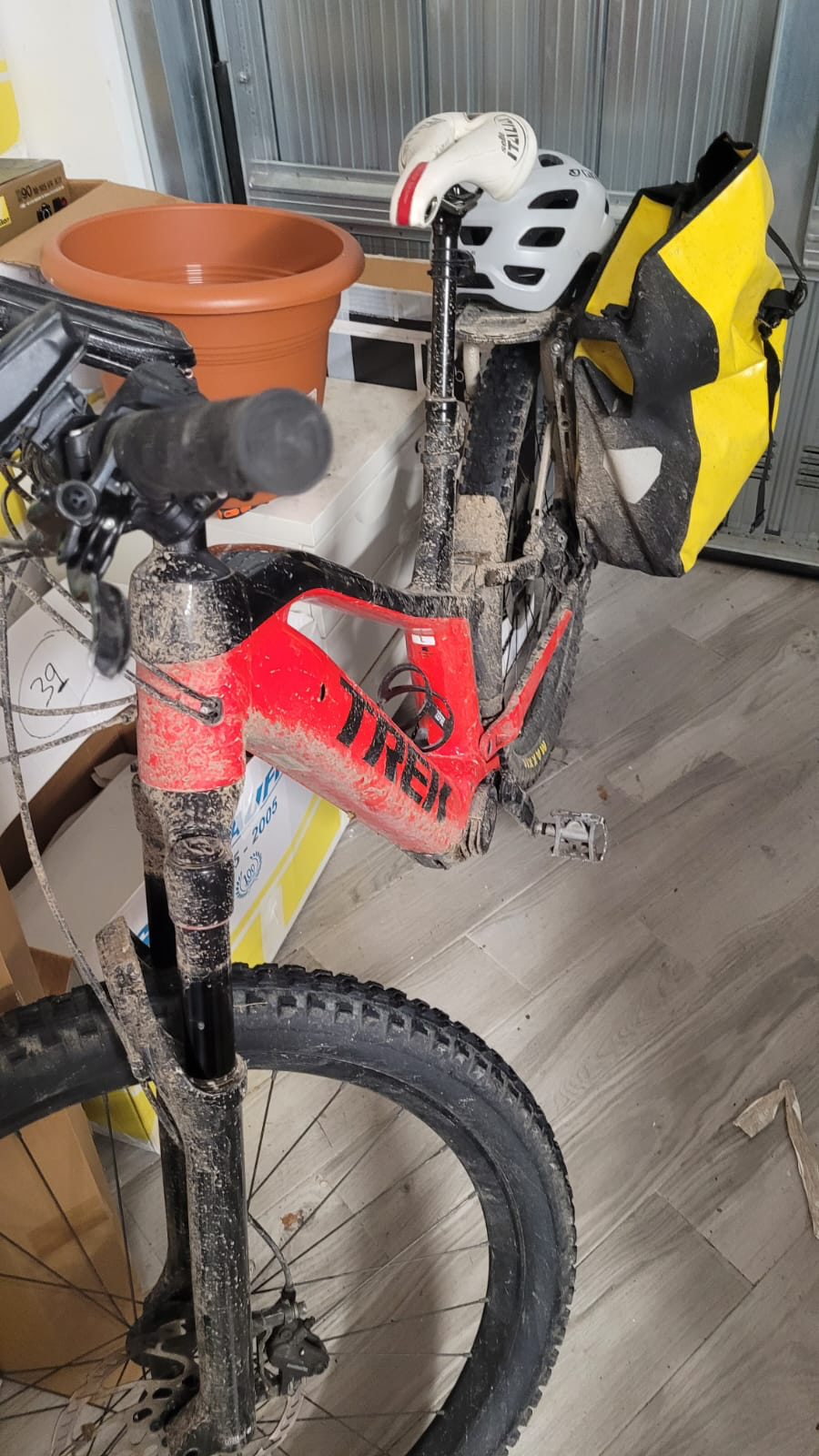

On the forum I often see photos of e-MTBs that look shiny and brand new. Since I moved here, however, every winter ride leaves my Trek as one big lump of mud — sometimes I even have to remove whole chunks by hand from around the mudguards and all the tight spots in the frame. In winter there’s mud everywhere here, to the point that one of the biggest issues off-road is how slippery everything is.
To avoid damaging the electrical components, I don’t want to use a pressure washer, so I stick to a bucket of lukewarm water and a sponge. The result is acceptable, but nothing impressive.
So… how do you manage to keep your bikes so clean???

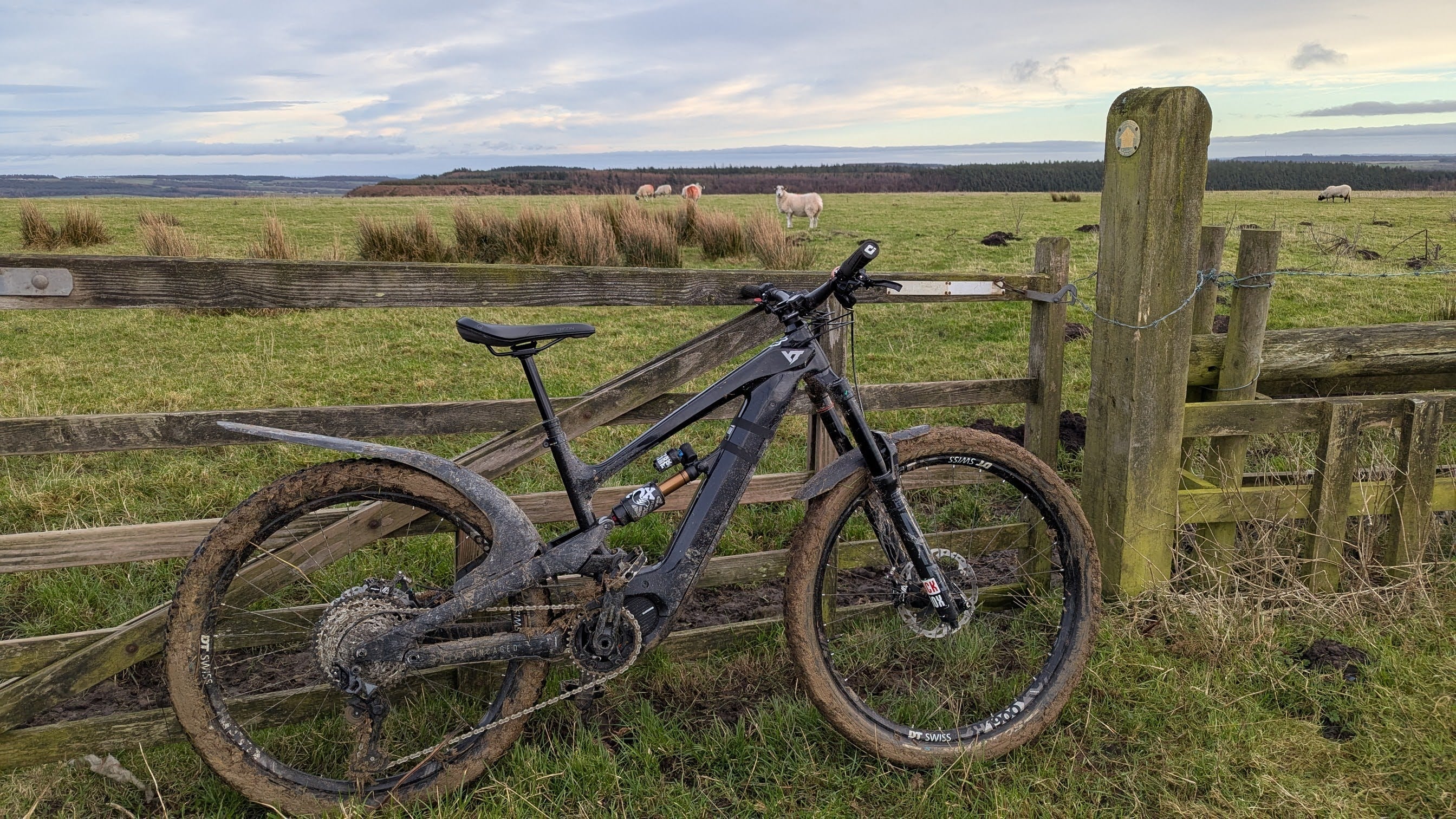

As I've already said, I use a pressure washer (each to their own) but when used sensibly.... and I've never had a problem, the trick is not to go mad and blast close up to the obvious areas. After washing wipe down, blow off the bike if you have a compressor (I do) then spray, with water repelling spray around the key areas ( make sure you thoroughly cover the brakes) first.
Where I ride it's mainly 'water' that's the major issues for me and not so much Mud,
As a mechanic and after a UK winter, I will go over my bike and it will get anything it needs ie new chain any bearings etc etc....if needed, the fact that I can do all the work myself means it's just costing me parts and my labour is free.

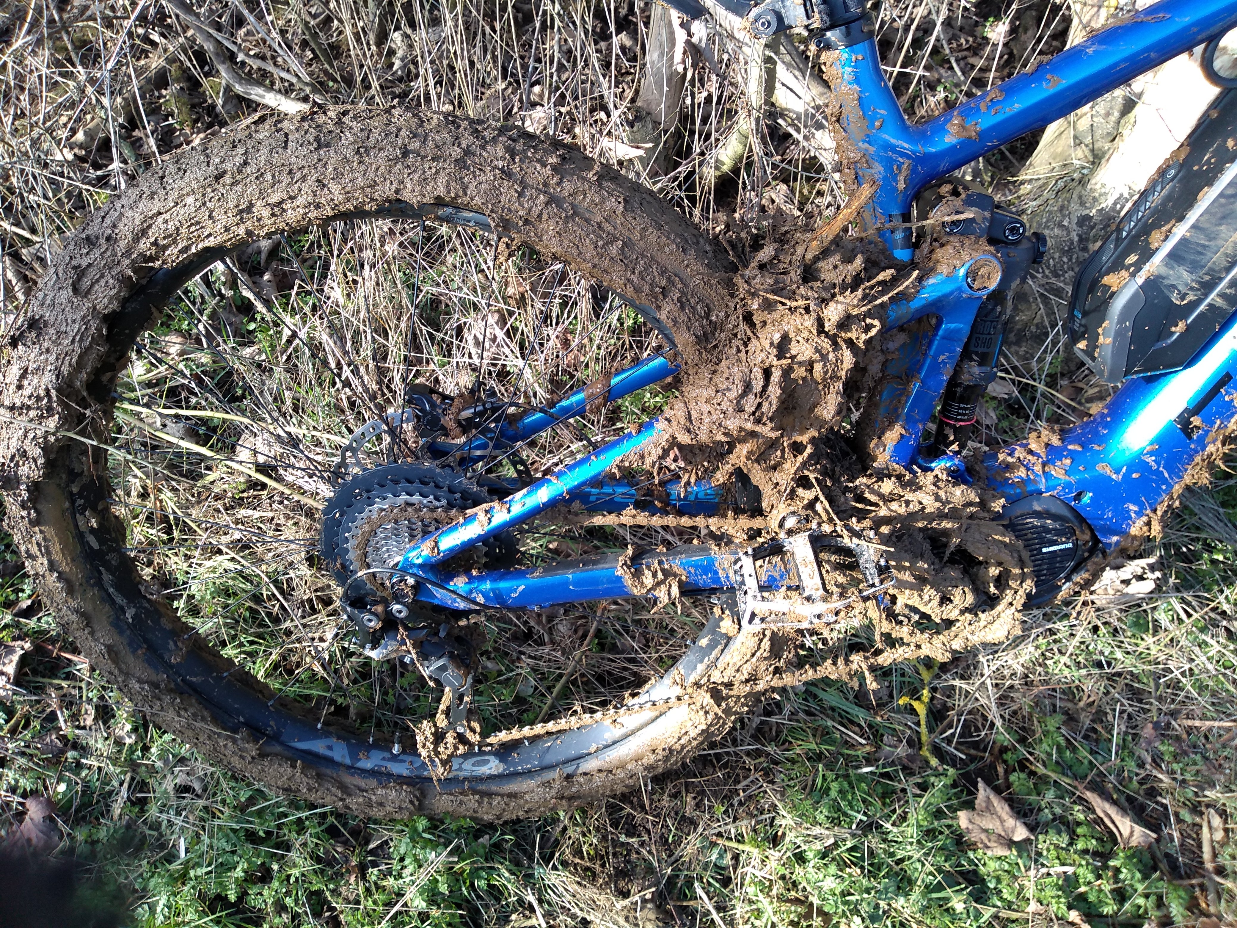

I live in the clay mud areas of Lincolnshire, so I know what mud is (see pic below).
I buy 5-litres of the cheapest non-wax, no-salt, car wash cleaner that I can find from the local motor factor (Halfords near me). It foams up nicely and helps to dissolve the mud, even clay mud.
That mud actually stopped the bike! If I had carried on, the paint would have been abraded from the stays. Using a nearby stick, I cleaned out sufficiently to proceed. I asked a couple of walkers what the trail was like ahead. They told me it was not too bad at all. So I set off again. I had to stop within 200 yards and repeat the cleaning with yet another stick! And this was a sunny day in April in the UK!
