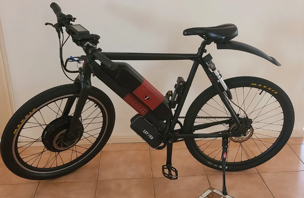

I'm running a belt on my commuter. Sure it's not exposed to the level of abuse that an EMTB is exposed to. But the reason I mention it is just the lack of any maintenance required. Nothing. Just a finger on the belt make sure tension is OK once every couple of months. That's it. It's self cleaning and never needs lubricant. You can hose it off if it gets grubby. But I never have. It just keeps silently working.
