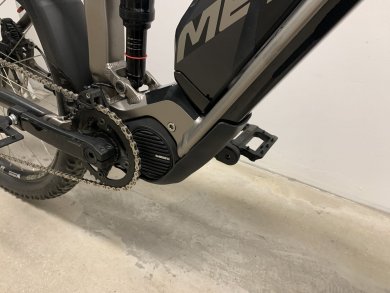

I often ride where there is a lot of loose rocks getting thrown up by the front wheel, I have damage to both sides of my Shimano motor from this and also to the cranks, if the rockguardz was a bit thicker and slightly wider it would probably be ok but as it is I don't think in the long term it will work mainly because I can't see it surviving the rock strikes
So whats the guts on rockguardz motor guard are they ok or not, Ive got a 2020 9000 and they seem to be the only ones I can find. I wonder how they attach...

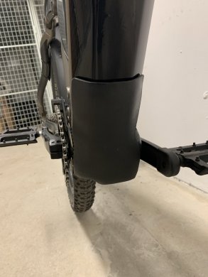

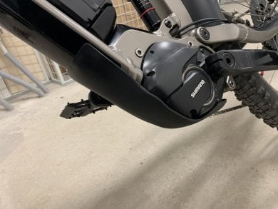

Knocked this up over the weekend. A mate had some leftover 6mm nylon type stuff, so a jigsaw, hairdryer and some heavy duty velcro plus a couple of hours of fiddling and I reckon it turned out ok.
A dozen runs down some rocky trails and it held on like a champ.

Nice job, I've got one of rallysaloons ones on my Merida and yours looks just as good. How have you mounted it at the back under the motor as can't see in the pics. A mate up here in Qld looking for one ATM, any chance you make more and start yourself up a side gig. Otherwise you have been inspirational and might give it a go myself for him, cheers Steve
Just using heavy duty velcro. Sticks like shit to a blanket. Straps just a backup safety really.
Seriously dude, if you can get the material ( still trying to find out exactly what it is. A type of nylon) just make a cardboard template to get the measurements. Cut out and mark out. Vice and a hairdryer. Job done.

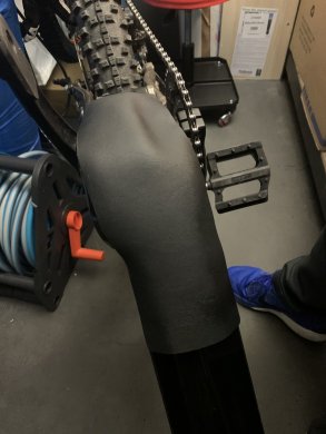

Just popped into my local sign shop, and as Beatn1K said its just an ABS plastic.
Rough size of mine is 400mm x 110mm x 5mm. A whole sheet (2400 x 1200) was only $250, so an offcut should be cheap as. Give it go.
The velcro holds superb too, 63 runs of our local rocky stuff and i still had to pull hard to get it off this morning for measuring.

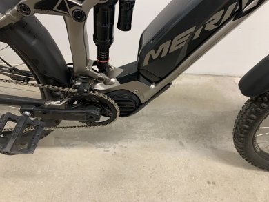

I followed Pinned's design and modified it a bit. Really satisfied with the snug fit and discreet looks. I used 3.2mm Kydex, stronger and more impact resistant than ABS. Also easier to find online. Very easy material to work with. A heat gun makes the job easy. Used heavy duty velcro to attach it to the frame and motor.
