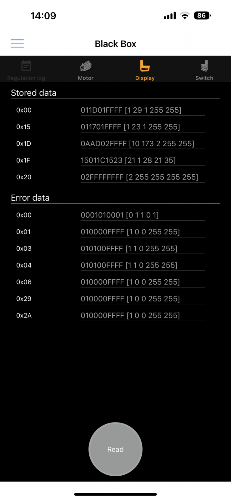

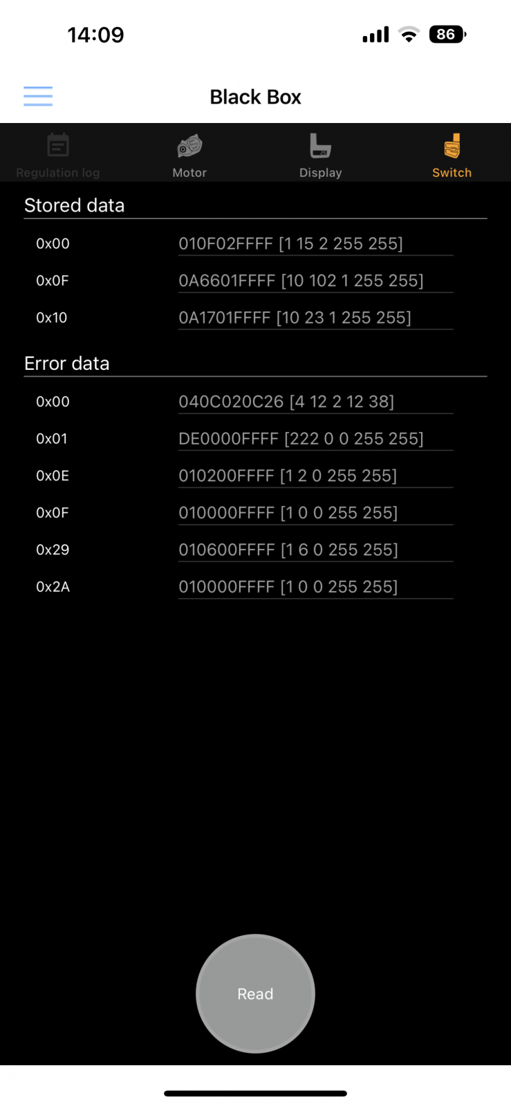

Managed to get it connected to stunlocker and got these error codes. Still stuck on the steps screen.
827996CC-CD5D-44A2-A07B-B62598BB28E5.png C1BCFEAC-EAA1-416B-98F1-AFC3ABF08F38.png
Update…. The battery is the issue, I’m not getting much joy on here but any help would be greatly appreciated. Put my friends Decoy battery in my bike and all is working fine.
