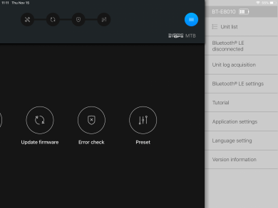

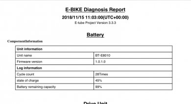

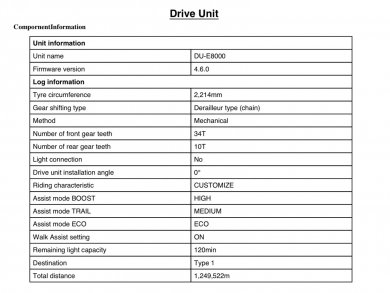

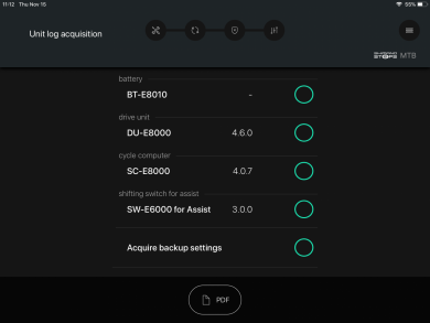

Maybe it's only new to me but today I was playing around with the E-Tube Project app and I found the option to export the system diagnostic report to pdf.
Usually, I connect with my phone but today I tried the tablet and noticed that the tablet version of the app is different it has more functions like "Error check" of all components and "Unit log acquisition". For me, the most needed information is the battery diagnostic - charge cycles and battery health. I'm using two batteries and I want to run them equally and now I can do it. :)
