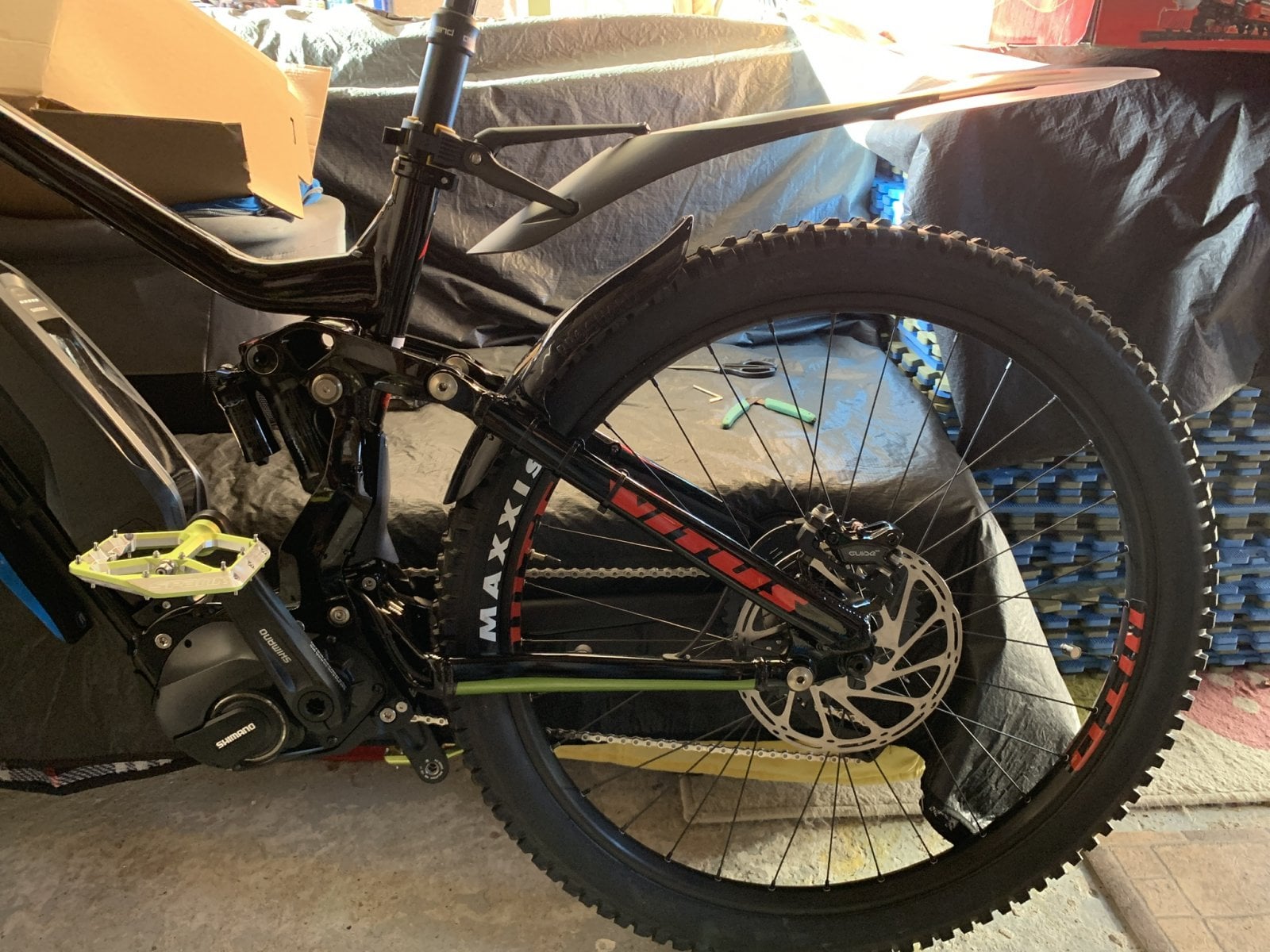

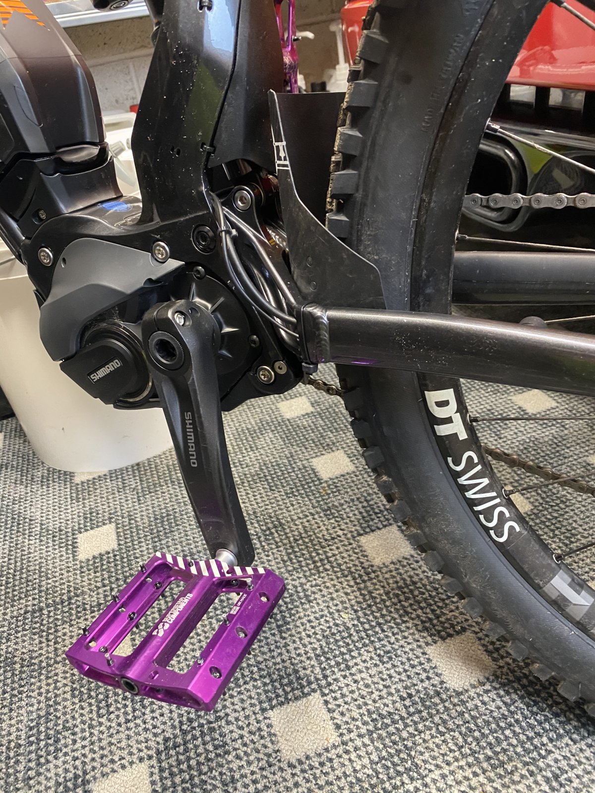

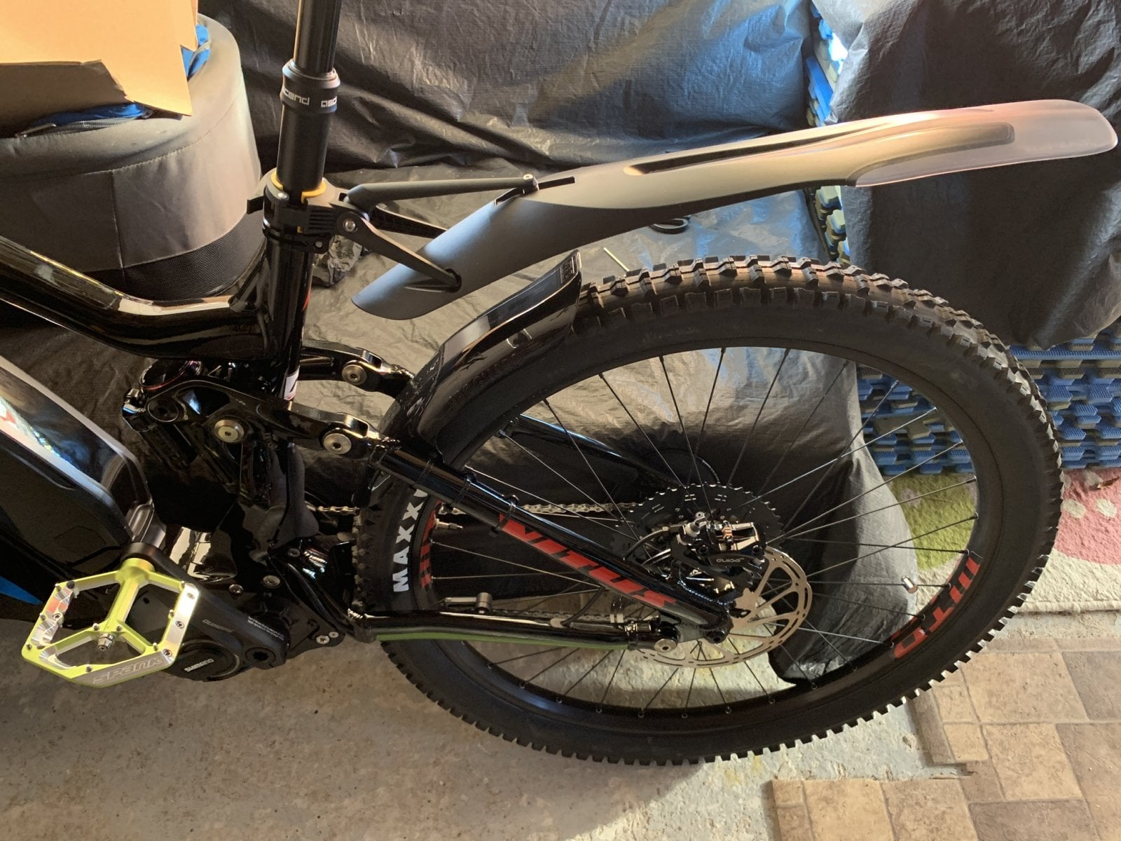

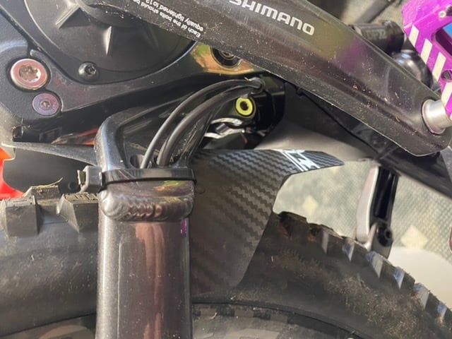

Just thought I would share one of the first mods I have done to my E-Sommet.
After the first couple of rides it was obvious that the top of the motor where all the cables and bottom linkages are located is a real trap for mud, water and grime.
So I purchased some cheap plastic dirt guards Link to Amazon for about £8 that arrived the same day on amazon.
I used the smaller one of the two in package and trimmed and fettled it until it did not foul the chain but still protected the area.
This has really helped with keeping dirt and spray out of the area and should give me more trouble free miles.
Anyway I hope this maybe helps someone else out with less issues and more trouble free fun miles !
Safe riding.
Mark

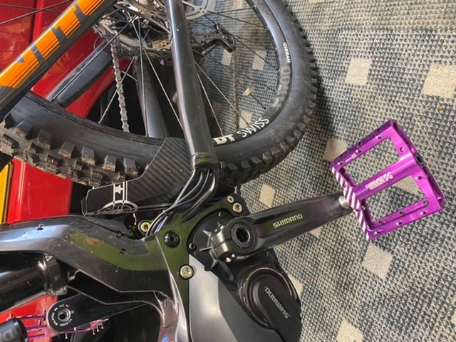

"Nice job @Tc3nitro, and welcome to the forum. The sommet suffers badly from crap in that area, so anything will help keep things cleaner and dryer. For the future, you might want to consider the RRP Pro Front long. It fits really well and significantly reduces crap coming in around the linkage and motor areas compared to other solutions. If you look around the site you'll also see some other recommendations I've made to help protect the motor from the elements. I ride like a well hung circus silverback, so I've wrecked three motors and bring a wealth of experience to this subject" ... :p
I have a long RRP on mine and now a mudhugger as I was finding the RRP wasn’t quite enough to protect me of the bike. Hoping this combo will do the trick.
Mine does double duty as a commuter and use as a full mtb. Have to say I’m not so keen on it swathed in mudguards but for the winter it’s function over aesthetics and if the summer is dry the mudhuggers can come off until the crap returns

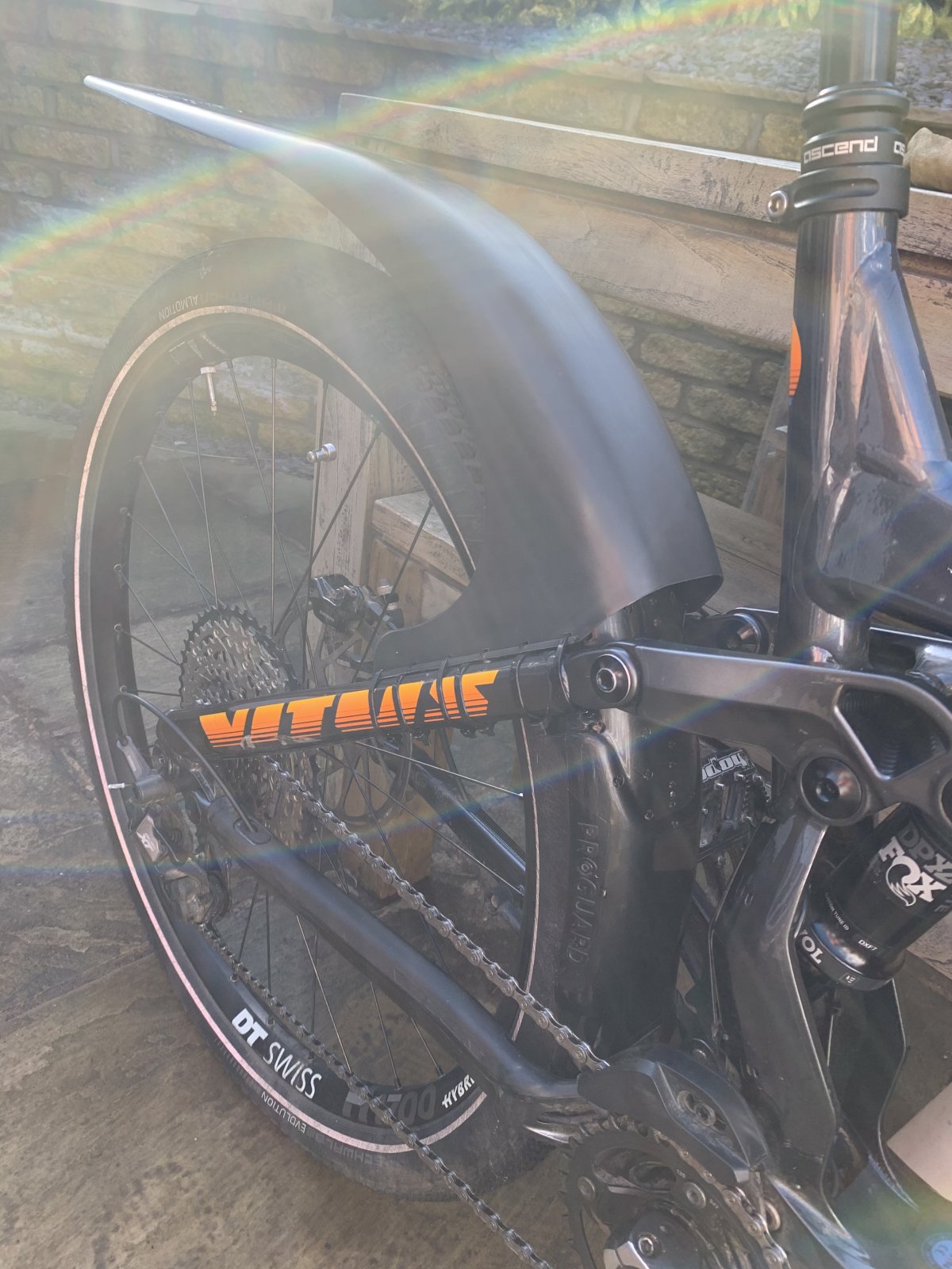

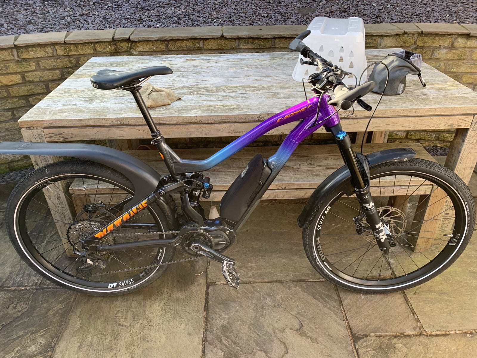

I've pretty much done the same thing only using a topeak defender over the RRP on the rear. All mudgaurds are fugly but I personally hate the design of that mudhugger rear it absolutely murders a half decent looking bike. The quick release seat clamp on the topeak means I can get rid of it sharpish when not needed too.
edit: Pics show a small RRP on the rear but ive since fitted a large front RRP in its place.
I like the set up. Completely with you that the mudhugger is ugly af
