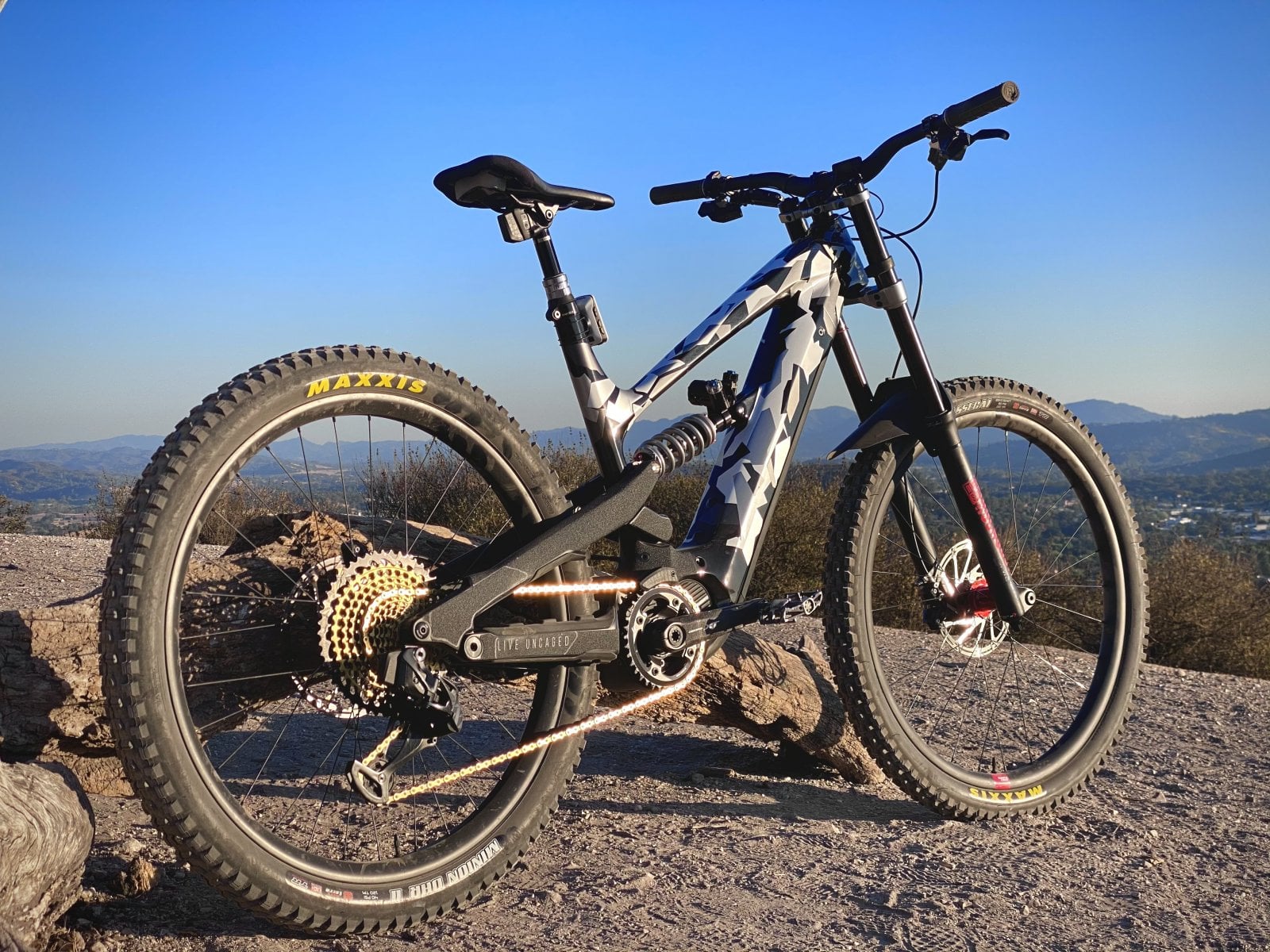

The 3m tape has a sandpaper like texture. Which in turn makes it look like grip tape. I made a template for the decoys, that way it fits just about perfect. I covered just the sides of the motor, crank arms, an the rear triangle on my bike. I covered the entire bike on my buddies Decoy. It looks great and protects the bike better then most of the other frame protections on the market.

I’ve been riding it with the dual crown for at least 6 months now. I’ve ridden lots of double black trails, jump trails, rock gardens, etc. I’ve had a few crashes and so far so good. It rides and climbs better then the fox 38 @170mm fork I had on it prior. My buddies are all on Decoys as well. All riding Zebs @180mm and one of them @190mm. We’ve tested my bike and theirs back to back. The dual crown was better, it just takes a while to get use to having even less steering. Although, the vast majority of the time its not an issue.
Rockshox Boxxer @190mm, 56mm offset, flip chip is in the low position. You can see in the photo, I’ve got the rubber stops set right below the bulge on the frame in the center.

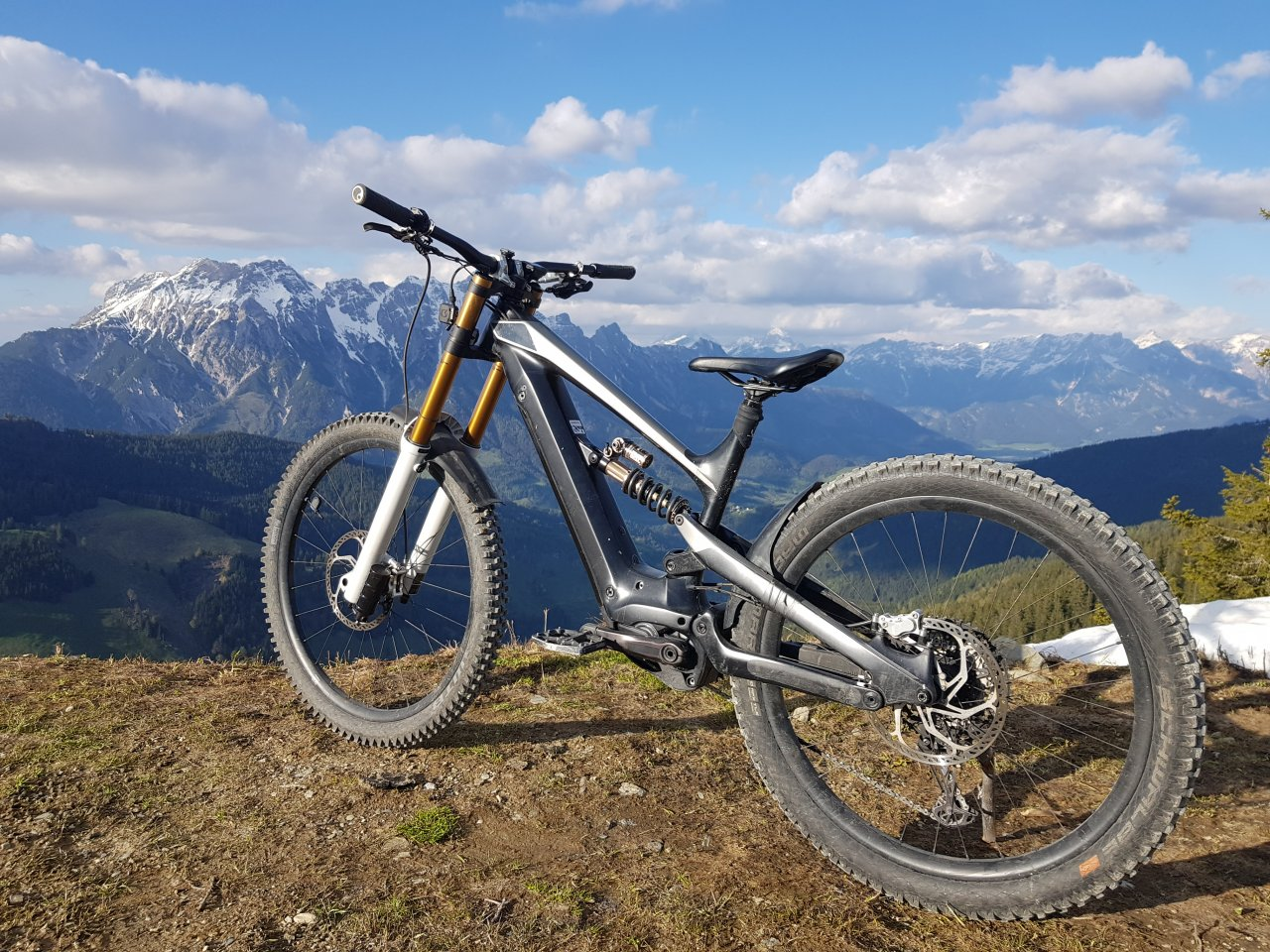

rides so much better in the park with DC, secus, +5mm reach offset headset, 50mm stem, ODI frame/fork bumpers. 52mm rake/offset is perfect.

Soooo sick! Little extra reach would be nice, especially if i could keep my HA the same as it is now with the -1 degree headset and 180 sc fork. How much travel are you running on the 40? Any guessds on what your HA is?

i switched the airshaft to 190mm on the fork. I just measured HA with my cellphone app. it s at 64 degrees. flip chip in high.
Nice! Ive been searching for a deal on a 49 ever since i saw it, and a 20mm front wheel. Bought another 220mm rotor is all so far. Is 5mm the biggest reach adjuster that will fit? I thought there were 8mm adjusters too.

u dont need a new front wheel. e13 front wheels can be converted to 20mm for 20 eur endcaps. given the decoy has zs44/56 the biggest adjustment is only 5mm. best option is superstar components. the one from works has no sealing.
