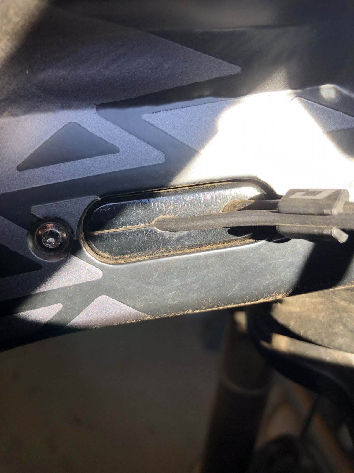

I'm getting rid of the Reverb plunger remote and fitting a Reverb 1x remote. I need to remove the seat post and the hose where it feeds in and out of the frame up towards the headset but it's extremely tight to feed through, any tips on how to do this. I've loosened off the little screw that holds the clamp but it's still a mission to feed the hose through.

You need to completely unscrew the small screw on the picture. Then you can take the clamp out and it'll be a lot easier to get the cable/hose through the frame ;)
Cheers, I found a cool little video on YouTube by Merida and they detail how those smart entry cable clamps work, I would never had figured it out unless I saw the video.
