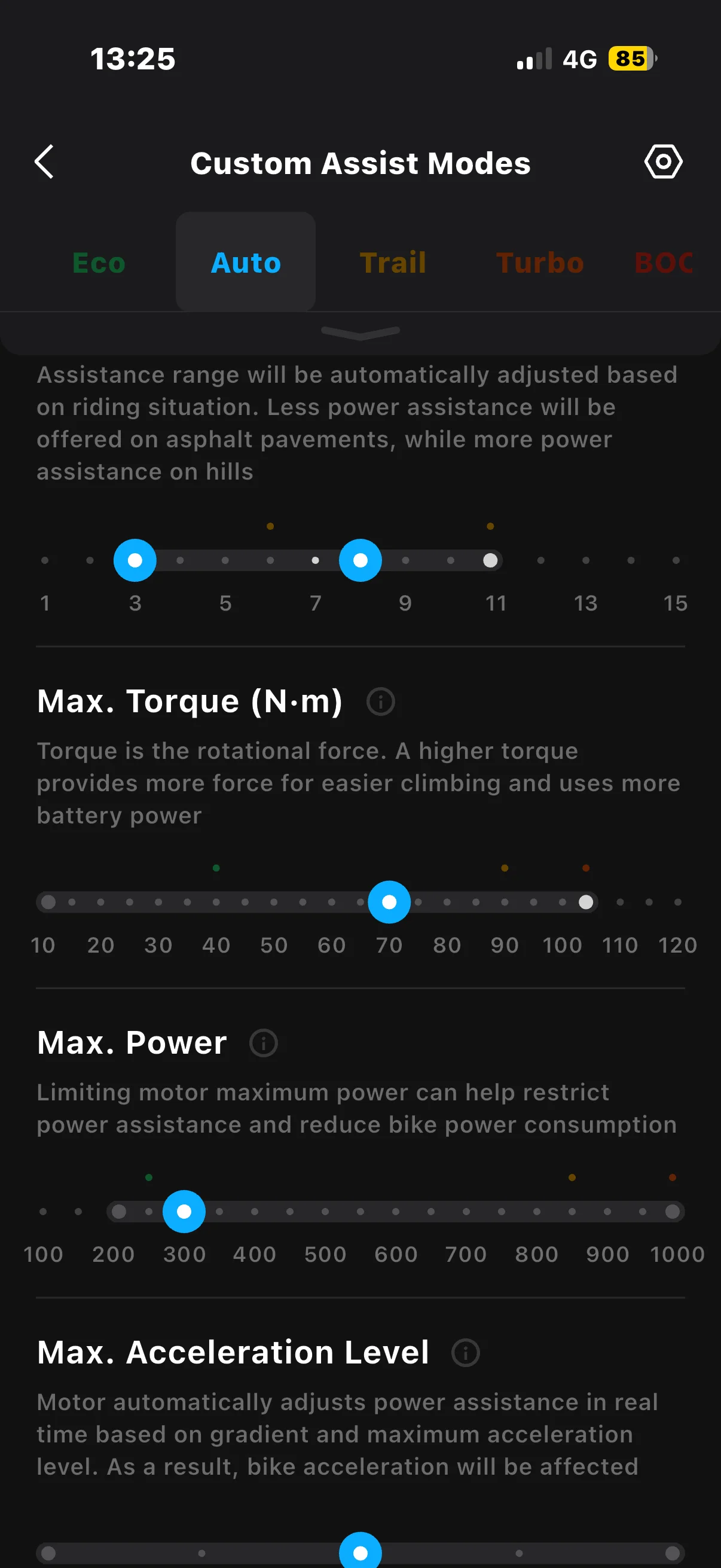

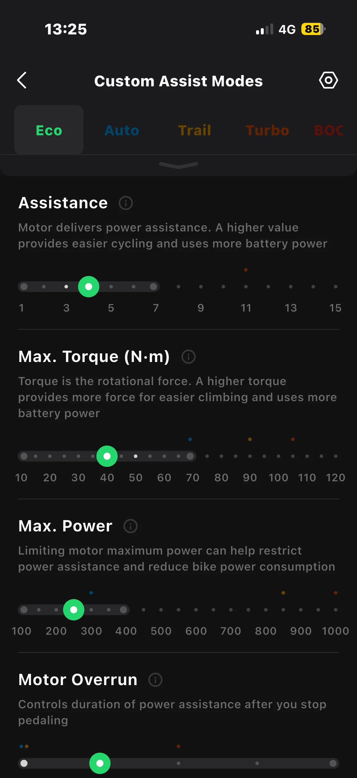

Hi ! Thanks for the feedback. I would definitely appreciate to get more info on the optimal configurations you can advise. For example, I on Eco mode I am running 4 on assistance and 40 on torque. For auto, I have range from 3 to 8 and torque on 70. Max power around 300W. Please see attach print screens of Sbinox settings. Any advice ?

Those settings are a reasonable starting point but there's definitely room to squeeze more range out of them.
Your Eco mode (assistance 4, torque 40) is fairly conservative already, which is good. The torque at 40 is sensible. If you want to push efficiency further, you could try dropping that to 30 and seeing how it feels on your usual terrain. The assistance level of 4 is fine but experiment with 3 on flatter sections.
The Auto mode is where I'd focus your attention. A range of 3-8 is quite wide and 70Nm is on the higher side for an efficiency-focused setup. An Amflow owner I've seen discussed here runs Auto tuned down to 85Nm max and spends 90% of ride time in Eco at 60Nm/350W, saving the higher figures for genuinely technical terrain. Worth borrowing that philosophy. For your Auto, try tightening the range to something like 3-6 and dropping torque to 60-65Nm. The 300W power cap looks sensible.
The bigger range killer on the Avinox platform is often the 1000W ceiling in Turbo modes. @Winford found the battery gets genuinely stressed at 1000W on long climbs, and @Mad_Angler1 noted that on the 800Wh battery it's drawing over 1C burst current which is high for the cell chemistry. If you have a Turbo or Trail mode configured, cap those well below 1000W unless you actually need them.
One thing also worth checking: what terrain are you riding? @Osoares69, the 800Wh system in mixed terrain gives roughly 42km realistically, and in winter cold that drops another 10-15%. If your expectations are based on summer riding figures you've seen online, the gap to reality is partly just February being February rather than anything wrong with your setup.
