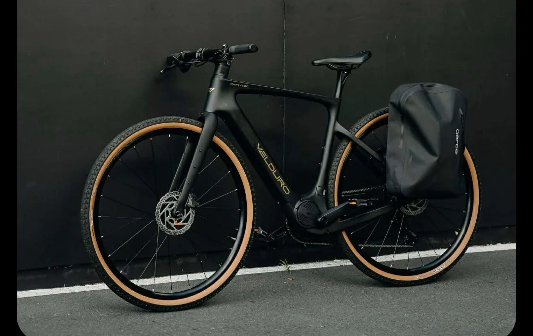

For gravel there's the new Velduro Phantom, though that comes with the latest Avinox motor and is the other end of the scale from low power. It also offers a larger capacity battery than most e-gravel bikes come with. You could just run it at a custom lower power level which is what I'm intending on doing when they can get me one. The frame is also corrected to use a suspension fork which I guess most won't be.

I looked at the phantom but as soon as I read avinox full power, I turned away. I personally don't like what they are doing - I don't need more than 85NM to get me up anything that I have enough technique to get up (on an emtb). and whilst I know they can be de-tuned, I'd rather not carry the weight for that overcapacity around with me, or pay the cost of it. but anyway, thats enough philosophy.... you are entitled to pay your money and take your choice ;-)
suspension corrected is also a puzzling one (what do they actually mean...). Even the Phantom (I just looked ) has an A2C of 395, so that will change angles when you put a suspension fork in, maybe not by enough to matter, but it will change.

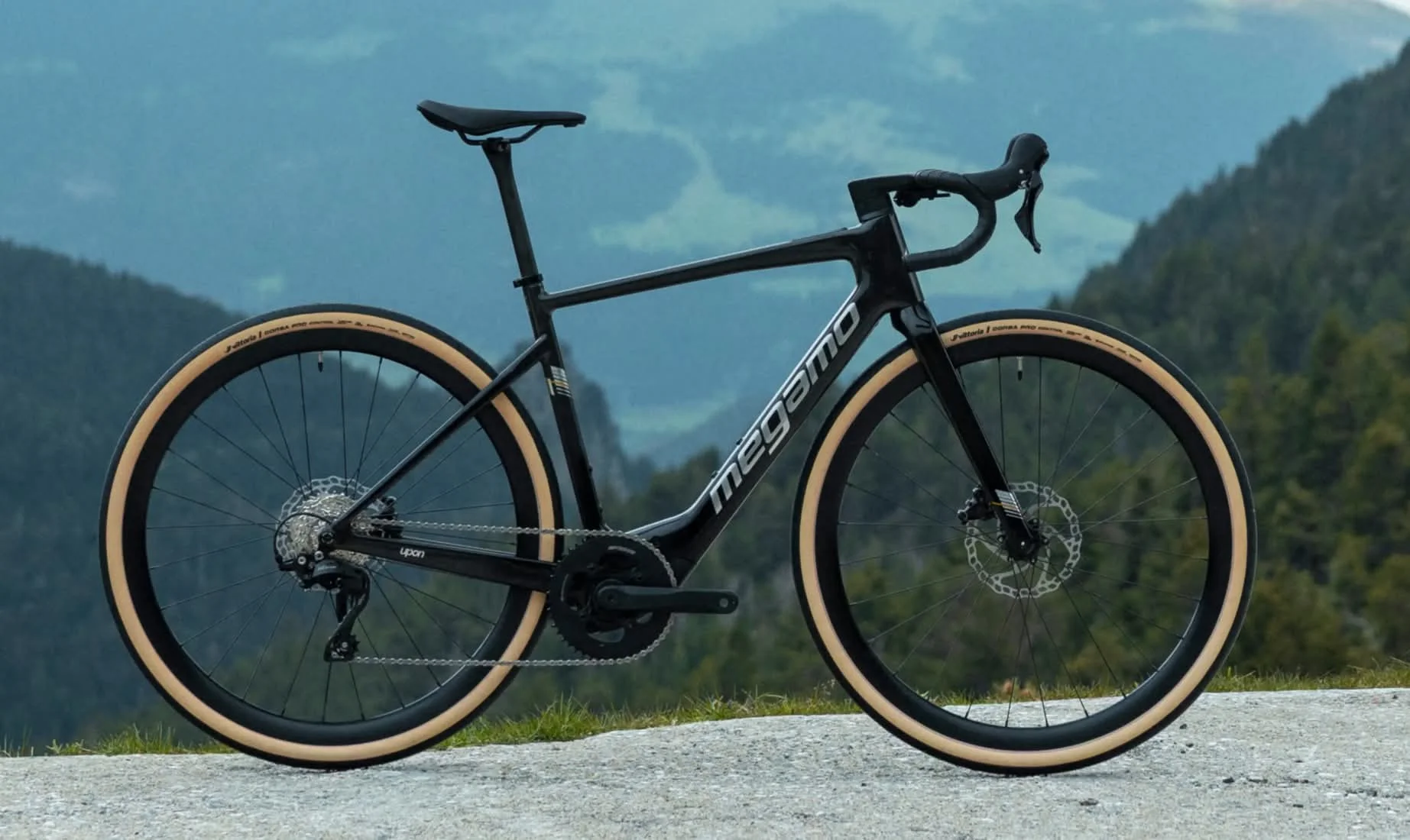

Otherwise if in europe, you have the orbea and megamo bikes.

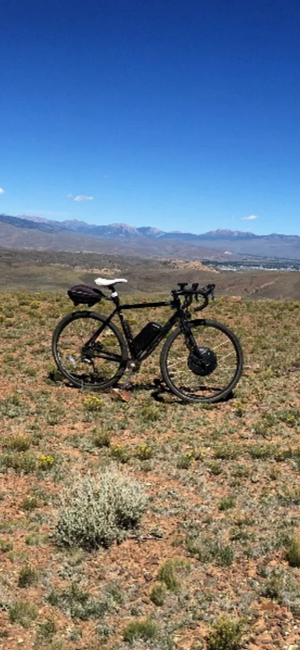

10 yrs ago I built up a Motobecane drop bar alu bike with 40c tires and a front hub motor that I used primarily on dirt roads which today would probably be considered a "gravel bike". Rode it all over the western US, primarily Oregon but pic is at elevation in CO, on all types of terrain including single track. It lacked PAS but with a "cruise control" feature on the throttle it could be set to any watt output and I pedaled away to my hearts content and being a long time cyclist that is what I did.
Eventually a few years later I built up a mid motor eMTB with PAS for more hardcore trail use but kept the drop bar bike for what it did better. I had 0 bad to say about the front hub setup and had many great adventures with it that led to building two more similar ones with some features I felt would enhance the ride.
All the ones I built up had 17.5ah batteries and 1000w motors and Schlumpf cranksets but if I was to make one today I would use a Bafang G311 geared front hub motor and a smaller battery to achieve basically the same thing you are looking for. Not trying to sell you on the concept but it sure worked for me!

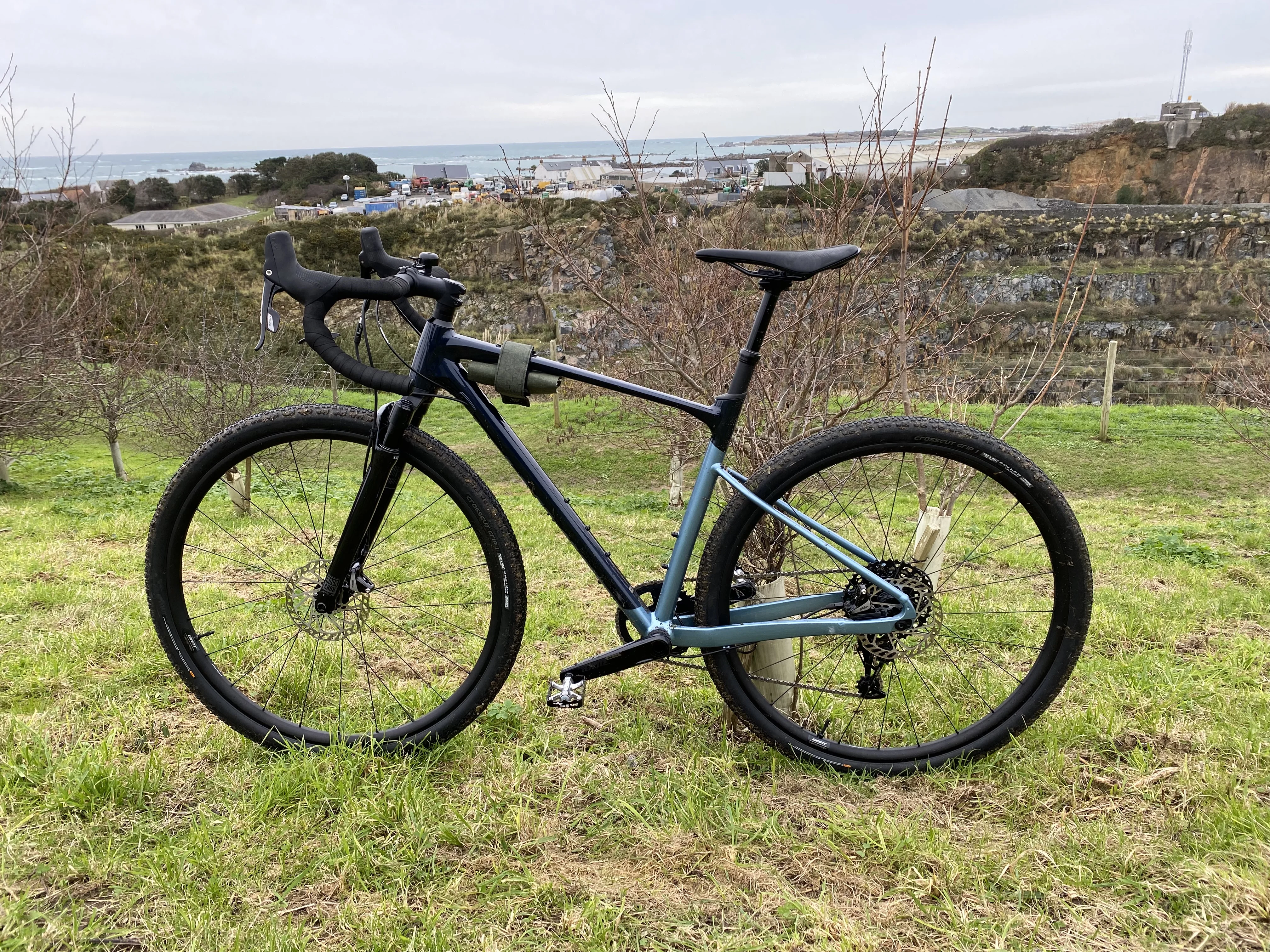

How about Bosch SX and Cube Nuroad/Nulane? I've built my cross bike (or 'flat bar monster gravel' as younger generation would say) by getting my hands on cheap Nuroad frame, motor and battery set. Kitted it out with 40mm Rudy fork, dropper, some custom laced DT Swiss wheels. Result is suprisingly light at 14.5kg but that includes leather seat, fenders, lights, kickstand and heavy MTB stem.
SX is full power class at 60Nm and 600W if you have cadence to spin it around 100rpm. Plenty for my use.
Rudy feels stiff at first but makes a lot of difference. Even more difference comes from going with relatively wide low pressure tubeless tires.
For warm season I've settled on 55mm Schwalbe Thunder Burts. There's clearance to go all the way to 60mm but Rick XC tires I've tried were too tall, hitting fork arch so those would have to be true 28inch tires.

I'd say consider going for it. Straightforward build as everything is standard on Nulane frame. Just strip it down and build everything from scratch. Cube likes to forget to use grease. For one cable run I've taken out the battery but that's my perfectionism, there are other routing channels on the 'wrong' side of the down tube.
One thing I'd change on mine would be going with Shimano Di2 instead of Sram AXS for Bosch eShift integration. I mean I can shift gears just fine but auto downshift when coasting so you're always in correct gear in case of a sudden stop is very handy feature. Bosch reps hinted Sram integration at recent press events but my guess is that this will be for new bikes only.
And if I could afford the cost and still could tolerate drop bars I'd consider Canyon Grizl:ONfly CF Trail. It's very close to my final build but with fancy carbon wheels and full factory warranty.
