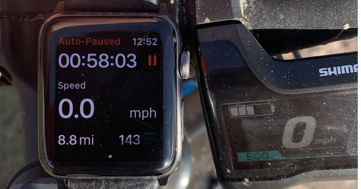

18 or so is average in the Peaks, this is the same ride as the one I posted with my TEC pack, today I used all ECO and the bike performance is about the same as when i did it all in trail mode.
I'm 15 st, had the TEC pack mounted but not used, down to the last bar at the end of the ride.
This shows at the end of the main climb of 8.8 miles to the highest point on Derbyshire Bridge and i've just used two bars.

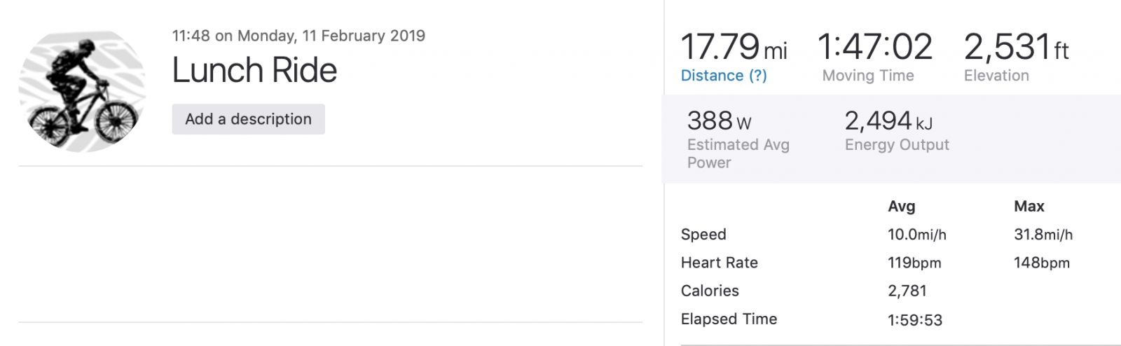

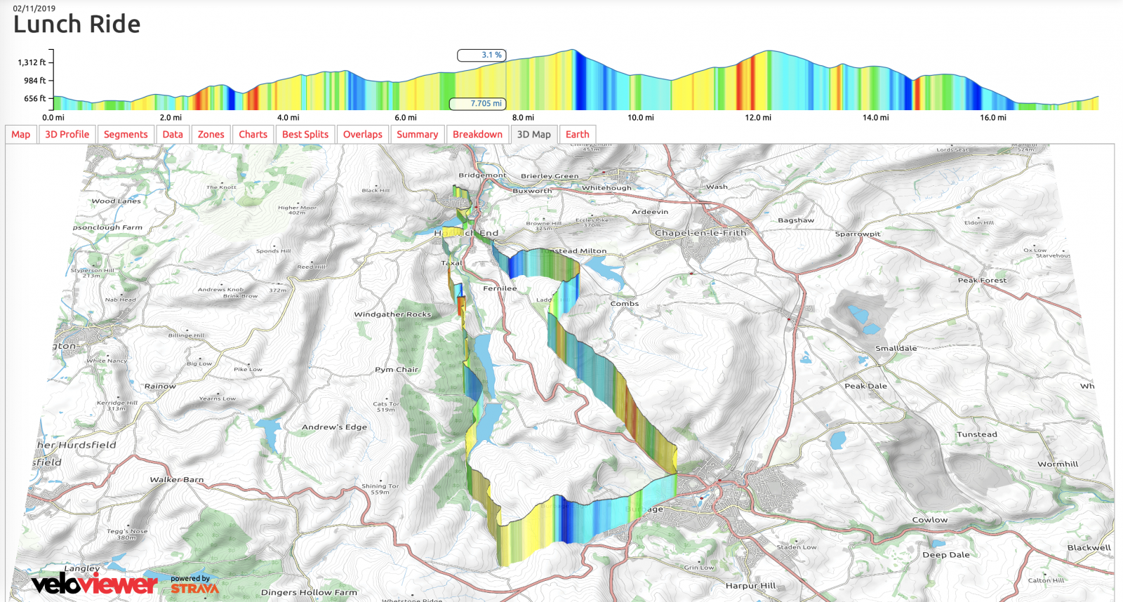

This is the profile of the ride.

20 miles with 1832ft/558M of climbing.
Finished the ride with two bars of battery left and 13 miles of range remaining.
My ride weight was a bit less this time out with just a small hip pack of essentials rather than the 'prepared for anything' fully loaded back pack.
All Eco/off.
BUT, the main difference that I paid close attention to was my cadence.
I've never really made a point of this, but today I rode with the display set in cadence and really put in the effort to make sure that the rate never dropped below the 70/80rpm range.
I realise that all the conditions are different between the two rides, and many factors have an impact on range, but I've come to think that it's the way you ride it that makes the most difference.
Both rides were approx 65% off road.
The difference in power used between the two is huge, in that I finished with approx 40% juice left today.
I'm hoping that by the time summer comes along I'll be getting 35-40 miles!!
