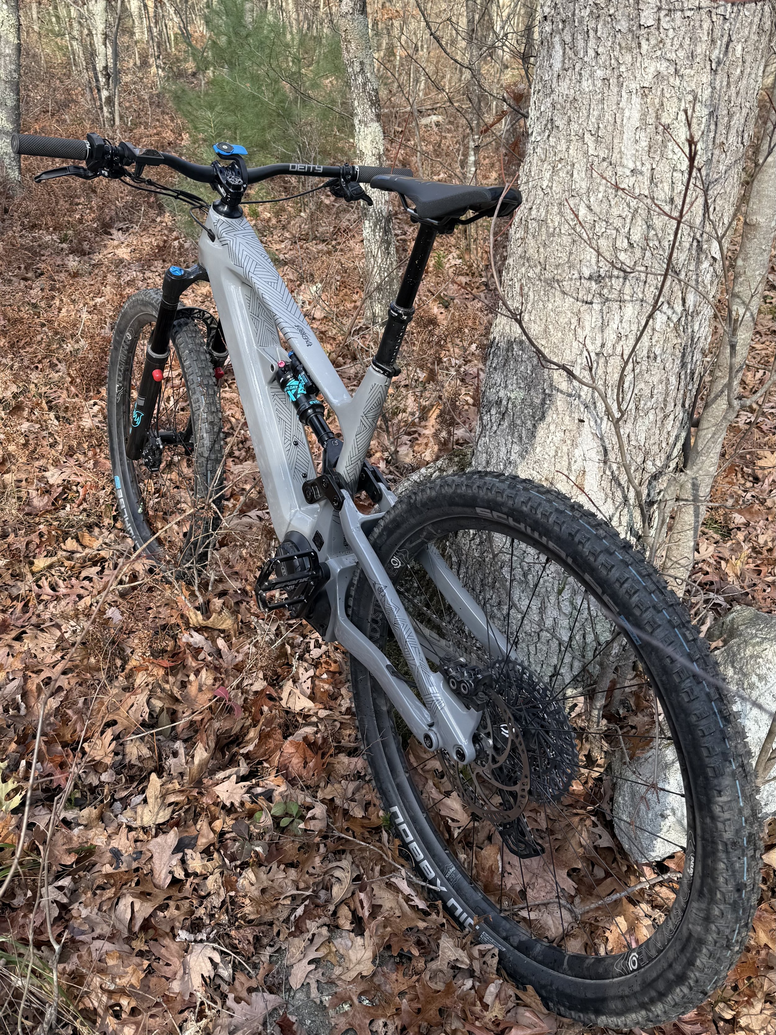

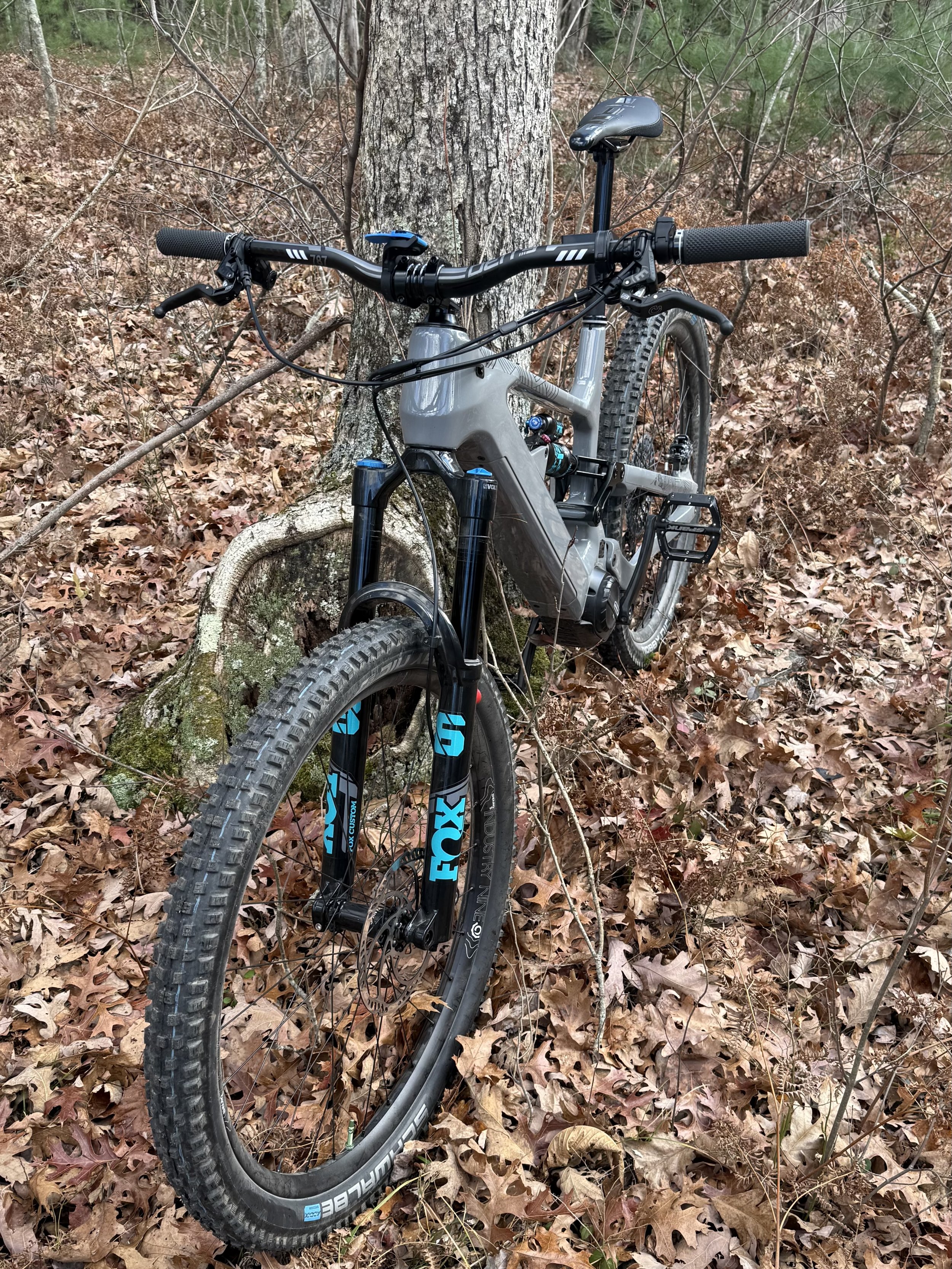

clean build 👍
hope you have a lot of fun with it
i did see one thing tho, you running a speedgrip up front ? i would change that to a supertrail otherwise its going to be slippery when wet...
i used these tires for some years and i also use speedgrip but rear only. even there it feels to slippery when wet.
clean build 👍
They are, yes. These tires should have just been sent back when they arrived in the wrong casing but I just kept them because the retailer gave me a big discount to keep them. Wasn’t the best choice in tread, should have gone with something a little skinnier, and probably the wrong compound.
With the weather here lately wet is the least of my concerns, we’re currently under “severe drought” conditions where I live, and combining that with the immense number of leaves that have fallen in the last few weeks makes for conditions where you can’t even see the ground most places you’re riding. The dry leaves all stacked onto each other is like trying to ride on a bunch of pieces of paper, you just slide right out anywhere you attempt to break with any meaningful force or lean the bike in a turn and usually aren’t able to regain traction either.
I’ve already had the front wash out on me twice where they were layered up real bad. The tire will grab the first layer of leaves of then have the leaves it grabbed onto work like a ski on the 5 layers below.
I plan on replacing the tires with a better suited setup, probably in a 2.4” width at some point. I was reading about the Tannus inserts and they sounded pretty cool. You get many of the benefits of both tubeless and tube setups in one, and it often ends up being a bit lighter than a CushCore setup due to not having sealant or needing to run as thick of a casing tire.

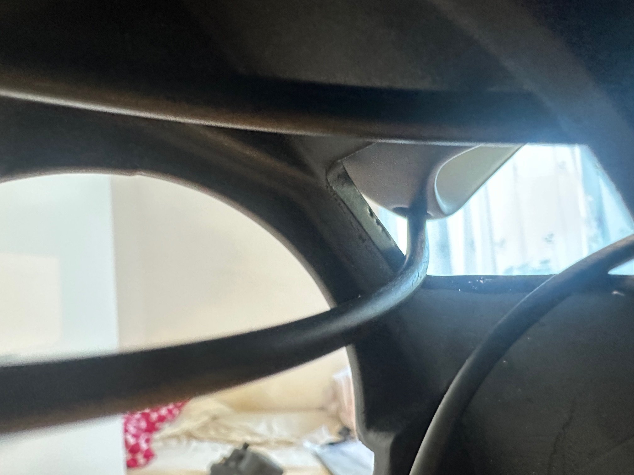

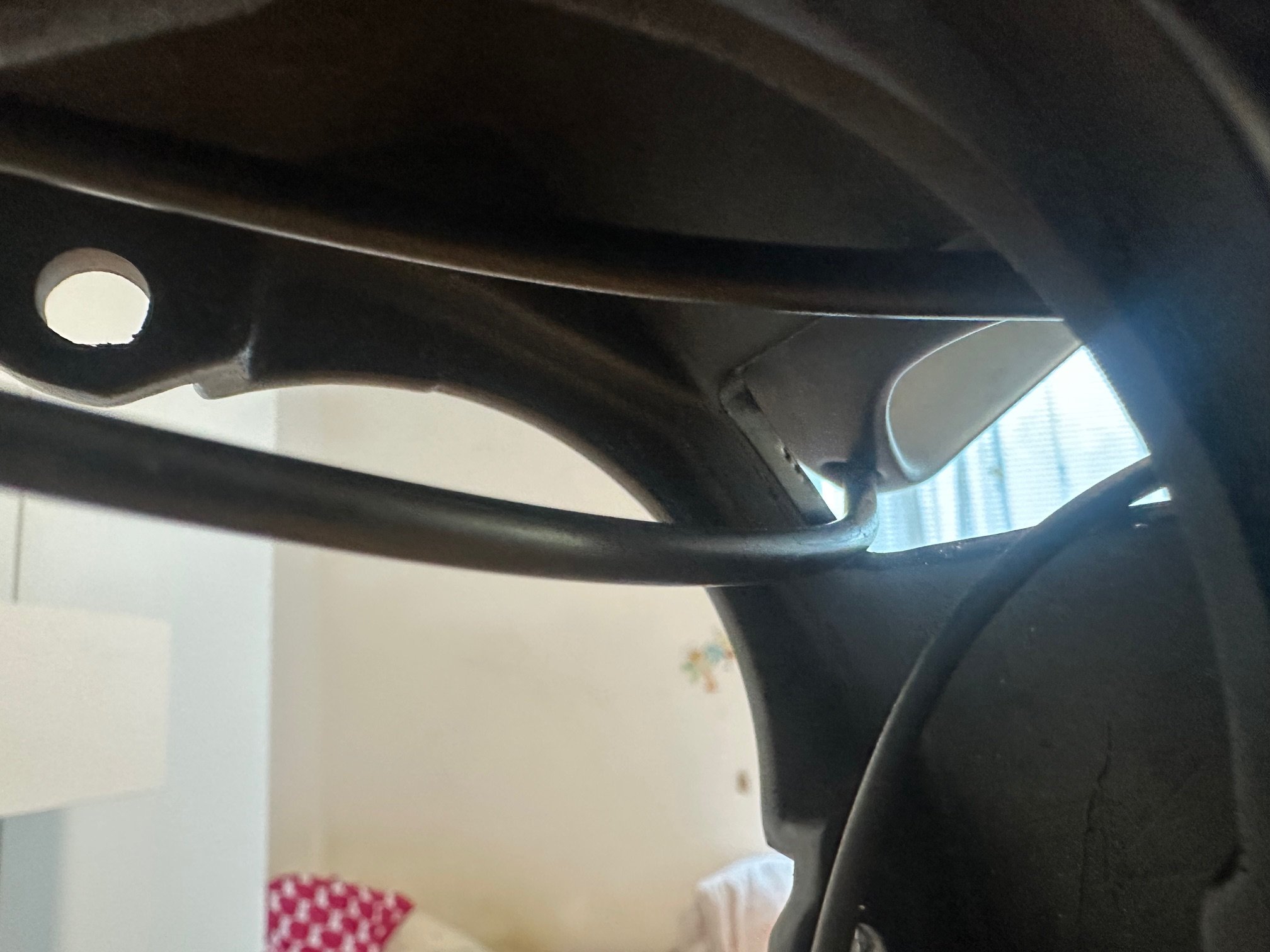

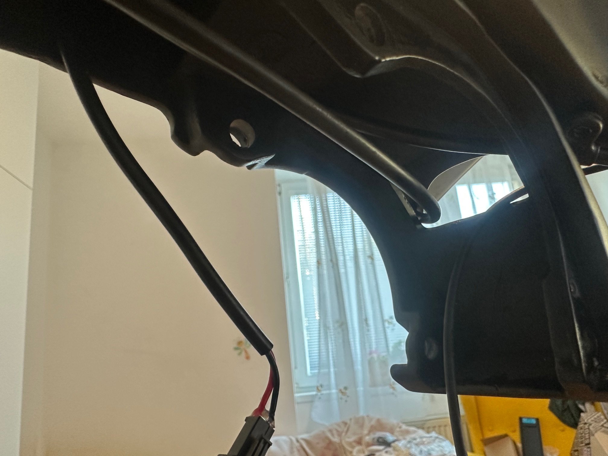

But now I have an issue routing shifter cable. I think it's pretty bad design by dengfu since shifter cable is going through opening on the back of the motor to the tiny chain stay hole at bottom. I'm pretty sure it will rub the frame there, photo attached. Any idea what to do there ? I know you are wireless but anyways idea or maybe someone else.
