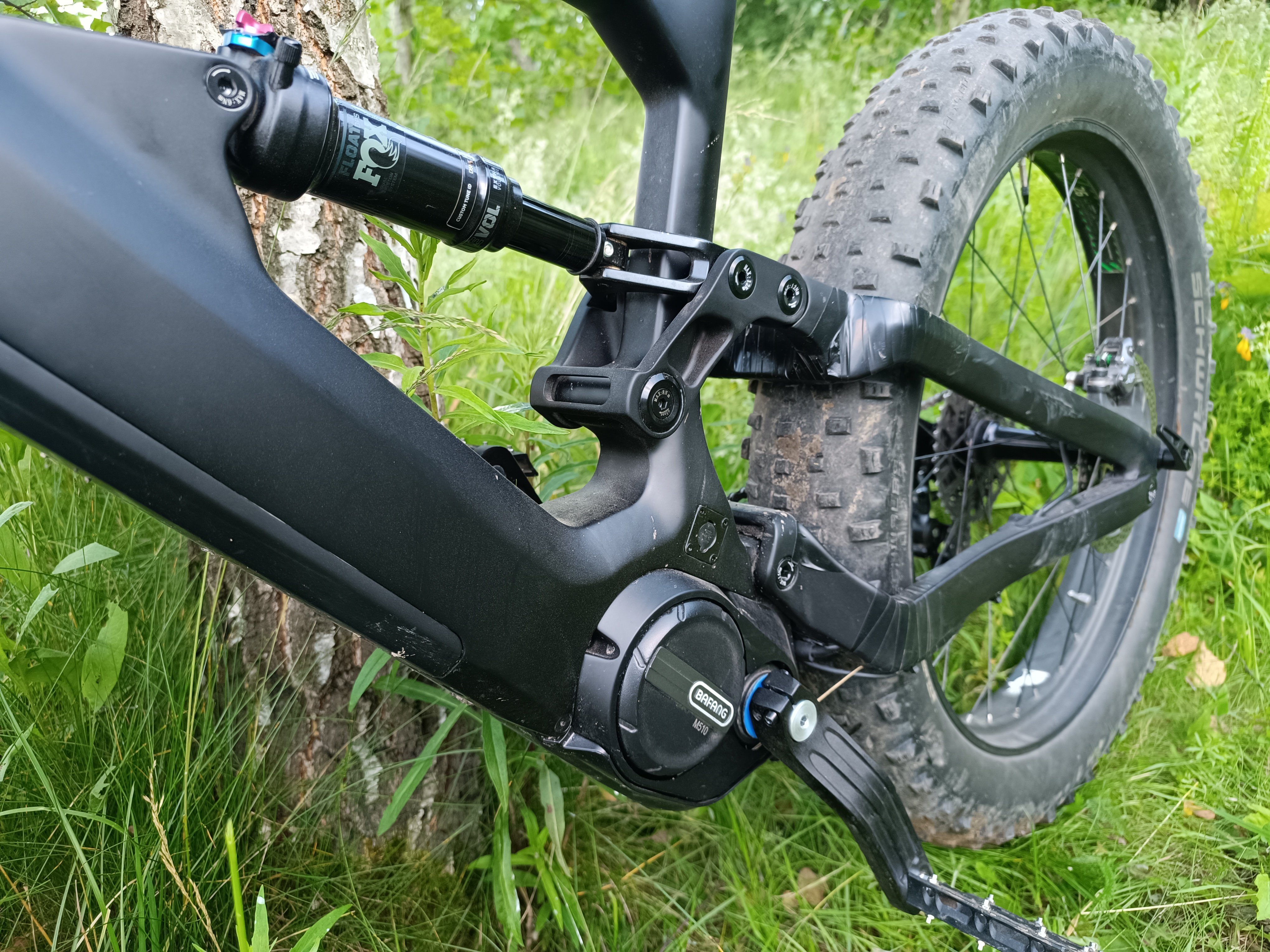

Just connect Mia from Dengfu to buy an E10 front triangle (M510 motor mount) and an E23 rear triangle (fatbike 26" 4.8 tire fit).
Mia said "there could be problems with the cranks and the front chainring".
Problems didn't bother me and the order was placed.
Assembly:
After some time, I received a parcel with a frame in the configuration as I asked for, fully assembled (E10 29" was also fully assembled), and I only checked the torque with a dynamo-meter.

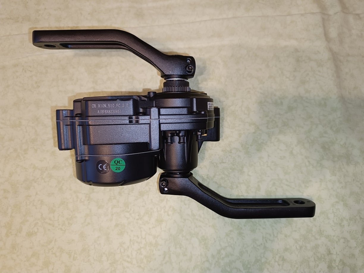

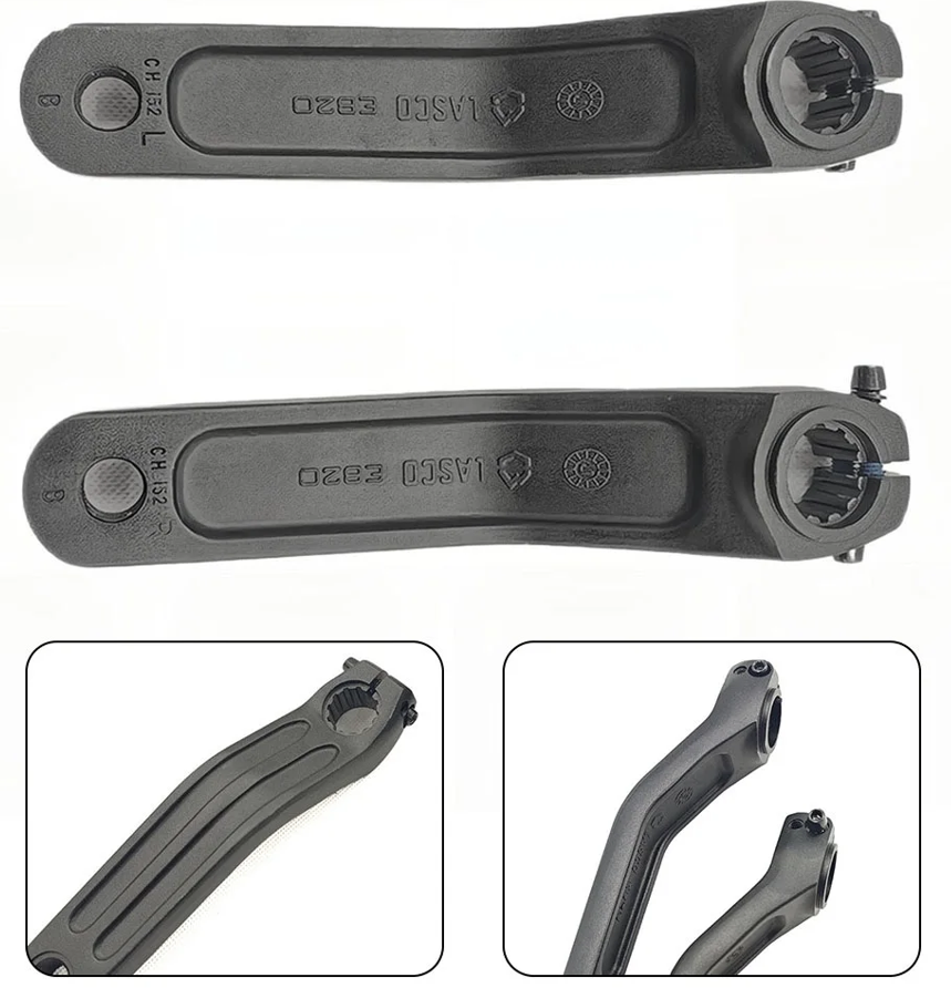

Cranks:
So, when you install a motor, you may notice that regular Bafang cranksets do not fit. The easy solution was to go to AliExpress and buy special fatbike cranks for the M510 motor. The price was low.
Aliexpress lot link
Name of lot: Electric Bicycle Cranks 152mm Left Right Aluminum Alloy Crank Arms For Bafang BBS Midmotor M500 M600 M510 M560 M800 Ebike Parts
If Q-factor is a concern, you should not ride a fatbike. Q-Factor with a 26" x 4.8 tire cannot be small, but your boots are not small either in winter. The length of 152mm - I think it is not comfortable, but I tried cranks on a 29" bike and they were great. You cannot power like on a 170mm, but you have a motor; however, any terrain, including stones, is easier to ride with more clearance. After only one ride, you will not notice its length. (I made 152mm cranks for a regular 29", by cutting standard Bafang cranks, and I am now riding them.)

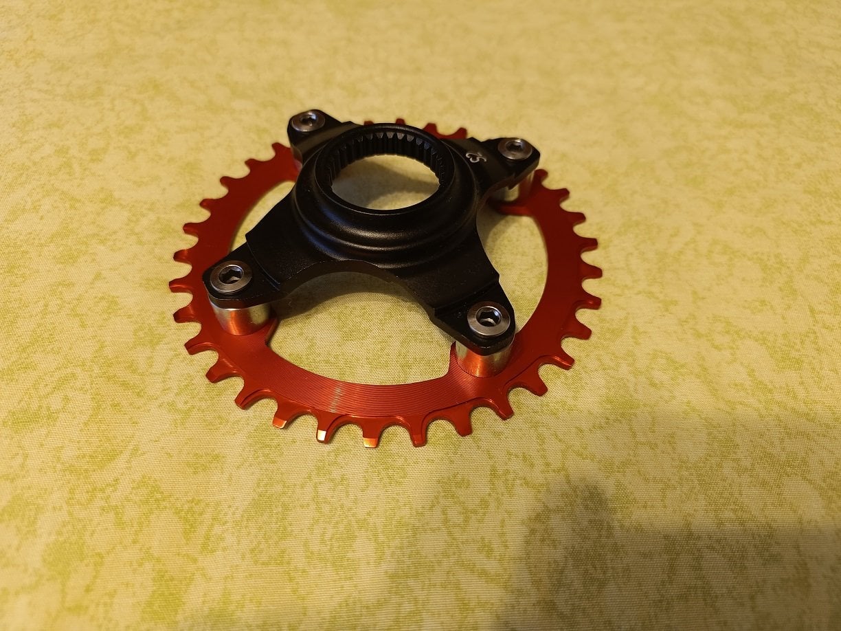

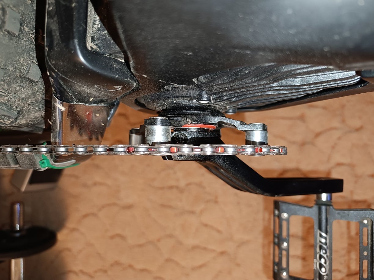

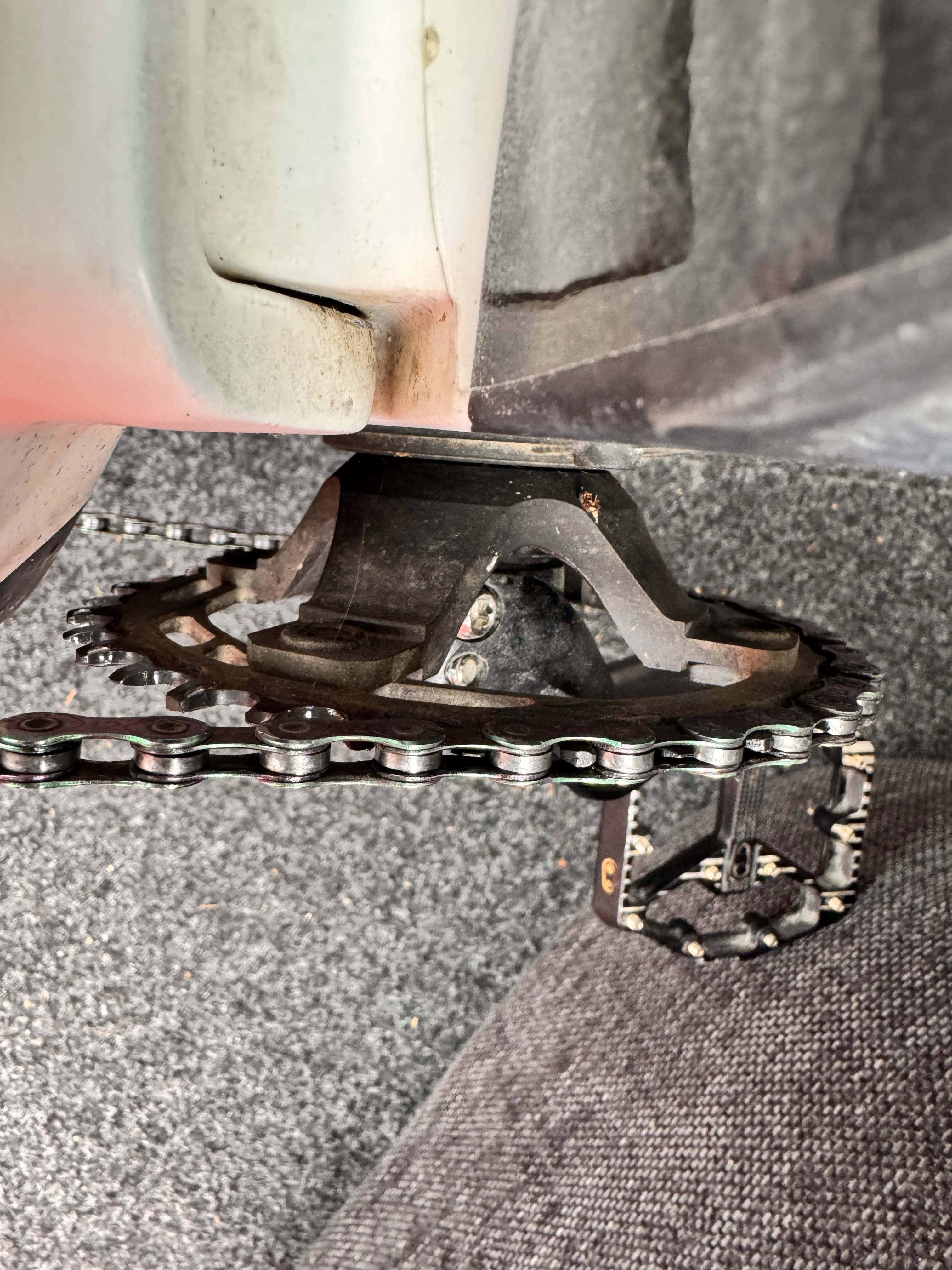

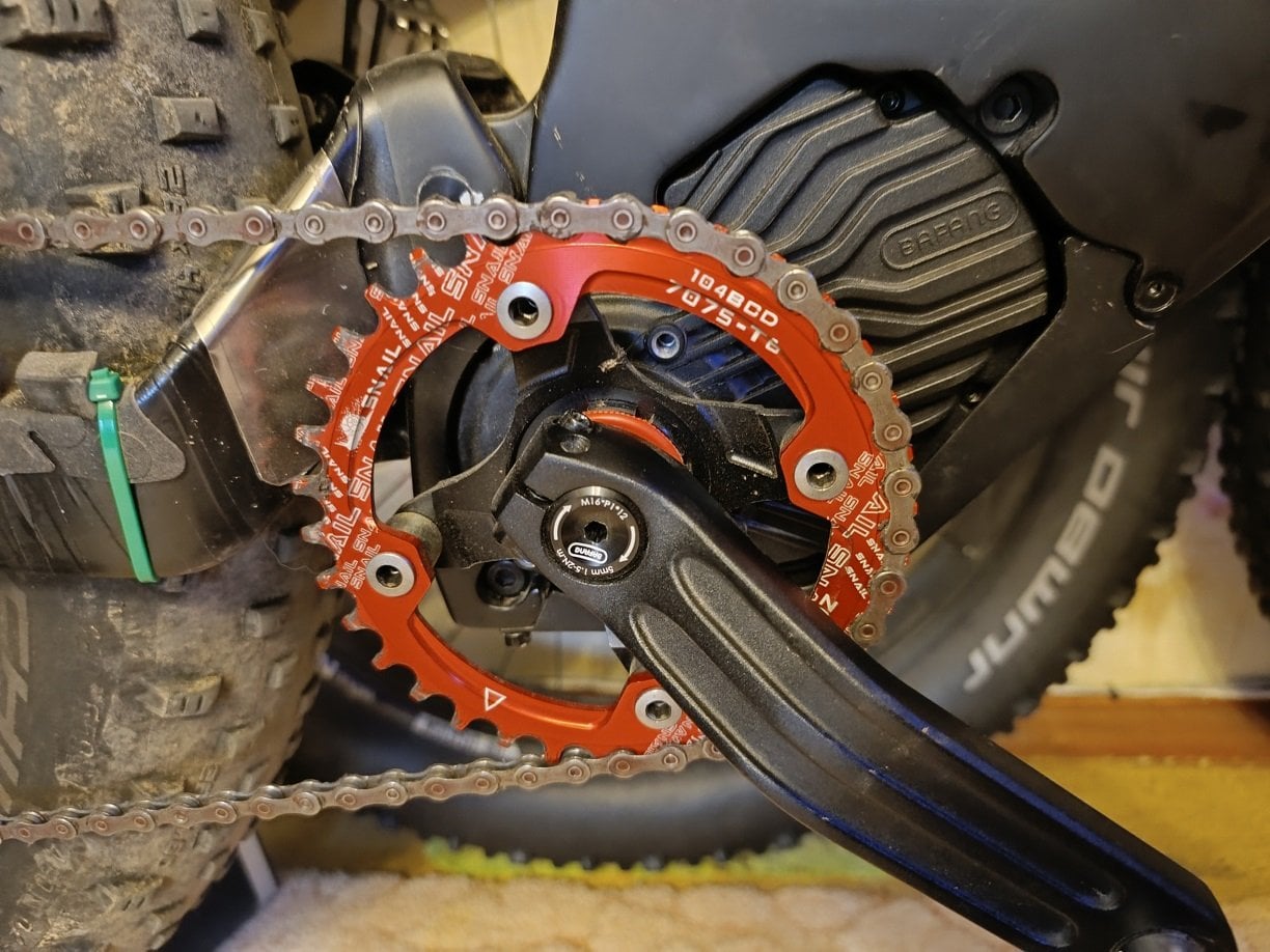

Chainring:

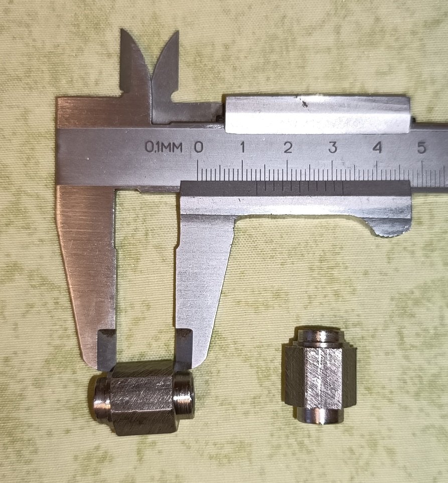

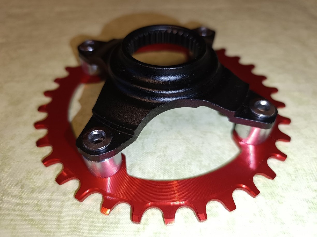

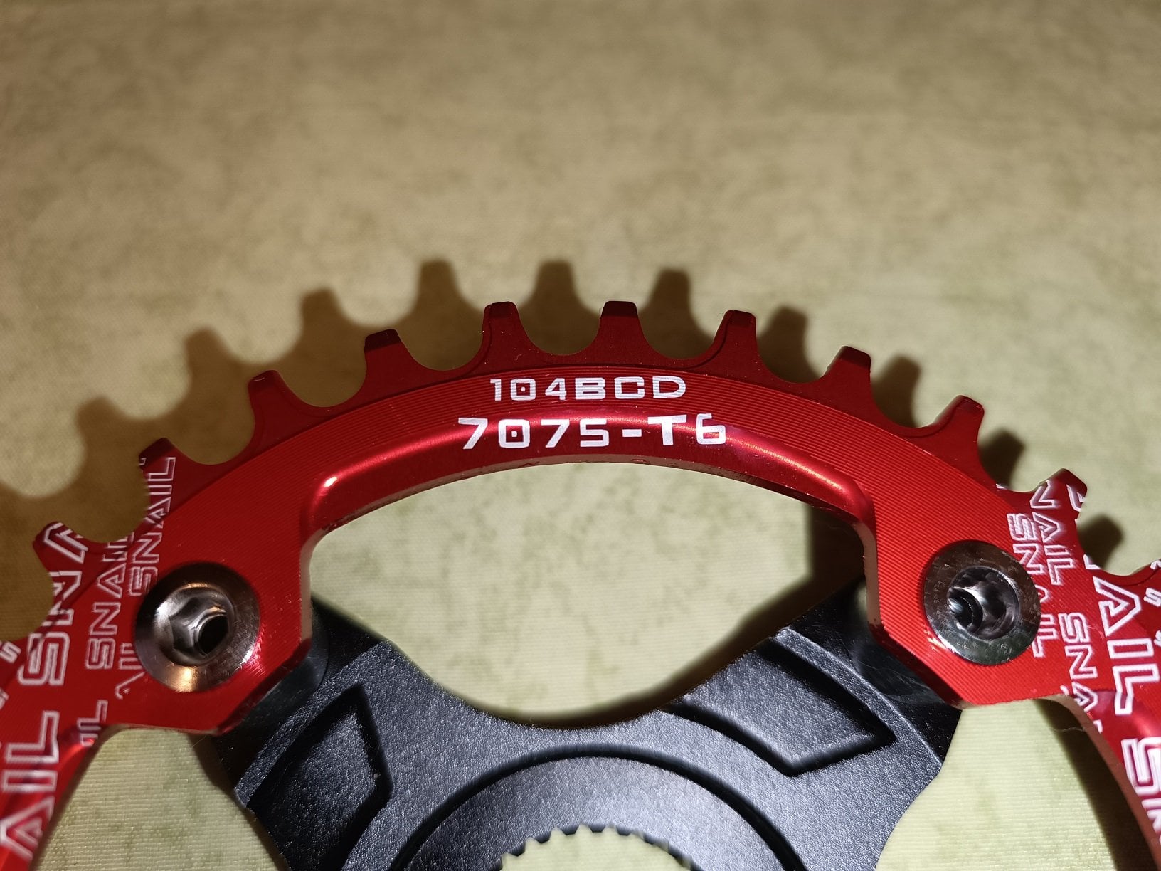

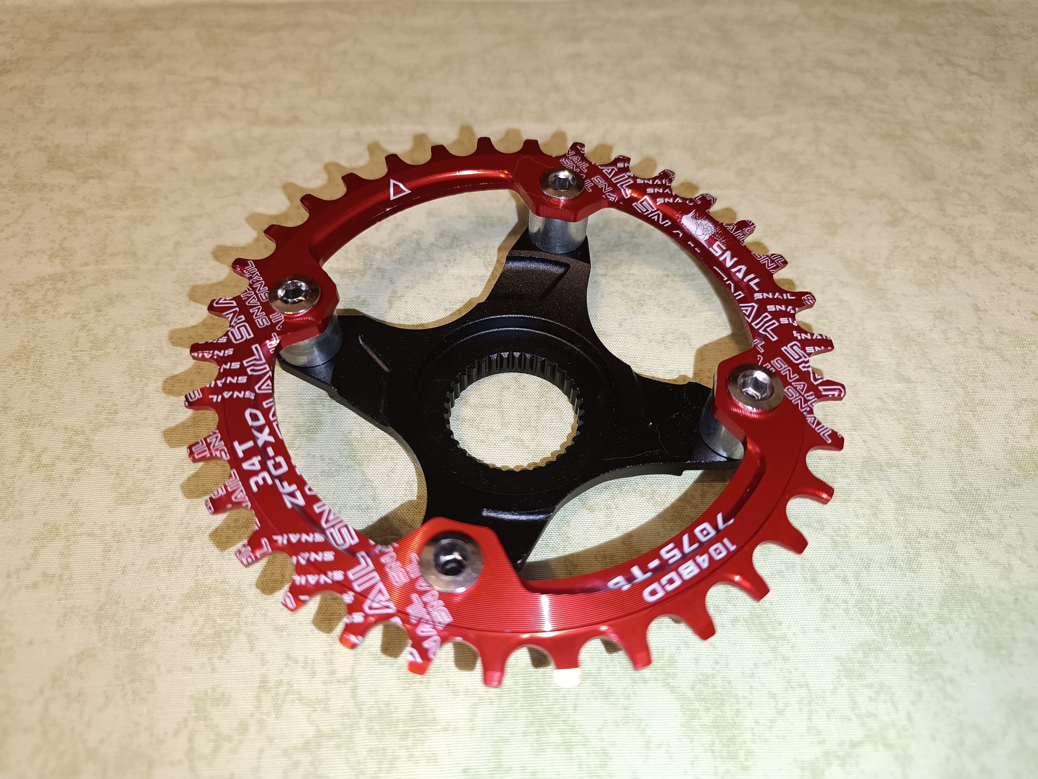

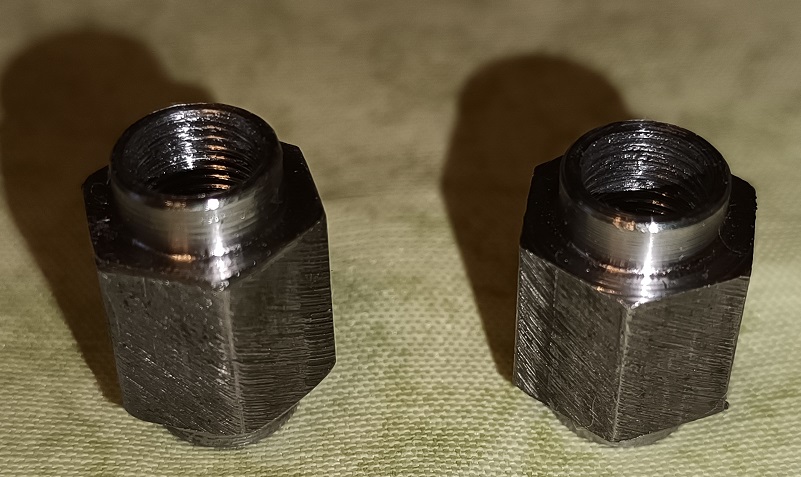

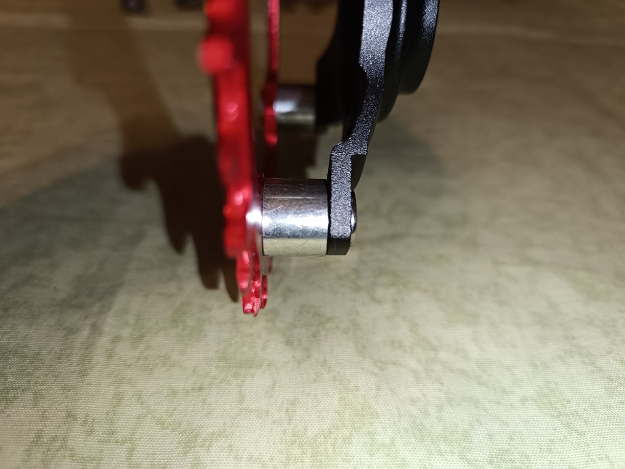

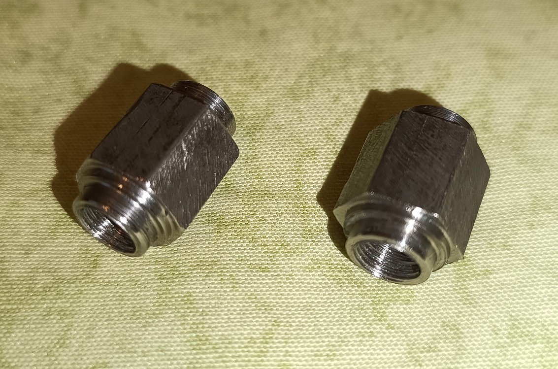

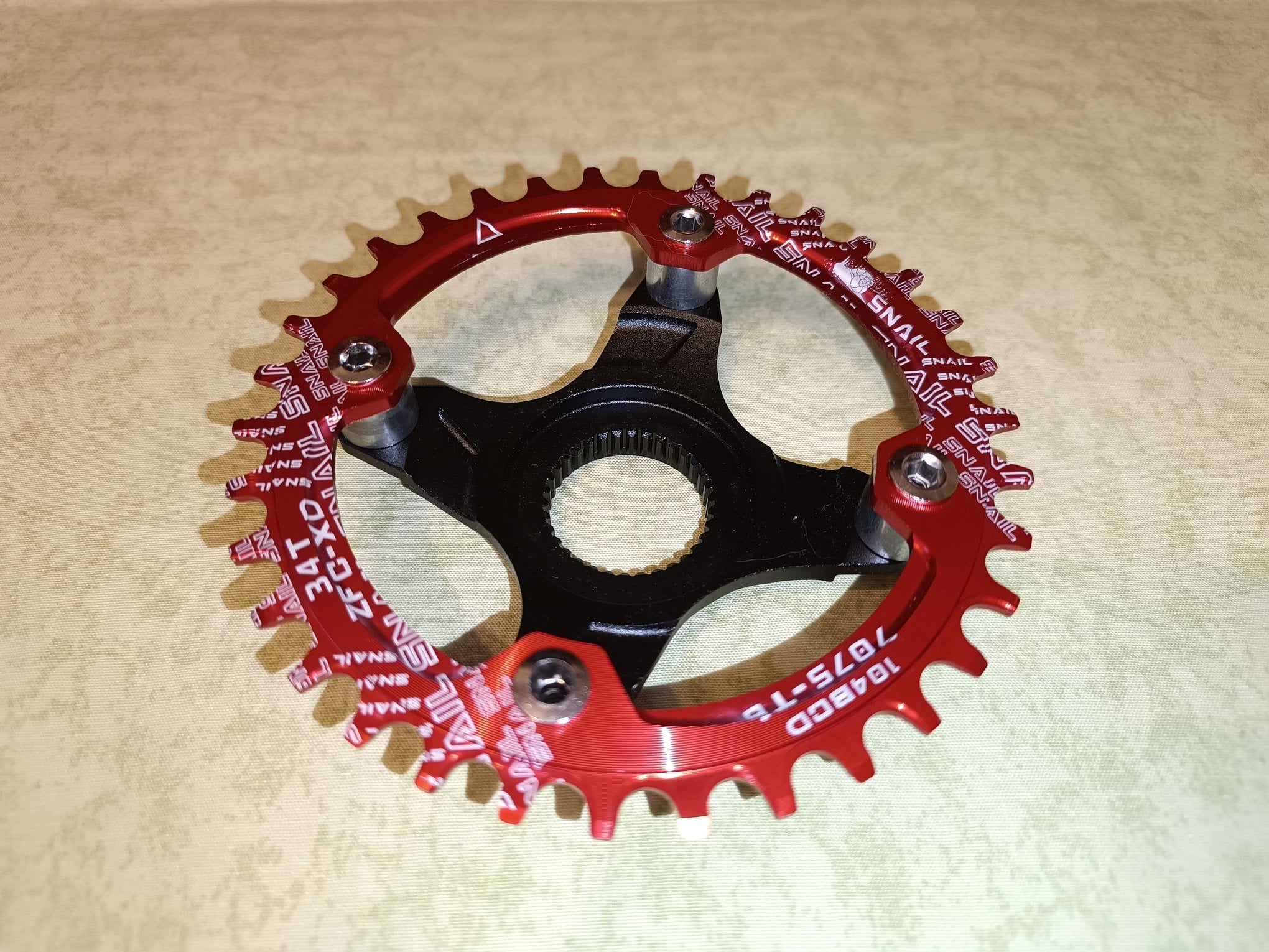

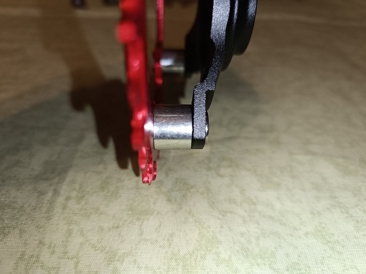

The main problem was installing the chainring. You should look at the photos to see how I made this extension. To make it, you need to find a person with a lathe machine who can produce it for you.
I made a 13mm extension so that the chainline would be centered on my 10-speed cassette. You can make it smaller, but it will only work if you do an experimental fitting first.
For the front chainring, I brought a cheap 104BC 34T aluminum one - it was Alu, but it took me 1 day to get it. Maybe later I'll buy a black metal one, but for now, it doesn't matter to me.
The 38T steel chain from the motor kit cannot be installed, even with an upgraded extension - it's just too large and touches the lower frame link.
A 32T chain can be installed, but the chain may touch the lower frame links.

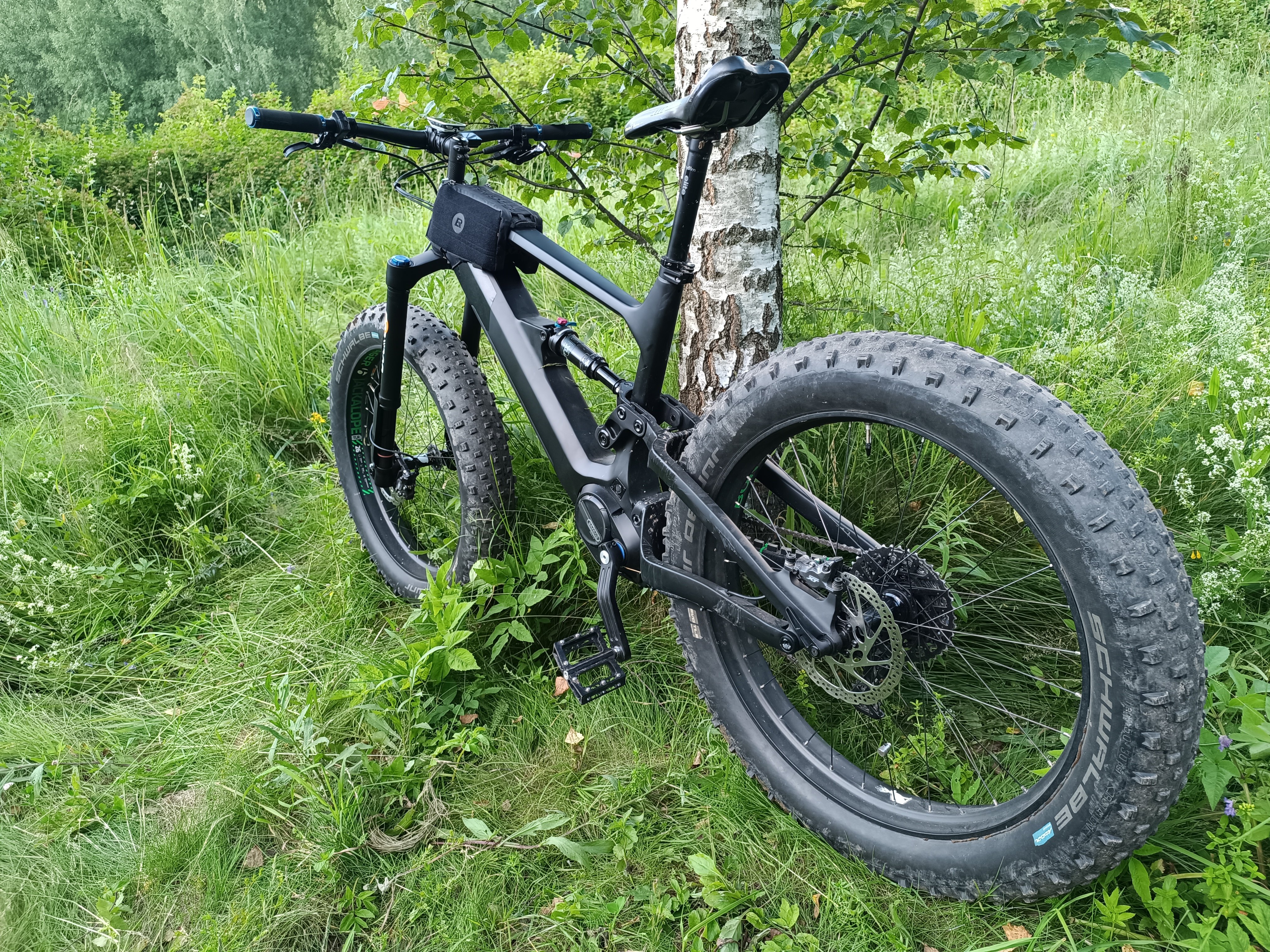

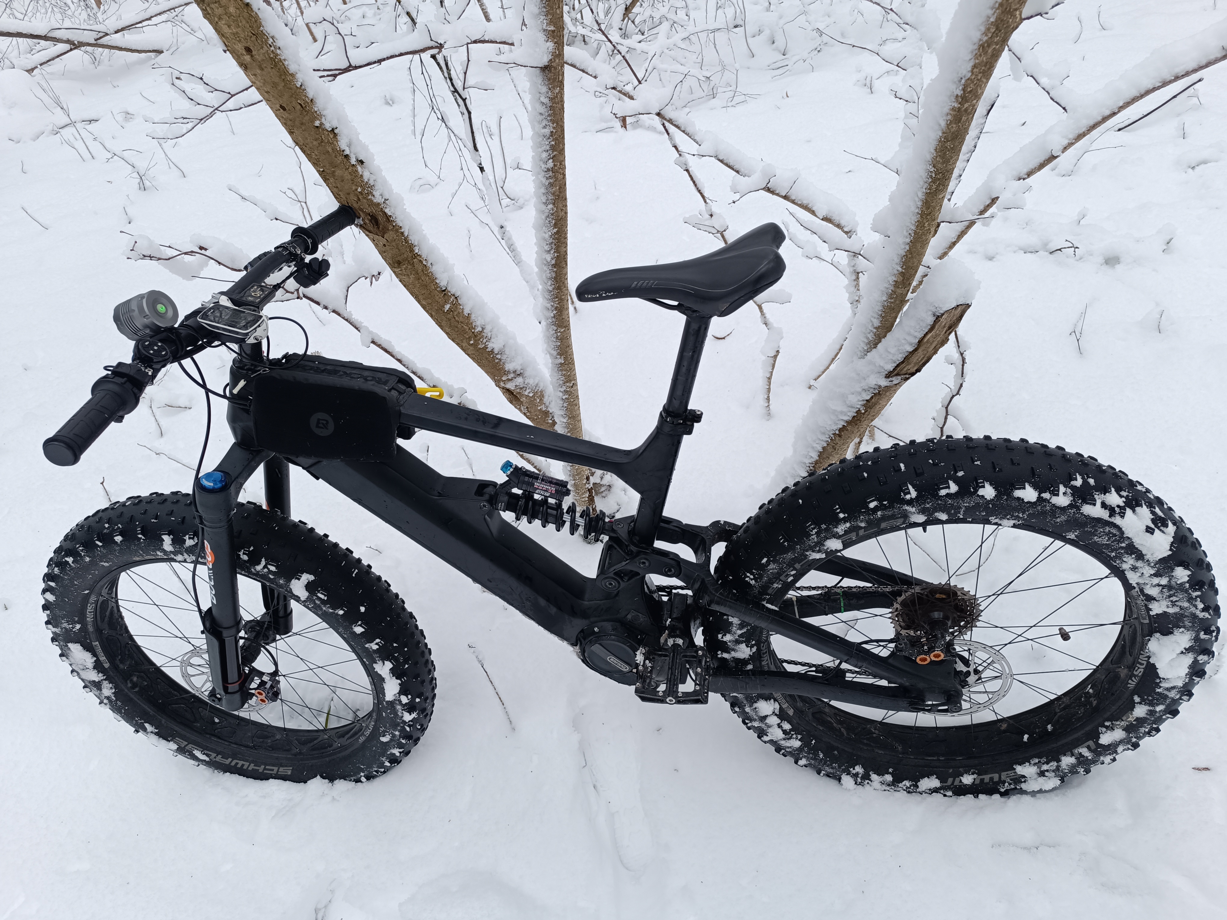

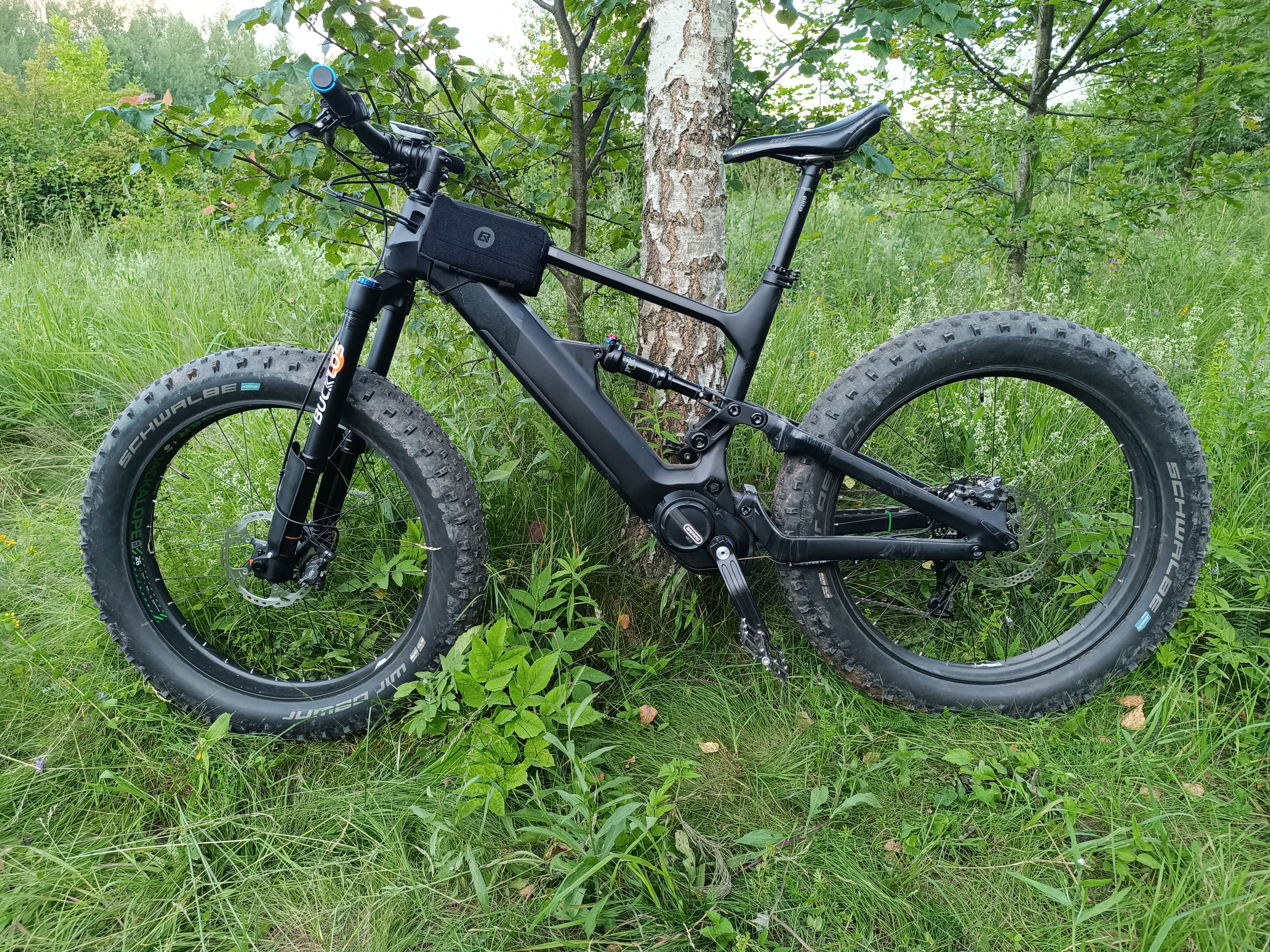

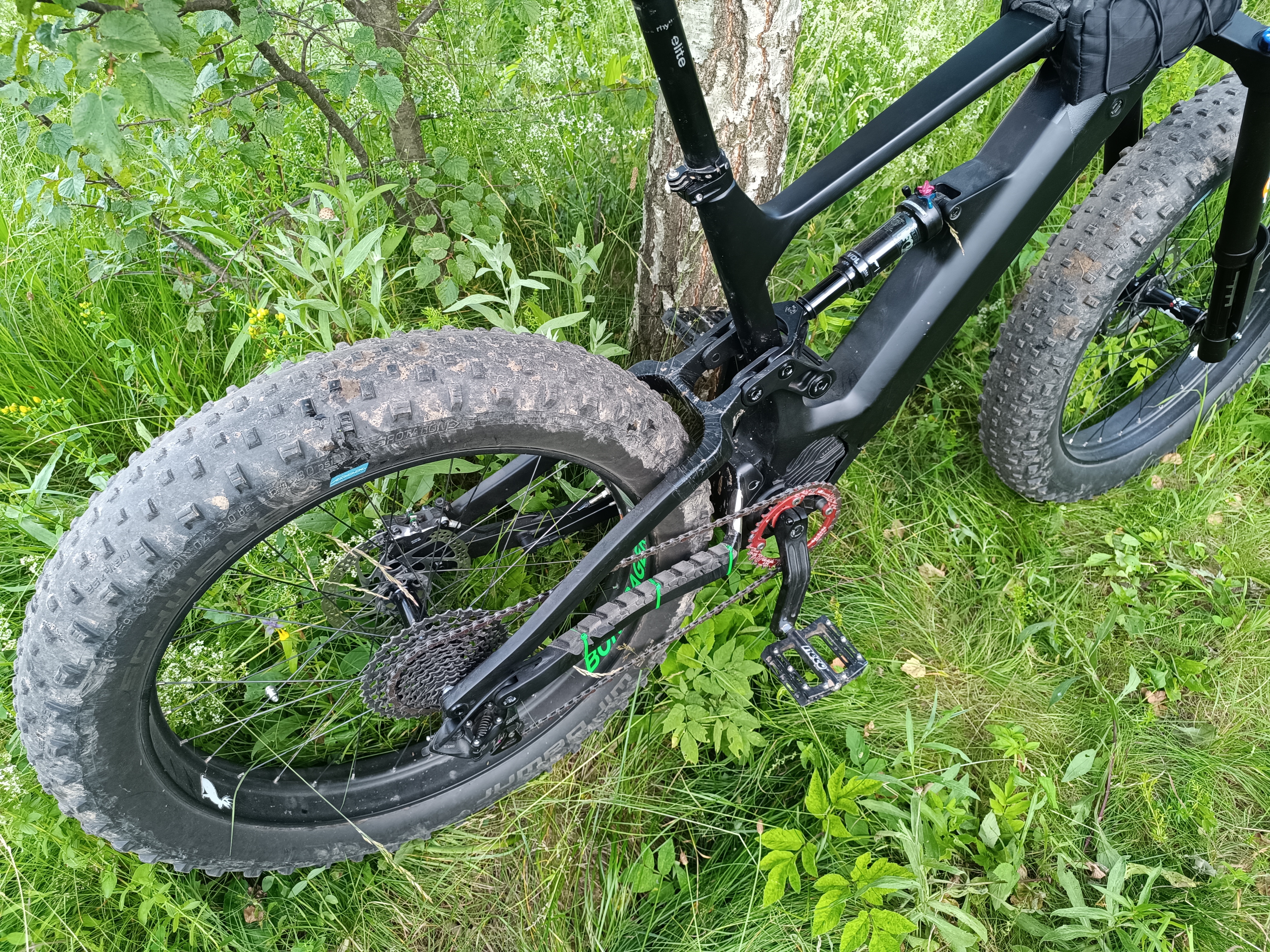

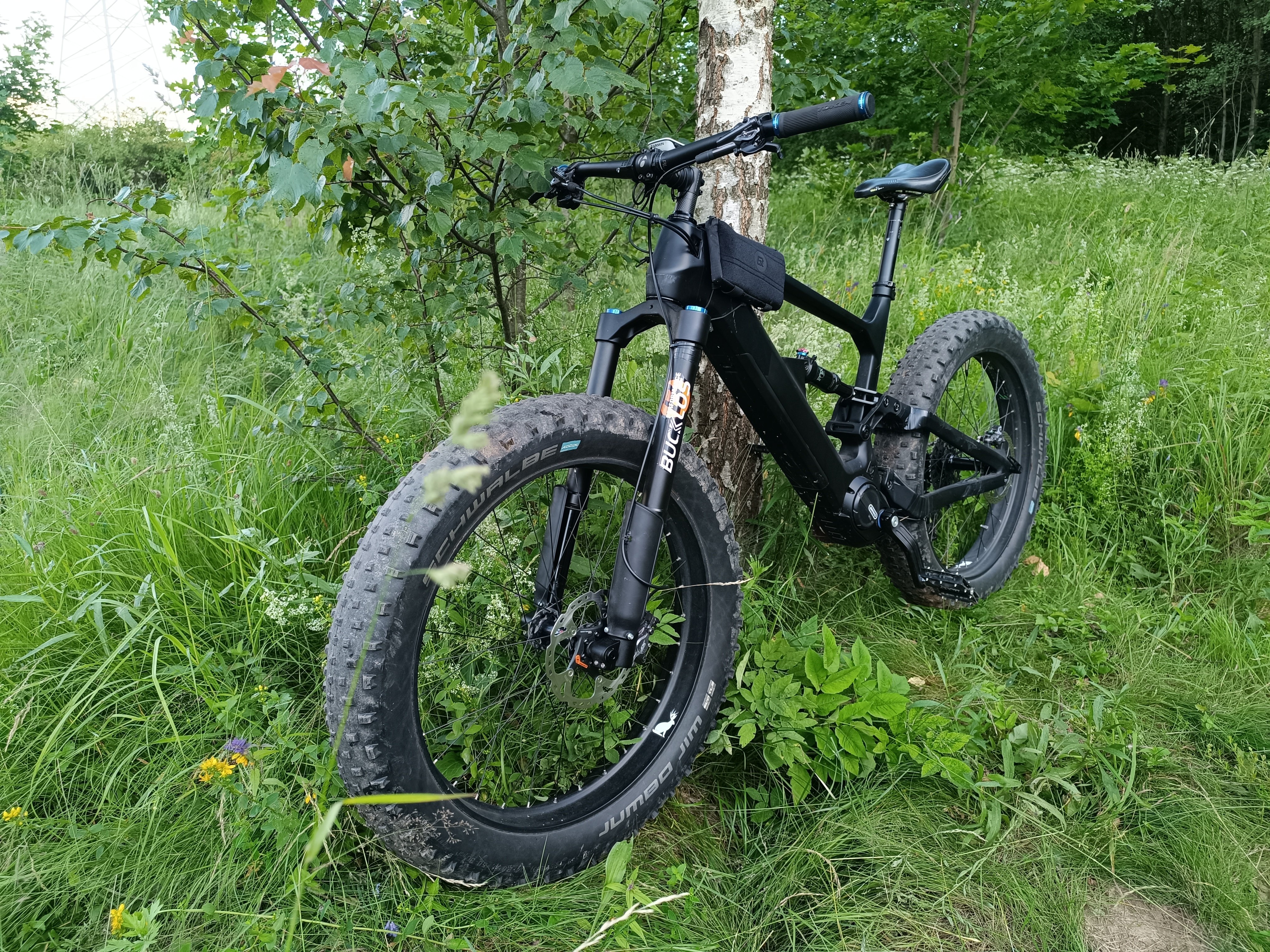

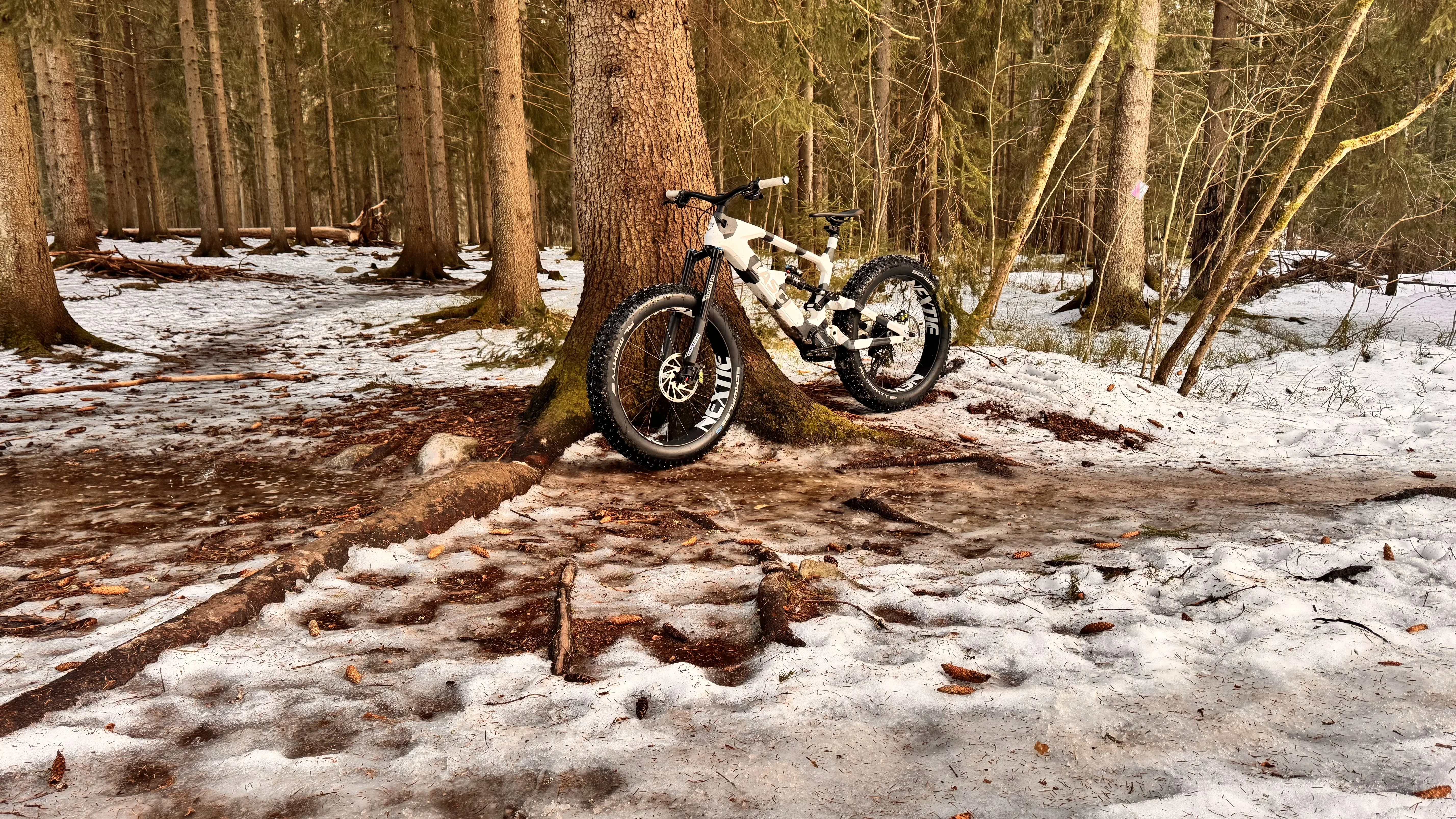

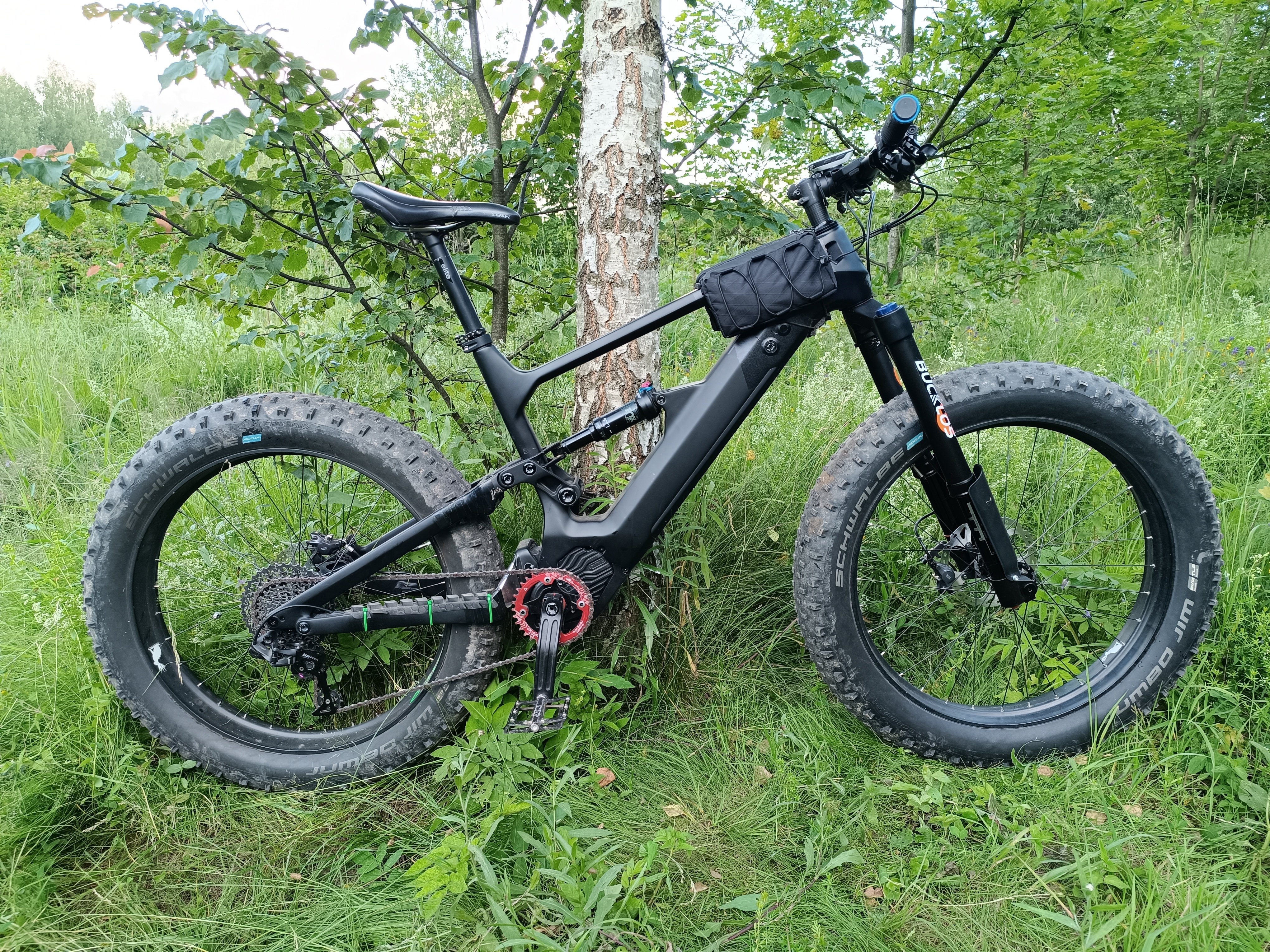

ALL DONE:

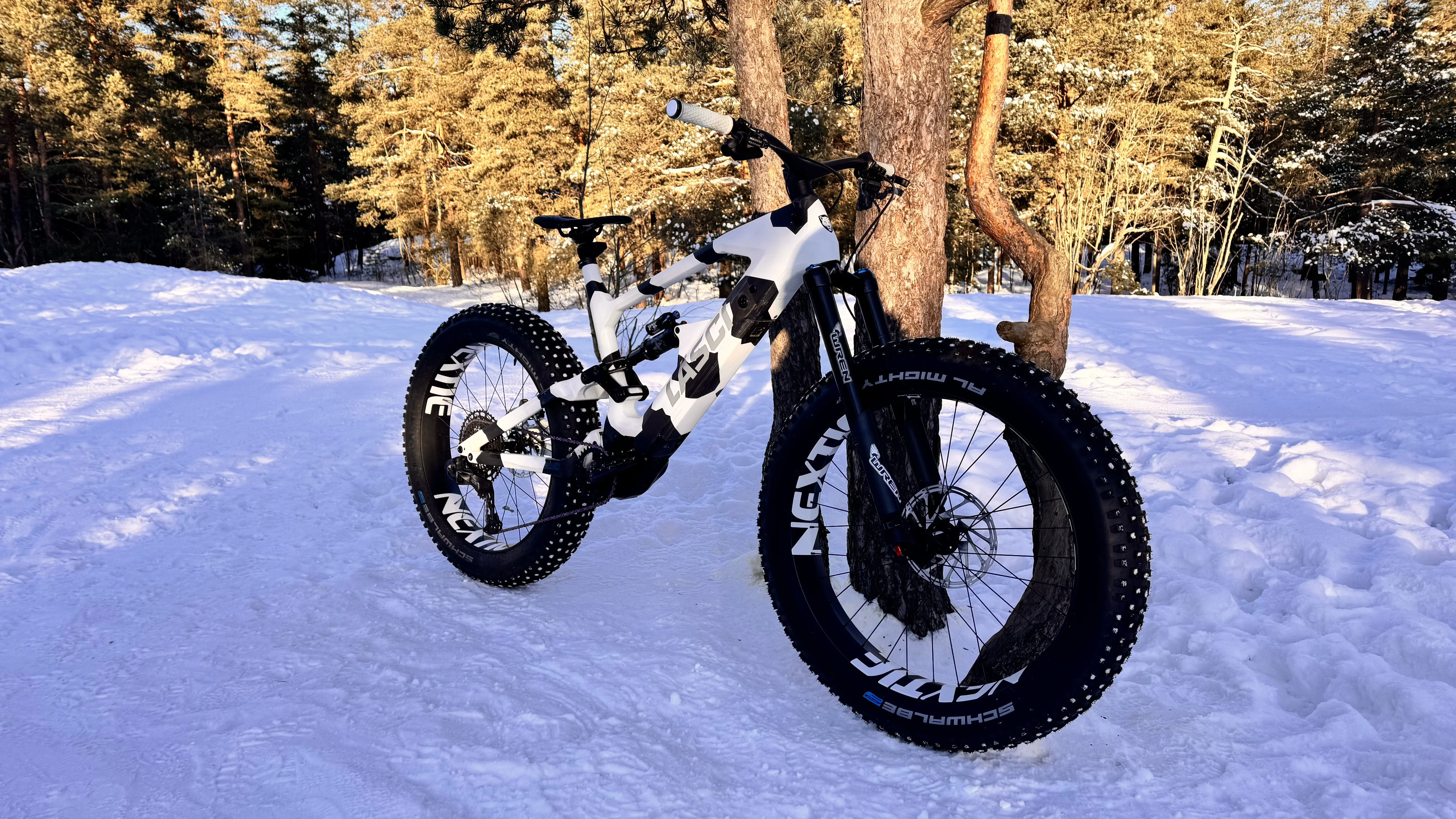

The result is that I have a fully functional and reliable E-fatbike on 26" 4.8 tires that is comfortable to ride and easy to maintain.

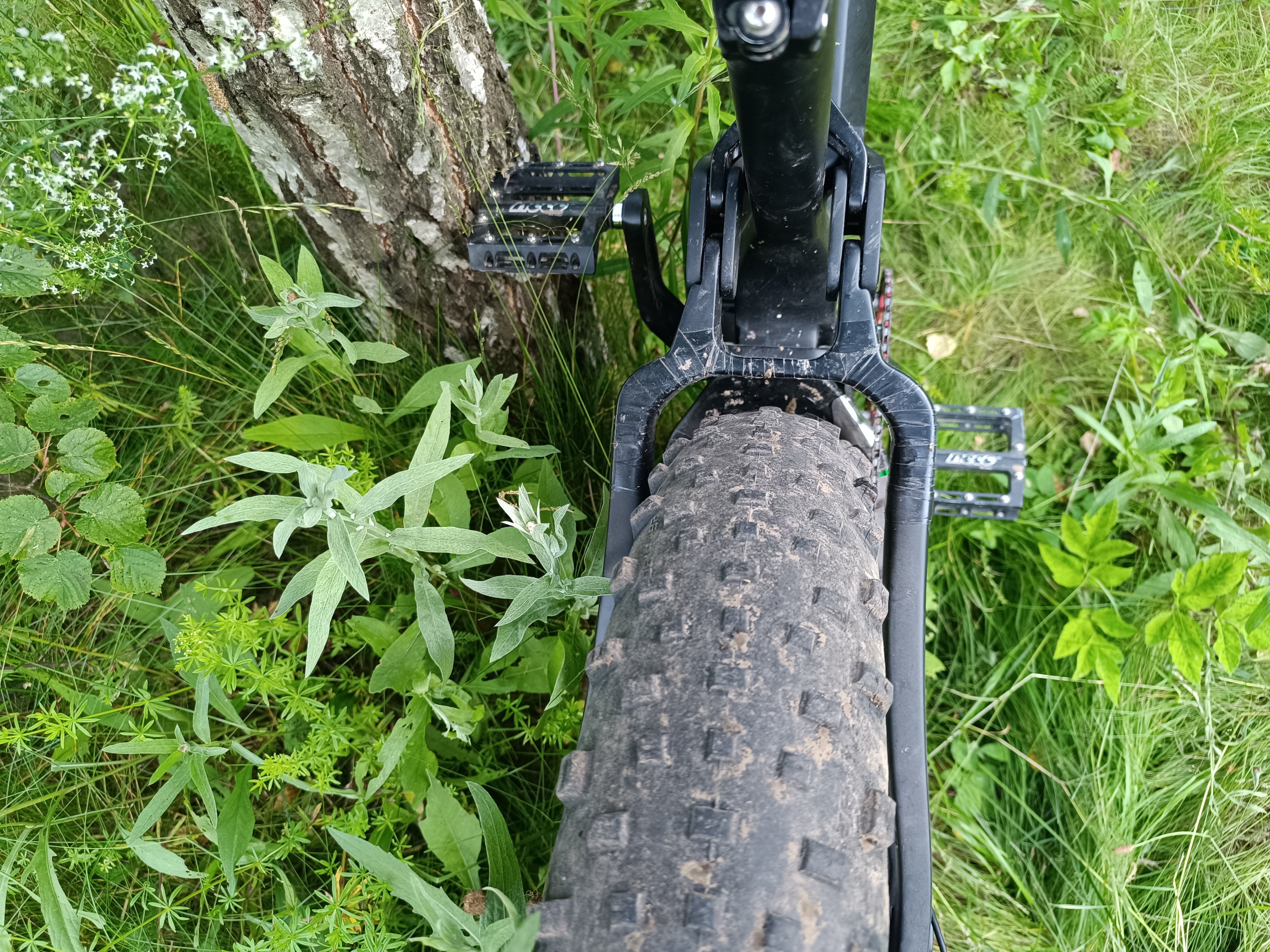

Nice, and a very neat solution to the chainring issue, not much spare room for the rear tyre though 😕
yes, if you look Dengfu E23 spec - max tire 26" 4.0, but it fit near-max 4.8 size with space for biking in mud weather :D
some updates:
= coil rear shock : cheap but on 450lbs give me great bike plush feeling
= steel front chainring 34T, alu broke on my fault
= Wheeltop EDS YQ 1.0 wireless shifting, still testing on wet and snow - no problem yet
= 48v to 9v converter inside frame with more than 3A for front light
= heating grips (but 9v too small, need 12v)
main weak is Bucklos 140mm fat fork, but for it price I shouldn't want more, need some modernization but still work

Dengfu e10 specify 150 rear travel, but I think it is not more than 140 with 210x55 rear shock, I never measured it myself. I always leave some space for safety frame travel (I mean in full travel condition the crossbar of the links should not reach the seat tube).
This winter season have not any frame issues, I don't jump, just cross-country riding, but I thing it strong enough. Jump big thing on any fatbike frame is dangerous, only my opinion).

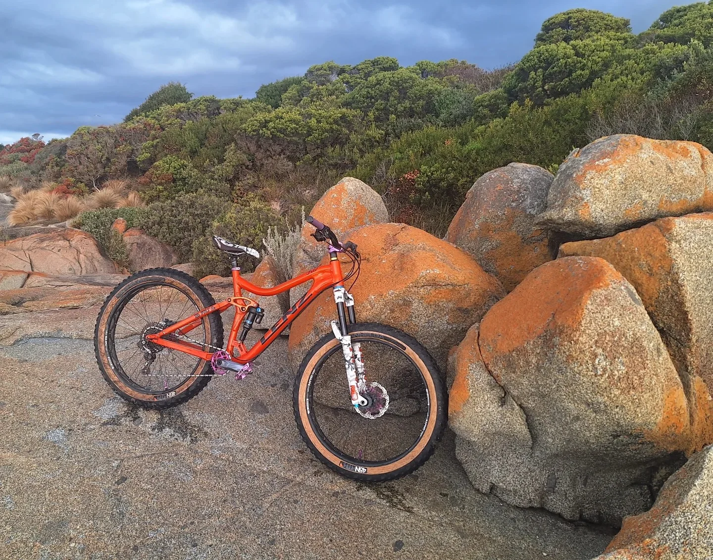

Good to know. I ride my Fatillac the same as I would my enduro bike. Jumps ,downhill trails etc. 130mm rear 140mm front( I've had the fork set at 150mm with the spacers taken out) and it handles everything my old 160mm trek slash could. The big volume tires give about 20mm suspension anyway!😄The bike I am looking at has a bafang 560 motor and is from a company called area 13 but its clearly a DENGFU made frame just rebranded. I'm just worried I'll snap it as I did my old alloy frame that I had before the Fatillac.

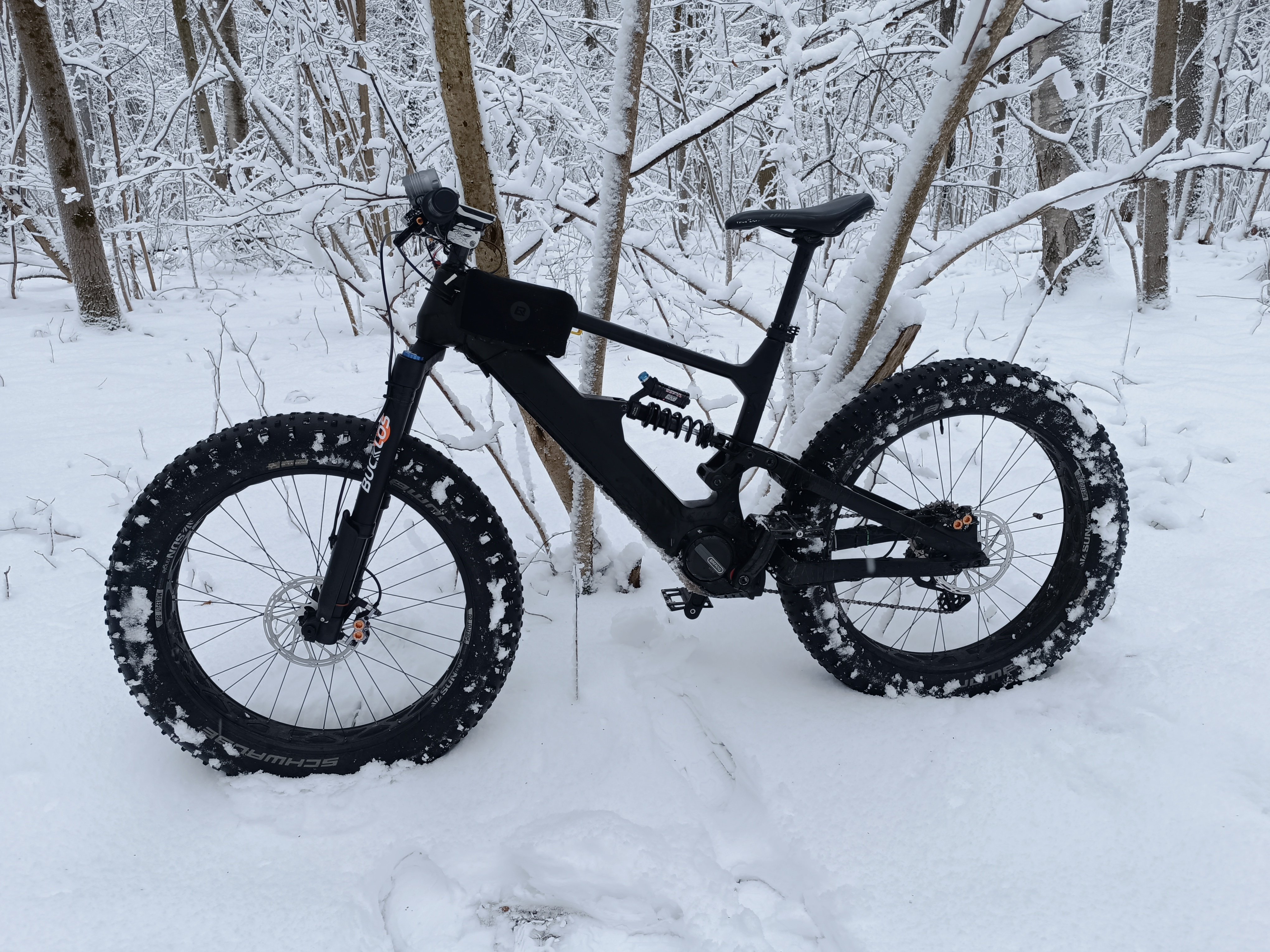

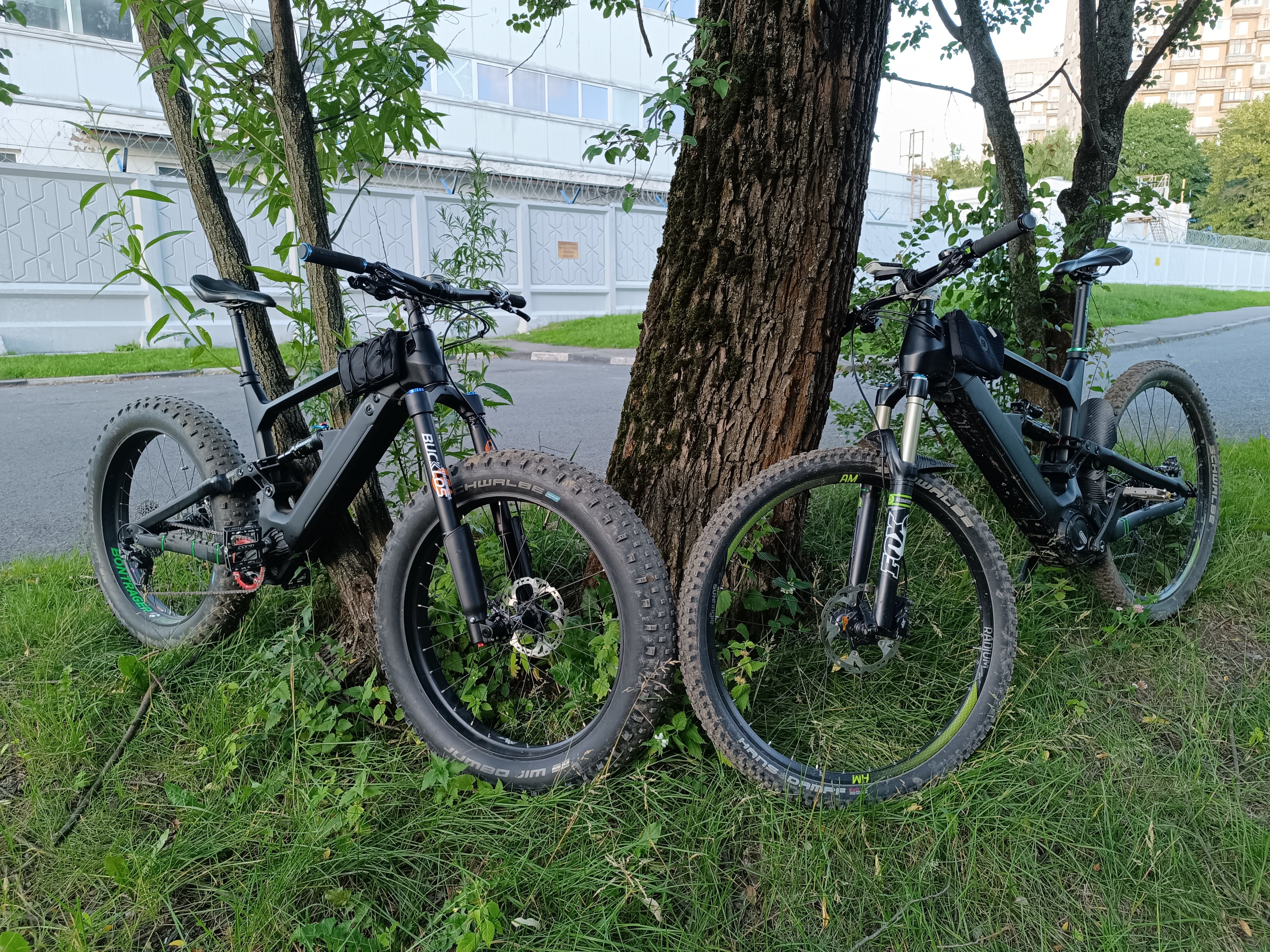

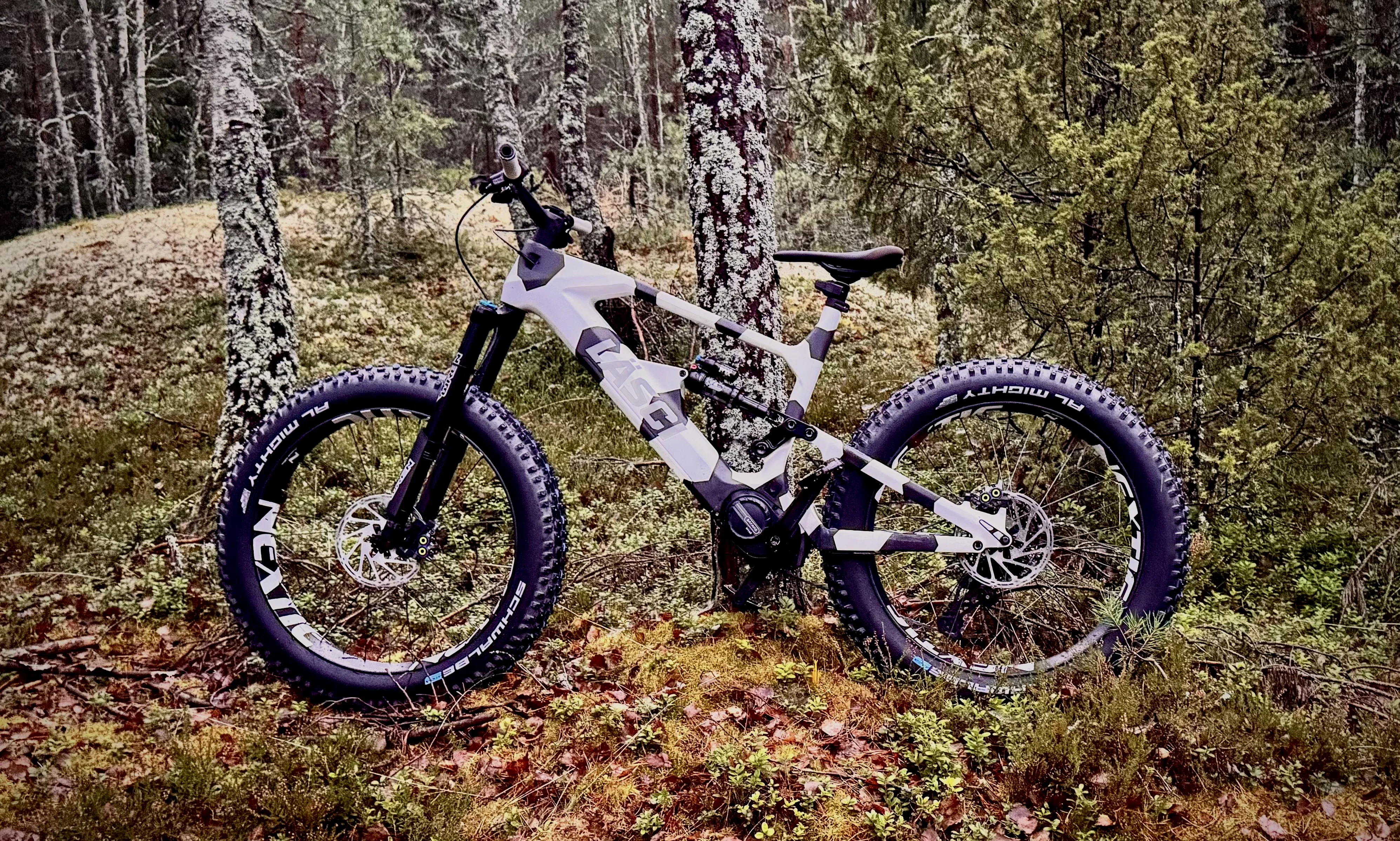

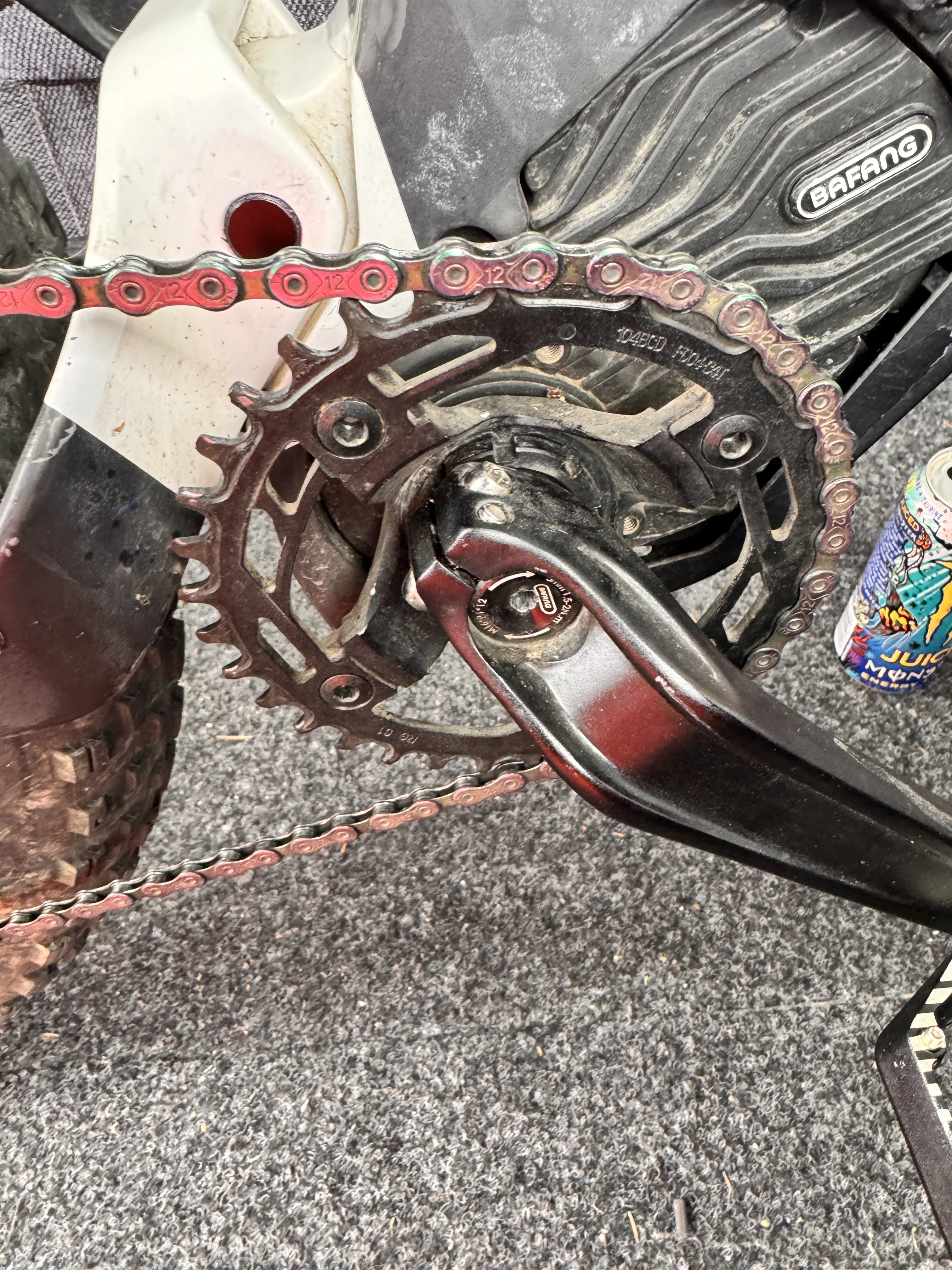

My build. Tested in –20 C. The ultimate weapon for the Finnish winter trails.
Nice build! Good expensive components give more pleasure from ride))
How you solve front chain ring alignment problem?
Thx! I got the fatbike-specific chainring directly from Dengfu when I ordered the frame+motor combo.
  • Hot
Reactions: ncs
