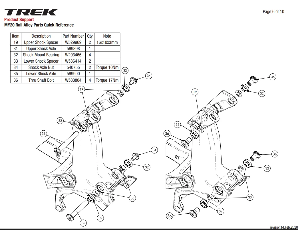

Railo2 New Member Joined Feb 20, 2026 Messages 6 Reaction score 3 Location Thames NZ Apr 5, 2026 #1 Can anyone tell me the exact sizes of the mounting hardware (top and bottom) for the Rock Shox Deluxe Select+ on a Rail 7 (2022) It is a standard mount.
Answ3r New Member Joined May 15, 2026 Messages 4 Reaction score 1 Yesterday at 6:01 PM #2 Manual is here; Rail (625Wh) Thread 'Trek Rail Parts Diagram - Aluminium' Jun 8, 2020 MY20 Rail Alloy Parts Quick Reference
