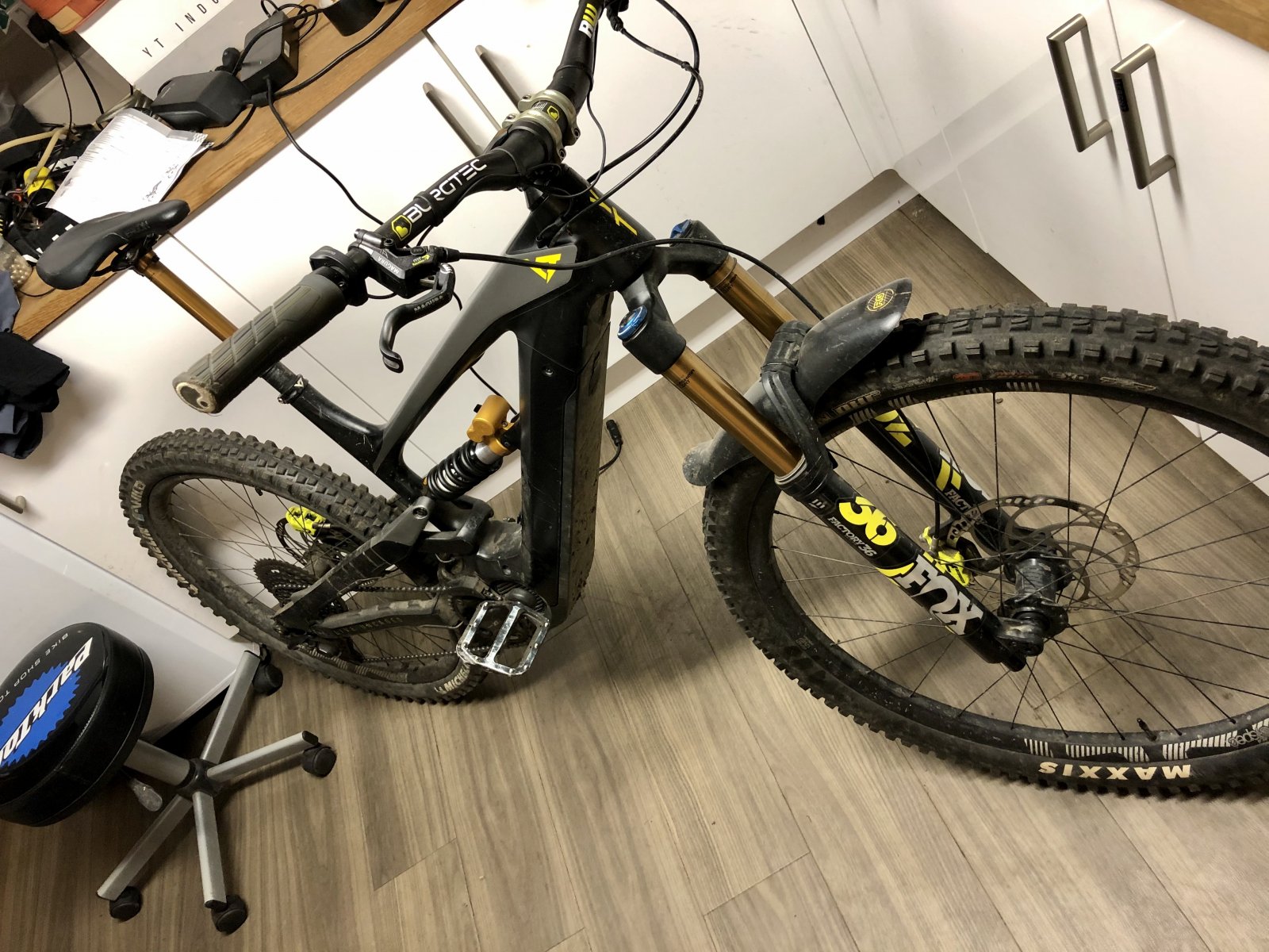

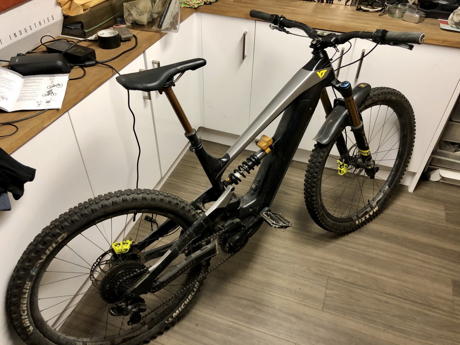

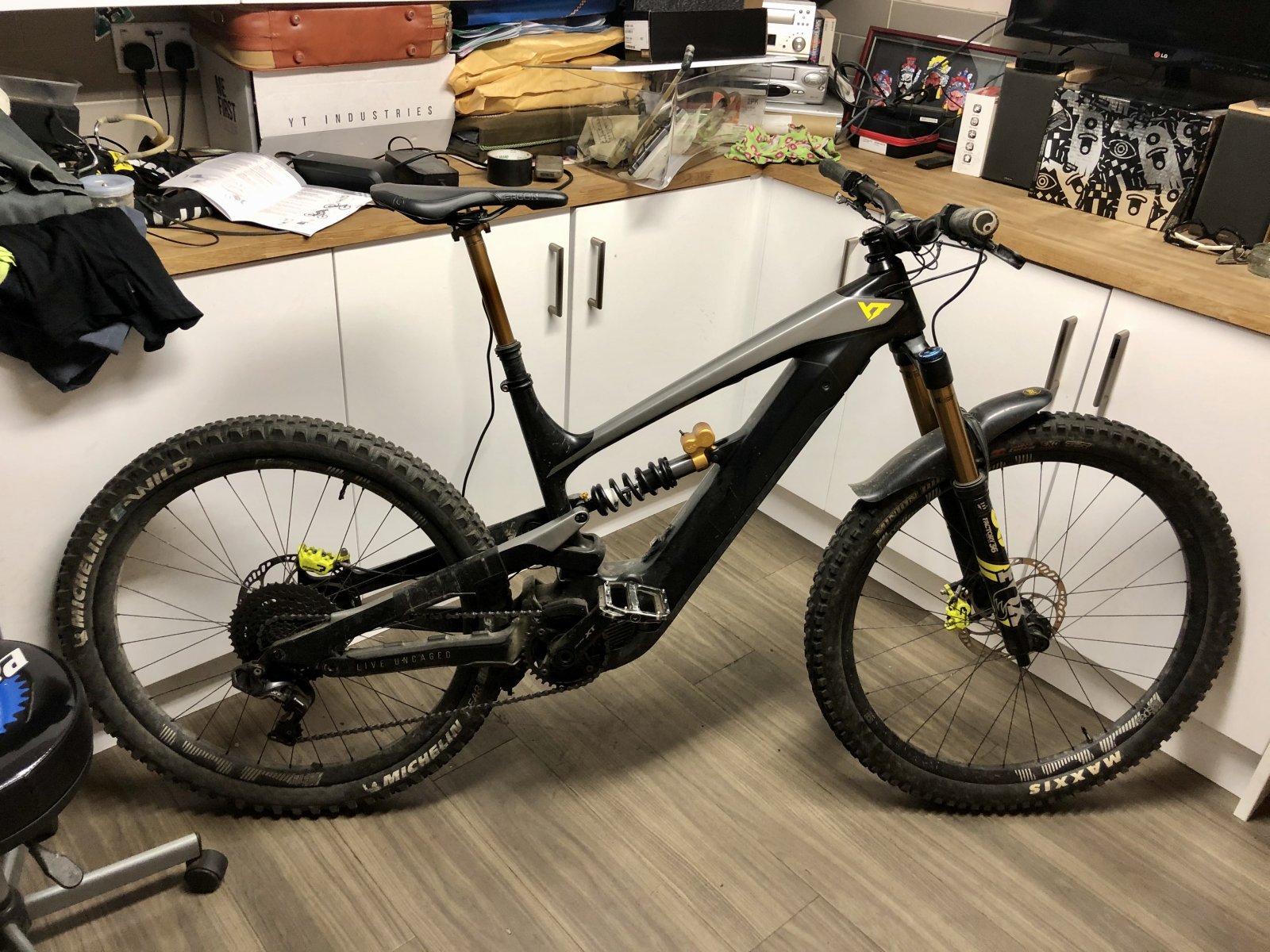

It appears YT are bringing out a Decoy with a coil shock out soon. By coincidence my Ohlins TTX arrived yesterday from TF Tuned. Going out in an hour to have a play and get it set up
I bought it i an attempt to reduce rock strikes as I thought the coil may hold me up better in the mid stroke. I’ll let you know how I get on
