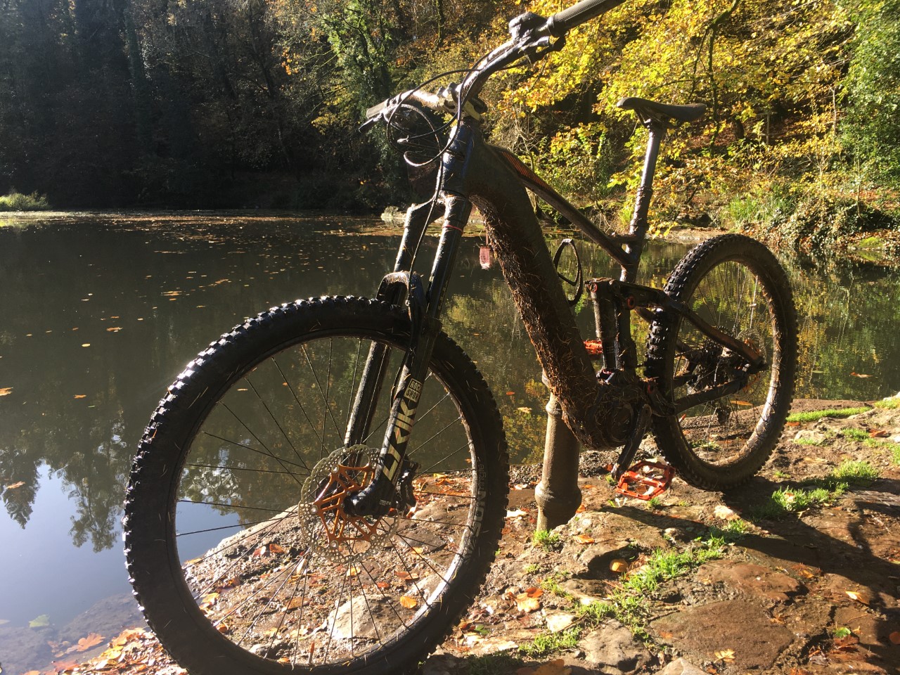

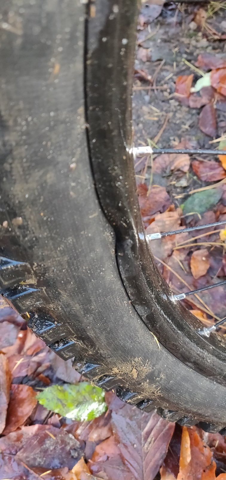

Eddy Currents here.
Rock strike on the rim, threw me off going down a rocky path in the peaks. Ouch. Tyre stayed up though, unlike me.

Wow nice work! I also cracked my rim abit so won't stay up tubless. But I'm still running it with a tube in it. How close is the chain in the lowest gear. With my 2.6 it runs already pretty close!
I'll take a look tomorrow. Bloody close I reckon but I really haven't noticed before.

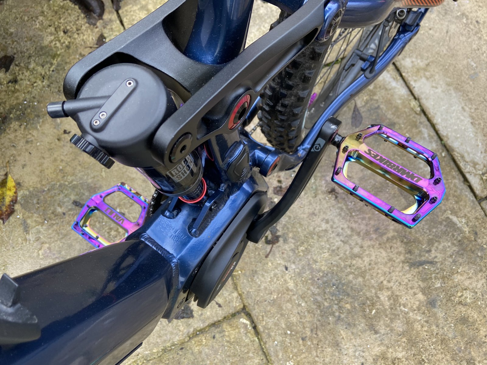

..Absolute amateur hour here .. think I’ve just fecked my Stilus crack arm pedal thread.. what is my best option ? New crank arms ? No bike shops open... canny re thread . Measured them at 17cm at bolt centres. anyone recommend some that won’t break the bank , preferably with colour choices :/ bloody typical wanted to go out in the morning .

Other than the obvious style thing... hope crank arms ? Anyone got them on Stilus other than Rob. So Pricey ! I’m also wondering about slightly shorter 160mm cranks.

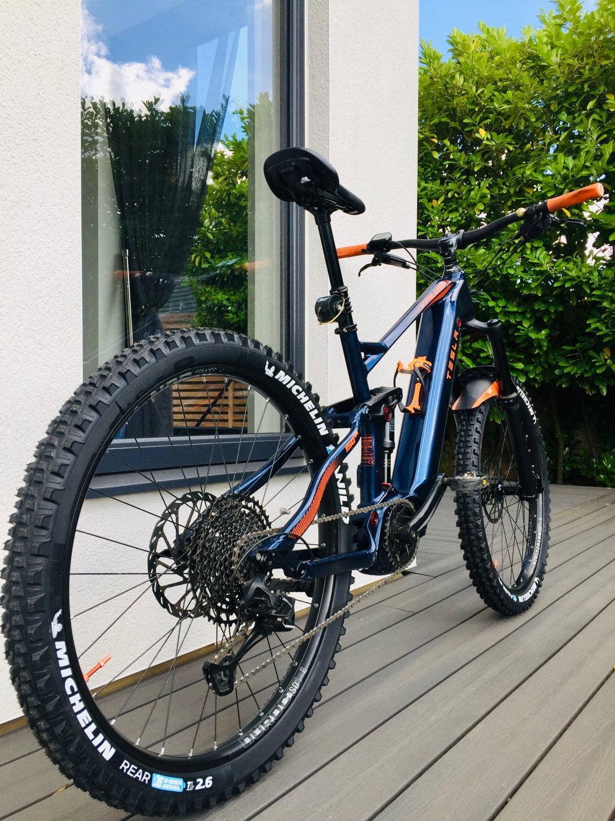

Sure was!
Pro's:
- Offroad Grip is night and day different from the stock Smart Sams
- They look way better :p
Con's:
- They have a lower overal circumference than the Smart Sam's. I'd not read this anywhere, but net net the tyres are noticable smaller than the Smart Sam's. I'd say when you put on an eWild and measure the distance from the floor to the top of the tyre, they are an about an inch lower! What this meant was with the speed restrictor is I was getting engine cut out at 17mph (it tailed off from 15.5mph to 17mph), now the engine cuts out at 16mph.
- I have really seen a big decline in battery performance as clearly the rolling resistance is much greater than the Smart Sams. I'd say I've been getting maybe 10miles less out of a battery. Now the weather is colder and I did upgrade the Bosch SW to 85NM at the same time as the tyres, but ride mainly in Tour which doesn't use the extra torque apparently.
Summary:
I'd still recommend the tyres, as any decent grip offroad tyre will have a battery impact compared to the high rolling Smart Sams, I just hadn't even consider the tyre circumference would be smaller. I may try Swarbe Magic Mary's next as most of the guys I ride with swear by them and given Smart Sams are Shwarb, I assume they will have the same circumference!
I'd also take a look at this:-
I reckon 160mm all the way (y)
