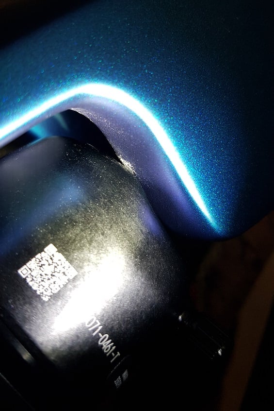

Hello,
I bought a brand new 2025 Cube Stereo Hybrid One44 SLX 800 a few weeks ago. After the first test ride on mostly flat and paved roads (no trails or off-road), I wanted to clean it and properly set up the suspension.
I noticed a slight cracking noise coming from the top of the frame every time I put weight on the bike (i.e., when I sit on it). The sound was coming from the top of the rear Fox shock. The shock was pressing against the frame with substantial force. The force was so strong that after just one 30 km ride, it removed paint and started scratching into the layer beneath it—this was the source of the sound.
If I place a piece of paper between the shock and the frame at that specific point, the paper is loose. However, when I sit on the bike, the paper gets squeezed so tightly that it can't be removed without tearing. So yes, there is contact—and it's quite strong.
I brought the bike back to the seller, only to find out that another bike they had there (same XL version, different color) had the same problem! I tried the paper test on that one too, with the same result.
How is this possible? Is this a bad batch of frames? A human error? Or a design flaw affecting all Cube bikes of this model? I can't believe they'd sell bikes where the rear shocks are damaging the frame. Such force on the frame seems dangerous in the long term.
In the attached picture, you can see the damage on the left side. The right side looks exactly the same, with another spot where the paint has been removed.
You'd imagine there would be a recall if it was a consistent error with every frame.
It could be bad manufacturing tolerances. But that is perhaps unlikely with a carbon frame as they all use the same template.
Installation error seems likely. Especially if there are two from the same shop!
Do different size carbon frames all use the same template?
No - but all size XL's will have the same template ...

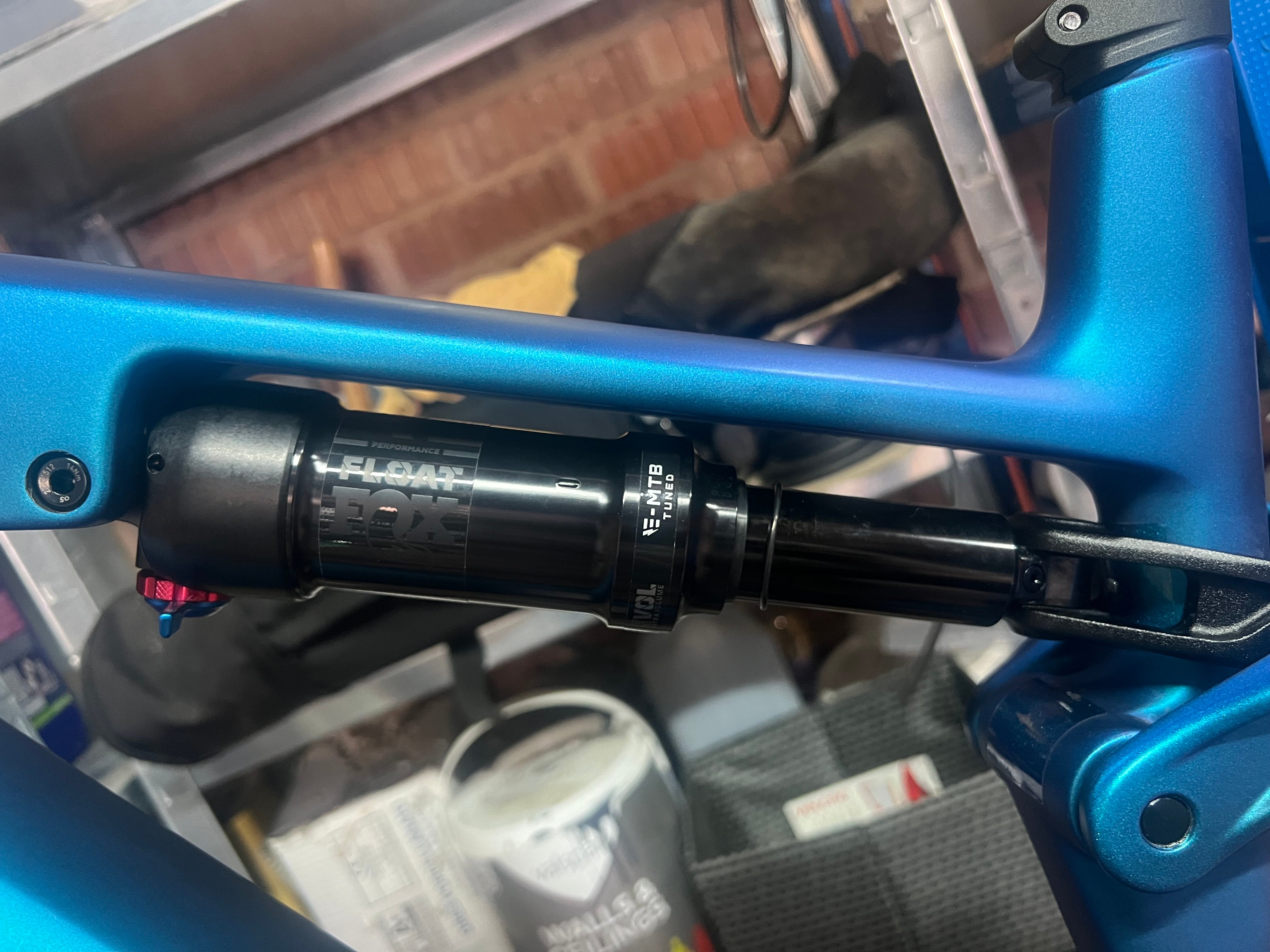

I've realized that I have another image of the other side. It shows a bit better how little space there is.
View attachment 163484There is def
There is definitely something wrong either with how the shock is installed or missing parts, or your frame is made incorrectly.

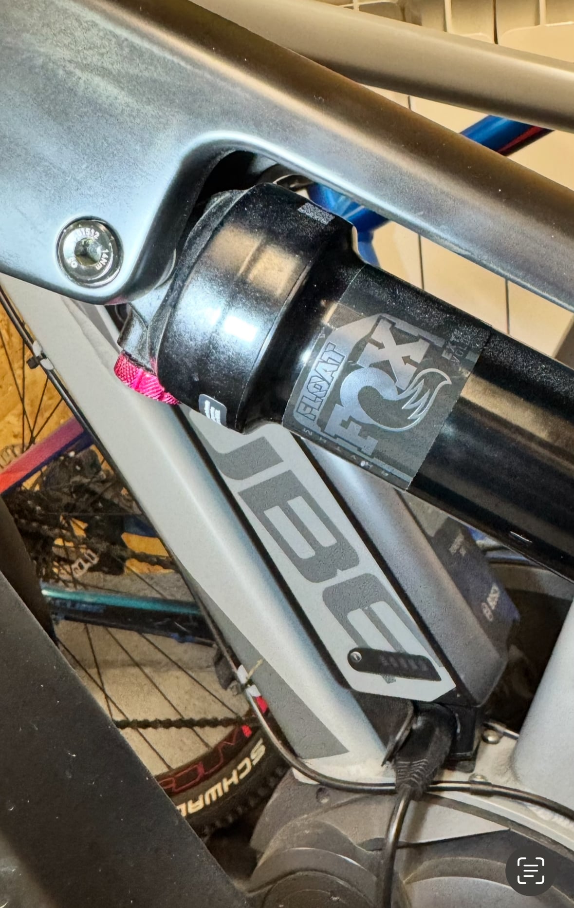

There seems to be plenty of space around the rear shock on my XL frame.

That's very interesting, because the shape of your rear shock seems to be completely different. I don't even see the lockout lever?!? When did you buy it? Is this an aftermarket modification or did your bike come with it like this?
There is no lockout on mine. I purchased it Christmas 2024

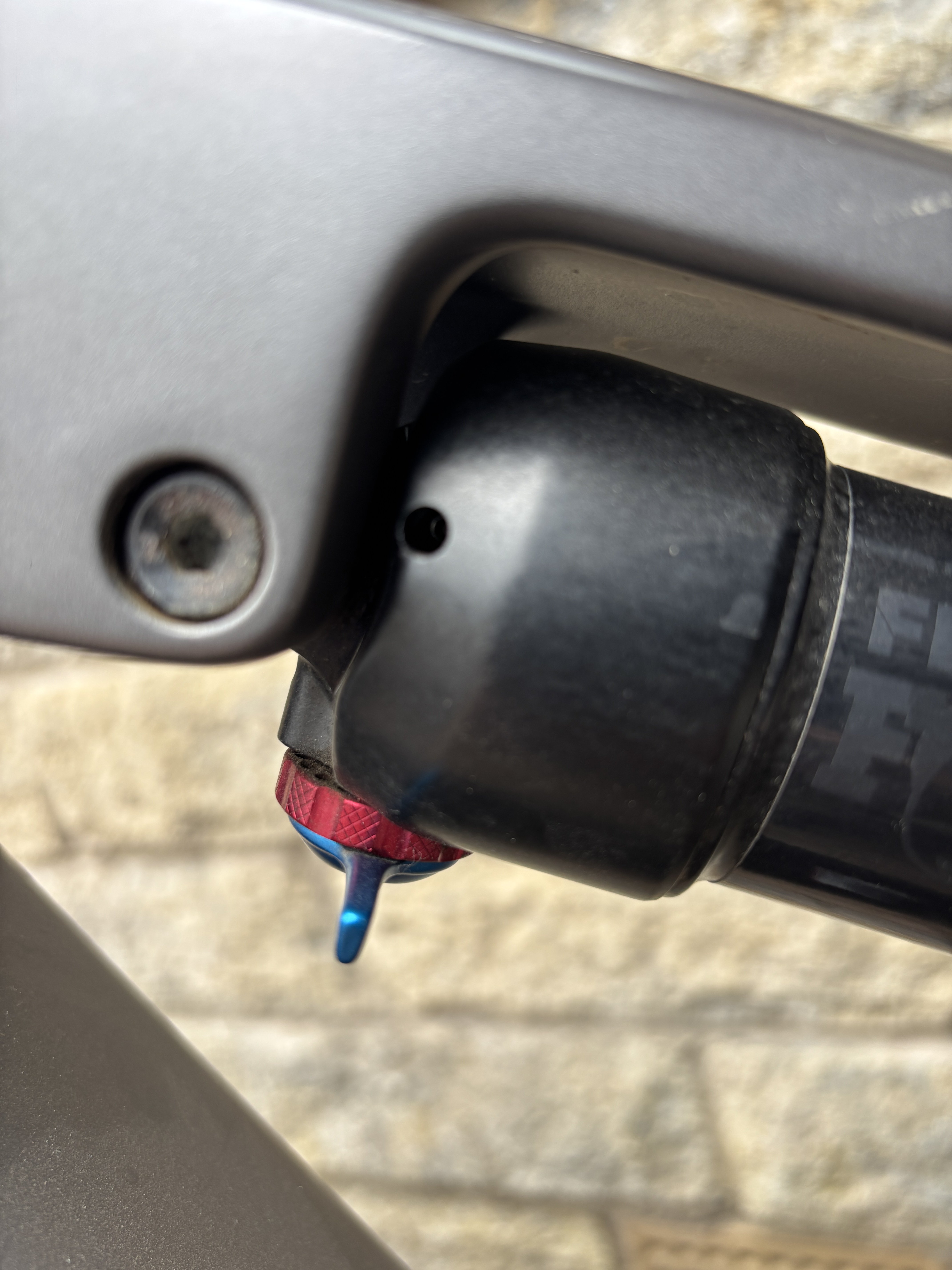

Just signed up as my Cube One44 HPC SLX has the same problem. It went back to the shop after only a couple of weeks because of the creaking sound. They said they regressed the rear shock mount and it was fine for a while but the noise has returned over the last couple of rides.
I’ve owned it since January but the amount I’ve used it is very limited for various reasons.
I got the bike on the work stand and saw the issue pictured in this thread. A quick google brought me here.
I’m a bit concerned that being a carbon frame, it is more vulnerable to crushing force than a metal one, I’m worried that this might cause a crack to develop over time which will only be apparent when it fails.

I have a 2025 144 SLX and measured the gap between the shock and frame today.
The gap with no weight on the bike is 25thou. With the bike weighted and a little bouncing it just grips an 8thou feeler gauge, sorry I don’t have any metric gauges so you’ll just have to convert.
So that’s 17 thousands of an inch movement in the top bolt.
If I really took a drop on the bike, which I don’t, then I can imagine that there would be contact.
I suspect that amount of movement is probably normal for a shock mounting bolt but the size of the clearance is bad engineering.
