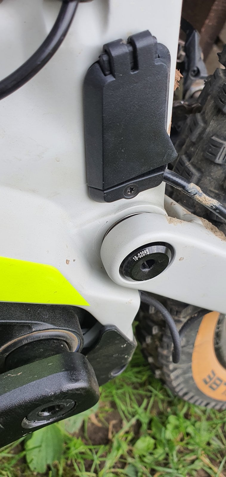

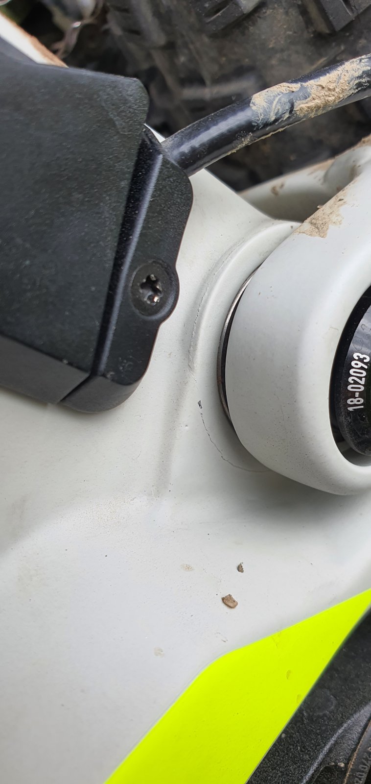

Hi guys! I've quick question. I bought 2m ago Cube stereo hybrid 140 race. Carbon frame. I'm 90kg. I was ride 500km till today. Today after a 40km single-track I found this (on pictures). Is this normal in carbon frames? This is my first full and carbon also. Second issue that I found is when I move a
Bicycle handlebars Left-right(or right to left ;-) ) there is an audible ticking as if something is knocking on the frame. That's why I found this on pictures. HELP!

Did you bought it new? My opinion it´s an warranty claim
Yes, quite new. The box even opened for me in the CUBE lounge. Its model year 2021 bike.

By all means get it checked but there have been a few very similar reports/photos here on the forum and mostly ( like yours) the crack outlines the joint between the frame and an insert where the surface of the insert has been blended to the frame with an epoxy filler. Carbon flexes so it is inevitable that some of the cosmetic filler will get disturbed. The insert ( e.g. a metal sleeve) will have been bonded into the frame so is unlikely to be an issue. So as long as there is no movement of the insert itself i would not be concerned.
It was failure. Big failure!
So my journey with CUBE Stereo Hibrid RACE 2021 has to end. Cube send me money back. I don't have my bike :-(
Now i must pick a new bike and i don't have idea which. But now i know one, not CARBON!

This cracking will be progressive. (In my opinion also.) Other bikes don't have this issue in carbon. Its a weird situation for Cube.
Is the same cracked outline on top?

I found the same thing on my 140hpc.Did you have any progress?You can check mine here (Cube 140hpc 750/Cracked frame??? - EMTB Forums)

For every manufacturer there will be problems. I think the measure is how they deal with these issues. I have a 2021 Cube and in general was a little concerned about the Carbon Frame so I check all stress points regularly. I will buy an Alu Frame next time but this is just my choice of feel and nothing to do with Cube. Will be interesting to see how Cube deal with the issue seen on the 2022 140 on the other thread, that would influence my decision.

Have same issue on my 140 actionteam and CUBE brushing it off as paint crack. Be very interested to hear how yours failed (before I ride down Snowdon)? Thanks
