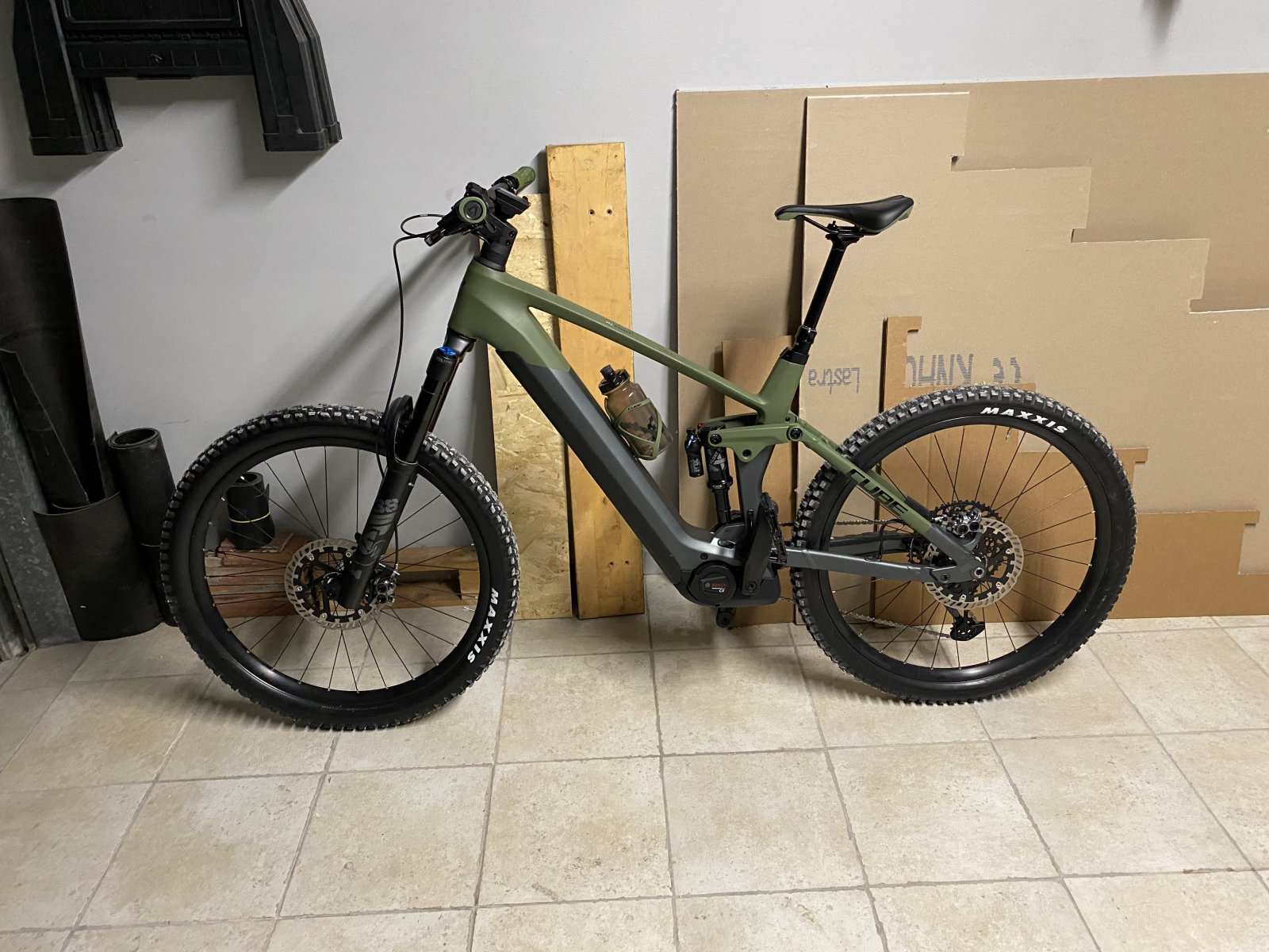

Yep, unfortunately I realised that. All the photos are of the Super deluxe which is pretty misleading. There are even photos of the shock on its own which are wrong. Mind you, on the description of the 160TM on ebikeshop it says the forks are Kashima coated which isn’t true either. I think it’s all going to be a bit of a parts lottery when they do start showing up.
Stereo hybrid 160 tm😉😉

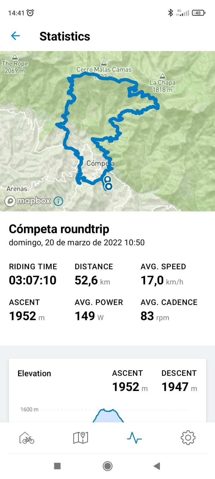

today i've done 30km and 175m elev gain today, 21km/h average speed with 45% battery
Mix road/offroad
was a normal forest underground with nothing special.

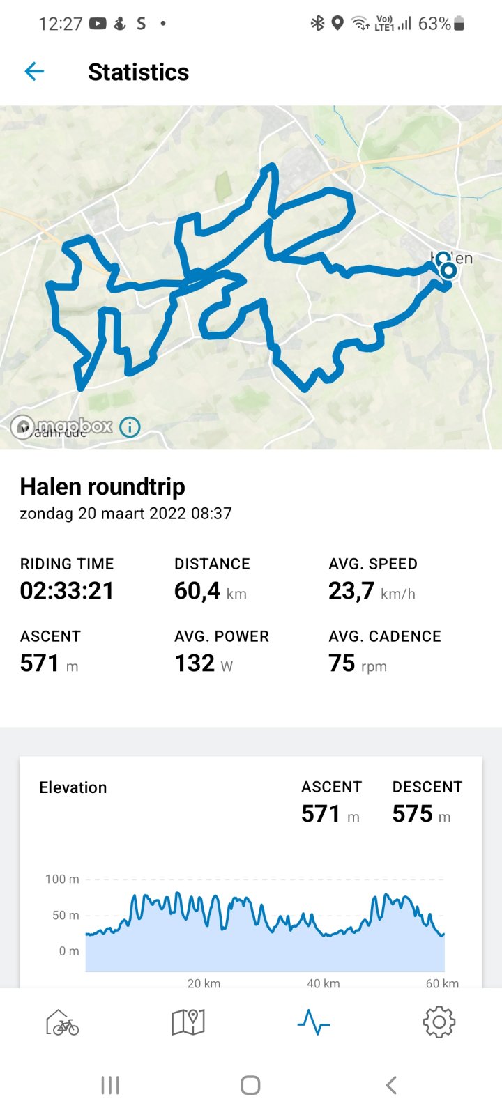

I also did a nice ride today; in order to try to squeeze the battery, it was an endurance ride (zone 2, easy) mostly in EMTB (even small bits in turbo).
I charged to 100% before leaving and came back with 31%, so 69% used; more than 50km and almost 2000m climbed. It would yeld more than 70km and almost 3000m climbed for the full battery; again, an EASY ride. Average HR was 125bpm; less than that and might as well stay home :ROFLMAO:
