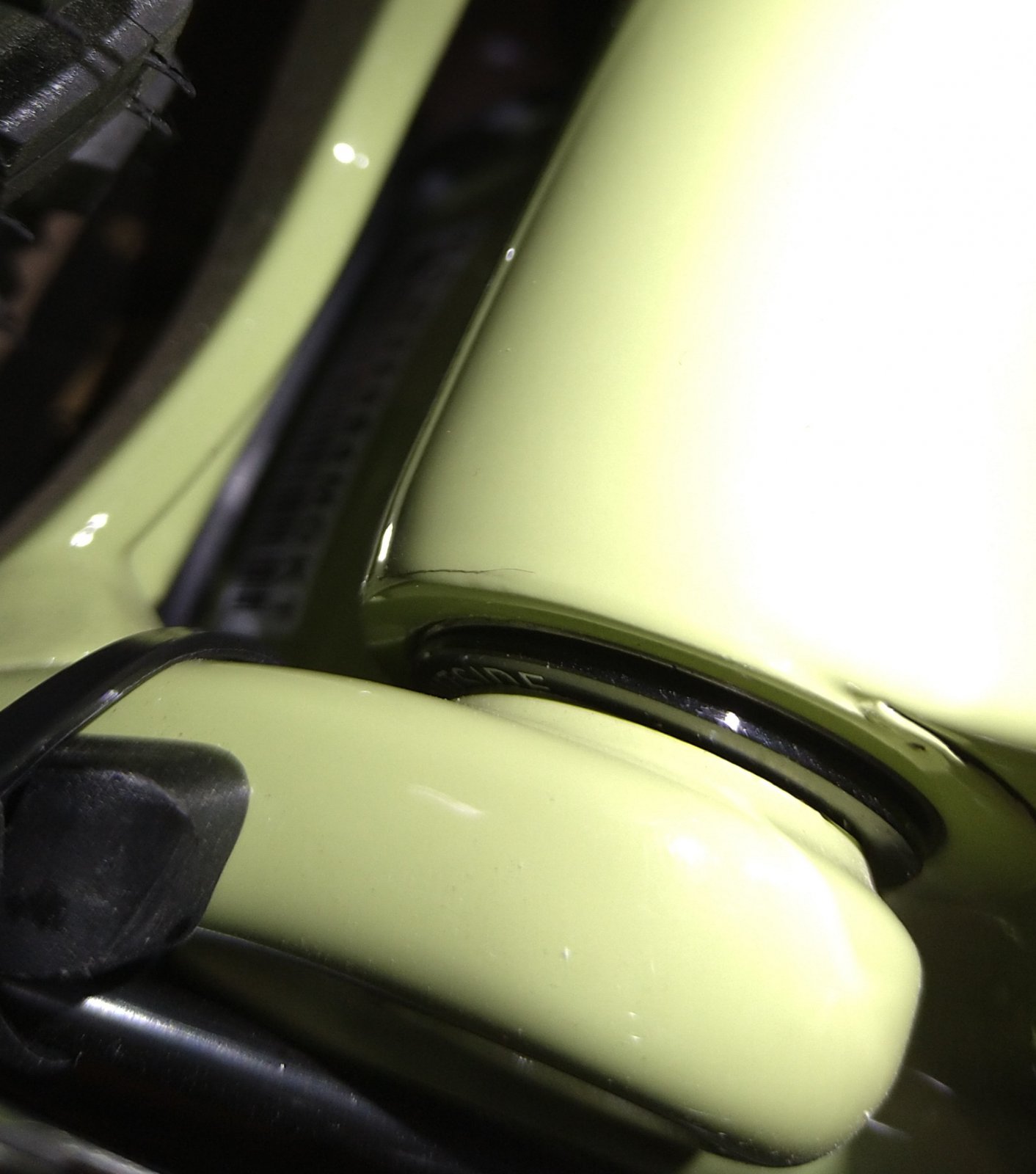

Hello everyone,
Do you have any news ? Warranty applied ?
I bought this model last week and found this during the initial chain cleaning:
The bike has only a few kms for testing, on road around the LBS. So in your opinion is it only a paint manufacturing defect ?
manufacturer defect in my humble opinion. Looks like they painted over it.

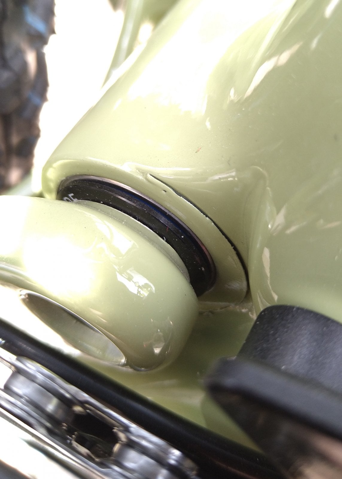

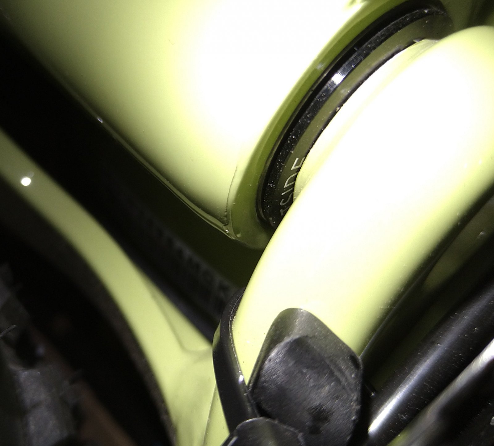

After careful examination I also saw this little crack:
It doesn't give me much confidence, so will go back to the shop tomorrow, but it was the last M size in stock...

I haven't heard any news from Cube yet.My local dealer showed me the email as it was written by the Greek Cube dealer and it was listed as a paint defect.As soon as i have news i will let you know.
Hi,
There is same discussion in german MTB forum and there are same pics and a reply from Cube like this:
Cube Stereo Hybrid HPC SL 625 2021 - Risse Anlenkpunkte Hinterbau
Torsion during driving and different expansion behavior of the materials (bearing seat = aluminum inlay in the carbon frame) can lead to visible, superficial paintwork cracks in the area of the various bearing seats on the main frame (main bearing, rocker arm / seat tube).
No warranty issue.

I doubt the "damage" around the metal inserts is much more than cosmetic but still annoying....and preventable with the right lay up. The edge of a metal insert into carbon is bound to be stressed and it needs layers of UD carbon in a spiral formation to prevent that. Pretty labour intensive and the Cube carbon frames are pretty low cost.
