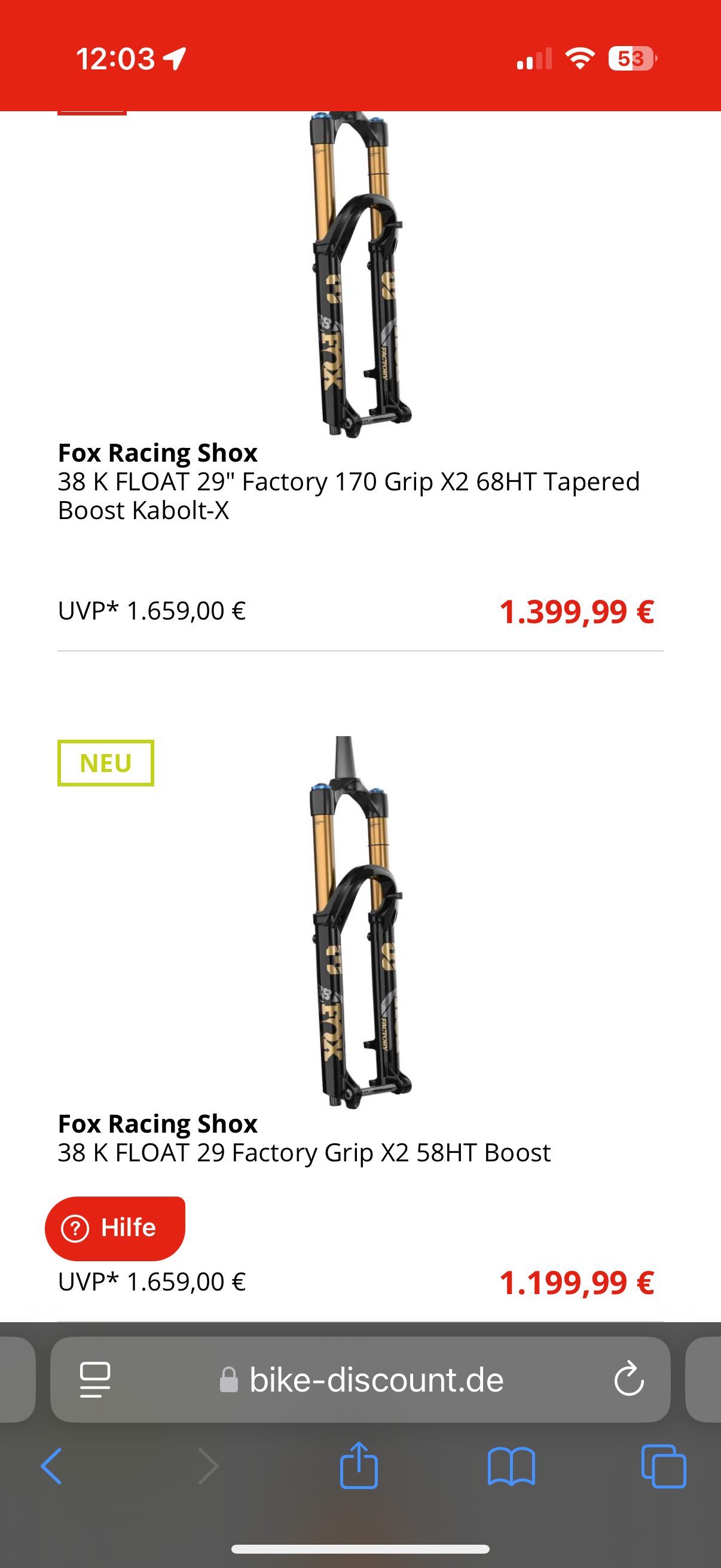

Been on the market for a fork upgrade. Have a Gen3 turbo levo alloy comp s3 and I want to replace the 36 rhythm with a 38 gripx2 fork. I find two versions, 58 and 68 headtube diameter ones.
As it is a respectable amount to invest, I want to avoid getting a fork that will not fit and start a slow return process, and I want to avoid also getting a fork with a weaker crown.
Can anyone help?

I got a levo to but it doesn't matter the diameter you been looking at is head tube bearings diameter and not the diameter of the fork the diameter of the fork is the same on all tapered forks which is 1.1/8 1.1/5 inches and you don't need to care about the bearings because you already have a headset just take out your fork easier to do it nicely if you remove the front wheel first. Then insert your new fork put on all the spacers and the stem make sure it's all the way in as you have no top cap yet then make a mark where to cut. It's better to make it too long than to short 😭 😂 you can use spacers on top of the stem if it's too long and it will fit your next bike which might have a longer head tube. Go back with this information check make sure you are reading only about the fork not your headset and you will get the confidence to buy your new fork it's very simple as you already have a fox fork you don't need to think about anything like torture caps etc the parts you have will fit like hand in a glove.. You're bike will be super awesome

The 68 is for bike frames with a 1.8 inch tapered head tube and the 58is for frames with a 1.5 inch tapered head tube. The 68 fork won’t physically fit into a 1.5 inch frame and you need a new lower headset cup to fit a 58 into a 1.8 (68) frame. The 68 is a new standard adopted by some manufacturers for their E-Bikes to improve frame stiffness but most just stuck with 1.5 as in reality it makes bugger all difference!
Levos have a 1.5 tapered head tube frame so you’ll need the 58 to fit as the 68 won’t and you’ll be sending them back. I’ve just gone the other way as my Giant Reign has a 68 (1.8 inch) head tube and the 38s I got were 1.5 tapered steerer so I had to get a new lower headset cup to make em fit.

Å tapered fork is 1.1/8 on the top of the steerer and 1.1/5down at the crown or bottom of the steerer.. I don't understand this forks I always get the right fork without thinking about that stuff. Just make sure it's not for fat bike's and that it's tapered.. I just bought a new fit grip 36 and you can't choose it was only in tapered tapering from 1.1/5 and into 1.1/8... Anyways to the buyer who are worried about the measurements measurement make sure it's for boost wheelsize if you have boost sizing 110mm and take out your fork and measure it or read the owners manual maybe both then search on YouTube.. All my forks fit on all my bike's I can switch them around from the sensor to the levo or from the exf to the sensor etc etc without measuring anything the all tapering from 1.1/5 and into 1.1/8.. Maybe these forks has different length on the steerer maybe one is for fat bike's i have no clue i been riding emtbs since 2018 (levo) (cube perf) sup exf) and also has a GT sensor the cube has a adapter because it's tapered headtube and straight fork the rest is all tapered tube headsets and steerers and they all fit each other including the new fit grip 36 I just fitted to the exf yesterday.. Anyways when you find out what's the actual difference between these two please tell us. Anyways if both is tapered both will fit your headset. If not it's something new that has just entered the market and if it is it's probably already a YouTube video about it. Good luck 🍀
I just saw your picture again only one of those is tapered.. When it's not mentioned tapering it's not tapered but they should write straight.. The other one says tapered and that's what you need. Tapered ones are thicker at the bottom of the steerer they measured it in mm instead of inches that's all.. They should have wrote it in inches

58HT vs 68HT is answered here;
This is a picture of a 68HT crown fork on a Kenevo Gen1.
Steerer tubes are still 1.1/8 to 1.5, but the crown is bigger/wider to accommodate fatter head tubes on some e-bikes.
For the Gen3 Levo, you want the 58HT unless you want it to look like the Kenevo pictured.
Fox38 58HT
Fox38 68HT
Both same size steerer tube, both will fit the Levo Gen3, but different sized crowns and the 68HT where the crown race fits will stick out further than the Levo head tube.
