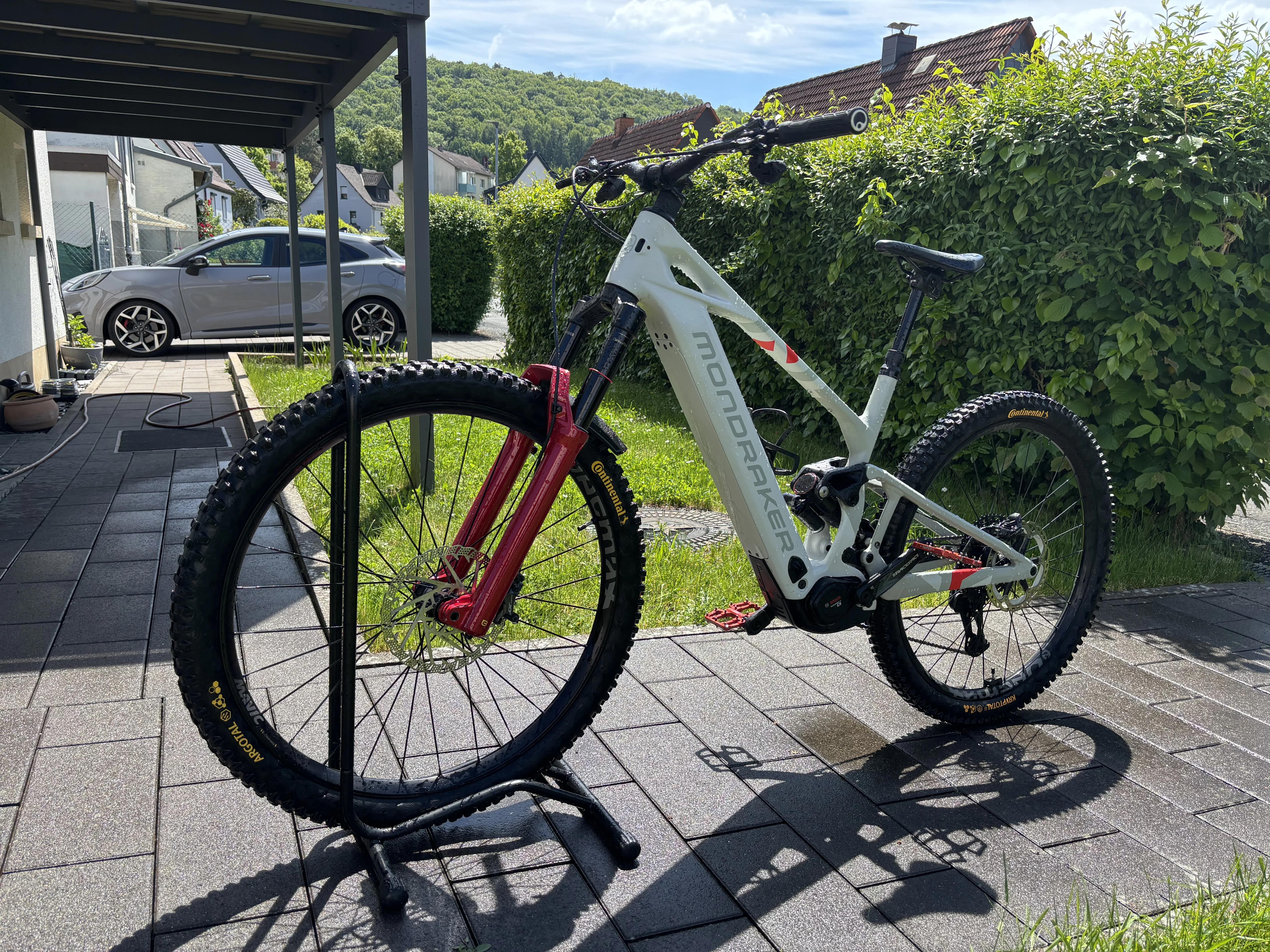

Hi Greg, here are my 2c about this topic: i totally agree with singletrackmind thoughts about improving climbing Performance by changing the Suspension: I am firmly convinced that switching from the fox suspension (Podium/Float X) to the new 2027 RockShox Zeb Ultimate Charger 3.2 (not 3.1, as you mentioned - please update your database😉) and Super Deluxe Ultimate rear shock - which is significantly better than the Float X - would greatly improve the Zendit’s handling.
Since I might be buying a Zendit myself, the RS Suspension Setup would also be my preferred choice. The Podium fork rides really fantastically well, though if only it weren’t so expensive, heavy - and so ugly in combination with the stock Fox mudguard. 🙈
I recently converted my Crafty suspension from fox suspension to RockShox suspension - Zeb Ultimate (3.1 Charger Fork, 2025 Super Deluxe ultimate 2025 with linear XL Can) - and i am super happy with, best Suspension i have ever had🤗
Can’t wait to get the new 2027 Zeb fork with the 3.2 Charger (the Super Deluxe Ultimate 2027 will probably perform very similar to the recent 2025/Linear XL Can Combo) - either on the Zendit or the new Orbea Wild

@AlsbachRyder - fair cop on the Charger 3.2, and thanks for the nudge.
That's now noted.
My earlier post said 3.1; the correct designation for the 2027 Zeb Ultimate is
Charger 3.2.
Apologies for the noise.
On the substance: you make a reasonable case, and your experience converting your Crafty to the Zeb Ultimate + Super Deluxe Ultimate (LinearXL Can) combo is useful real-world data for anyone considering the same route on a Zendit.
Where I'd gently push back is on climbing specifically.
The Super Deluxe Ultimate's threshold lever is a genuine functional upgrade over a Float X without a climb switch - that part holds up.
But the Zeb vs Podium swap won't move the needle on climbs in any meaningful way; the Zendit's climbing ability is baked into its geometry and the M2S's 130Nm sustained / 150Nm Boost delivery, not the fork.
Descending and overall feel? Yes - the RS combo you're describing is a credible and well-regarded alternative to the stock Fox setup, and the Podium's weight and cost are legitimate arguments against it.
On the Orbea Wild 185284 - I can see you're eyeing that as a potential alternative.
Worth a separate thread if you want to dig into how it stacks up against the Zendit; the motor is a different proposition entirely (Bosch CX Gen 5, 120Nm vs the M2S's 150Nm peak) so they're not direct rivals in feel.
